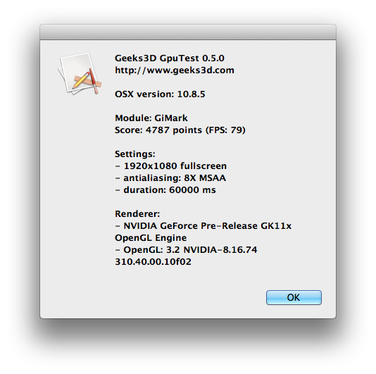

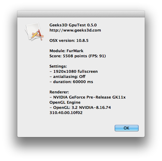

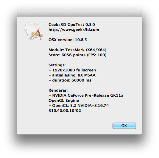

Here are some benchmark results (lots of images...have fun scrolling):

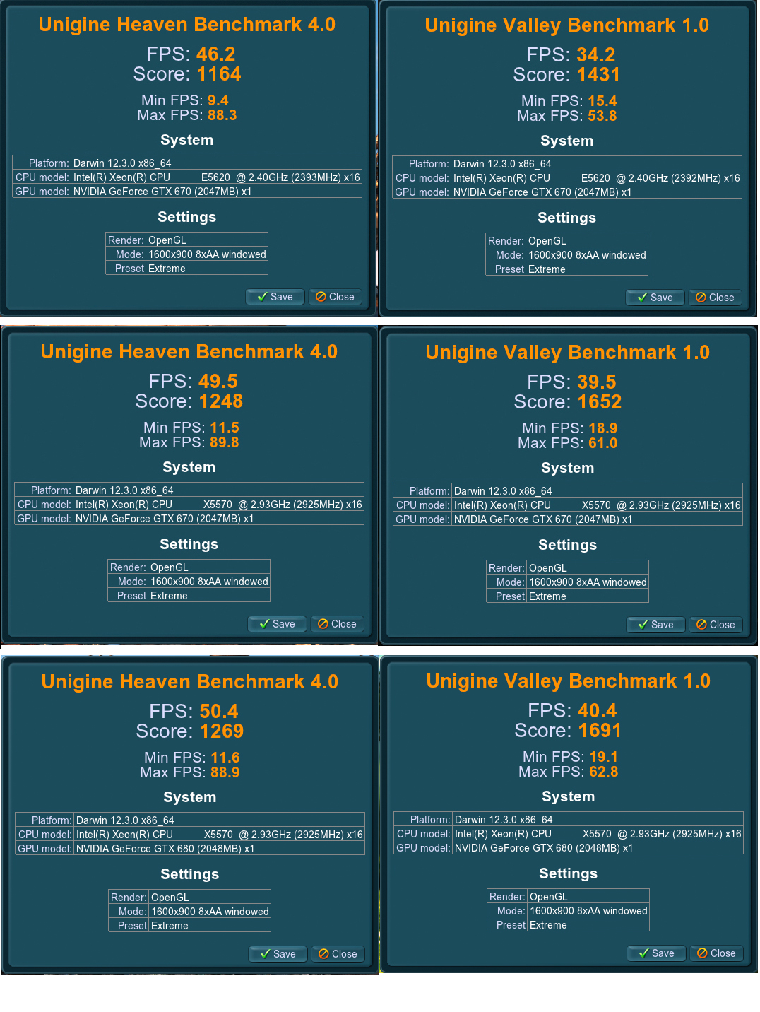

I would say that the 2.40GHz CPUs are your problem. They are your bottleneck. A GTX 780 with 2.40GHz is wasted for gaming.
Look at the attached image and see how going from 2.40GHz to 2.93GHz provided a huge boost in performance. But going from GTX 670 to GTX 680 showed a much modest improvement. In this instance, I need faster CPUs to fully realize the potential of my GTX 680. As it stands now, some of its potential is wasted.
This is one of the reasons I'm in no hurry to move to GK110 from my GK104.

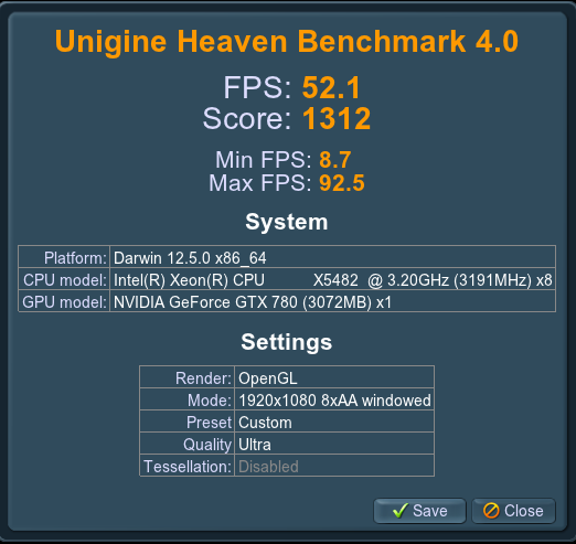

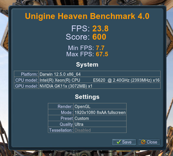

Thanks Lou. I wanted to stay on internal power without doing the MVC mod (I don't care about the boot screen right now), so I stuck with the stock 780 just to be sure. I re-ran the Heaven benchmark with 2xaa to match your test, but my monitors are 1920x1080, so I can't quite match your resolution (not sure what your tessellation settings were either - mine was Extreme). At those settings it scored 1599 at 63.5fps. Your CPU is significantly faster than mine. If yours was running overclocked during the test, the cards probably match up fairly closely. Good to know.

In any case, your Heaven score is awful.
I just ran it in 10.8.5 on a 3,1 and got DOUBLE your score.
Please note that whatever you set Tesselation at in 10.8.5 it won't work since it isn't supported until 10.9.

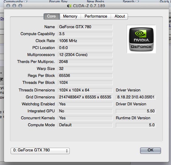

Can you run CUDA-Z and see if you are getting PCIE 2.0 speeds?
But please let us know how you are powering it, it seems that the card is throttled in some way.

I still feel the 2.40GHz is severely hobbling him.
Yep, that's all about. Heaven is gaming engine benchmark thus it reflects how games use hardware resources. High CPU clock is important almost that much as decent graphics card. All scores above are confirming that. What makes this benchmark a little useless TBH.

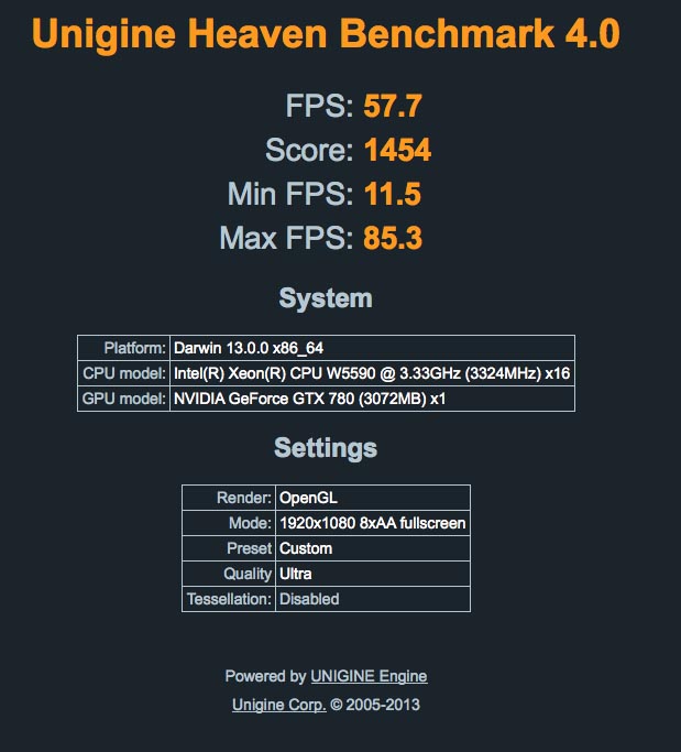

3.33 using 6 cores...Pretty slow...It could be that the system is thermal throttling...causing a loss of performance too..I'm guessing you do have BOTH power connectors attached?

My MacVidCards modified Gigabyte GTX780 is an OC Gigabyte card. And when MacVidCards modified it, he did not lower the Clock. My card runs at 954/1006 GHz. Cuda-Z shows it running at 1006GHz.
Lou

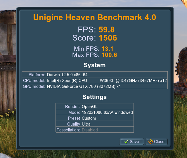

Notice how jetjaguar's results are better than flowrider's? The only primary difference is his 3.47GHz vs. flowrider's 3.33GHz. 140MHz was enough to knock 5 fps average and 20.3 fps on max fps off the score. Acceleroto is only at 2.40GHz...

That's because he's pre-flashed it and it's set up correctly...It's where we will be getting our new card when funds allow...Super helpful guy, and a member here too I believe
