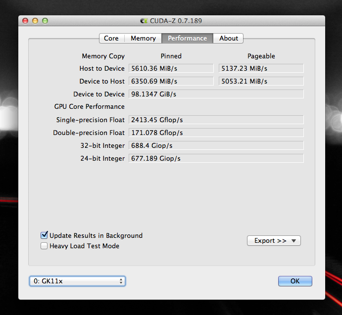

here is my cuda-z

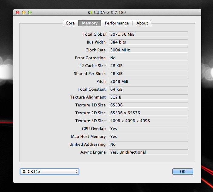

If we go strictly by Cuda-Z scores, Acceleroto's card is running fine. As a matter of fact, a tad faster than jetjaguar's. I'm assuming jetjaguar has other processes running when he does these benchmarks because he and Acceleroto has GTX 780s that are clocked exactly the same. This combined with flowrider's card being overclocked could explain the Heaven scores.
Since Acceleroto's Cuda-Z and Furmark numbers align with other GTX 780s, there's no reason to assume it is the culprit for low FPS in his games. That leaves only one other major factor that could be the cause of the low FPS, the CPU...
We have also successfully proven that CPU does not matter when it comes to Cuda utilization.

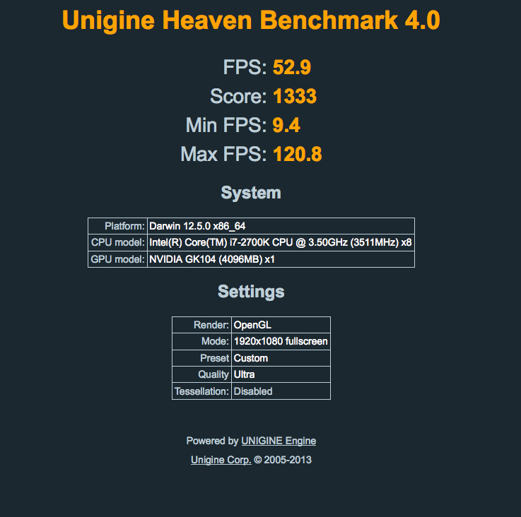

Last night I reinstalled all the web drivers I could find. I did a Heaven benchmark on Ultra/8xAA/1920x1080 and got a 1500+ score -- way better than my 600 from before. I'll run some more tests tonight to see if anything else changed. Hmmmm.
Cool! I guess your problems are solved.
I sure hope so. I was able to get Guild Wars to play at 60fps by turning the reflections off & setting things to native/medium. That's the fastest I've seen GW2 on my machine.
I'm holding off on installing Mavericks because I'm right in the middle of developing a new game. Once a few more people work out any Mavericks/Unity hiccups, I'll migrate upgrade to get OpenCL working too.
More tonight. Thanks!

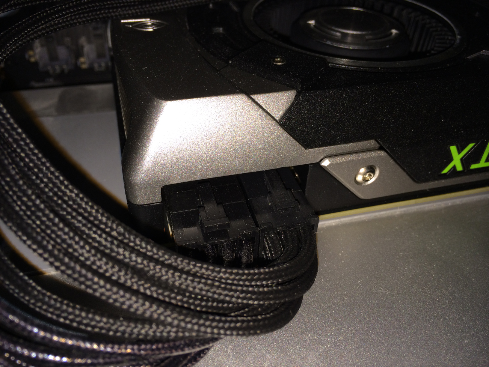

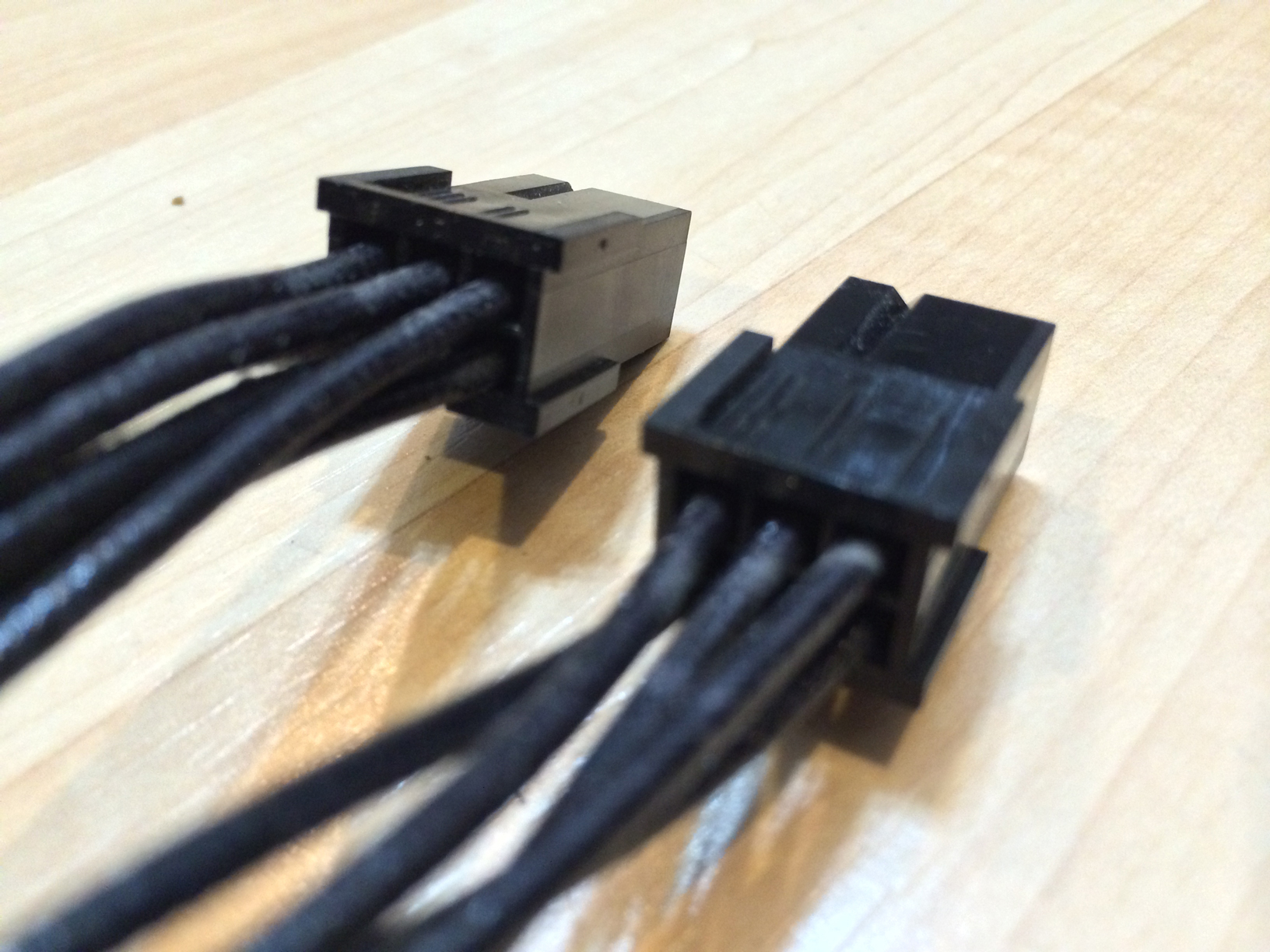

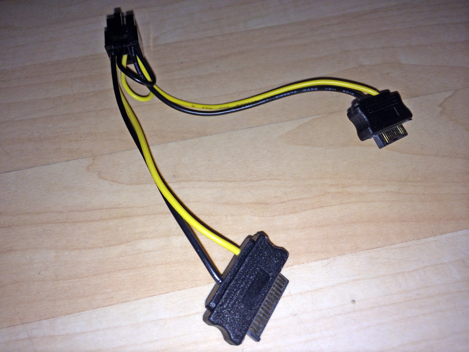

Here are photos of the 2xSATA to 6-pin adapter.
I'm using a 6-pin extension to reach from this adapter to the card.

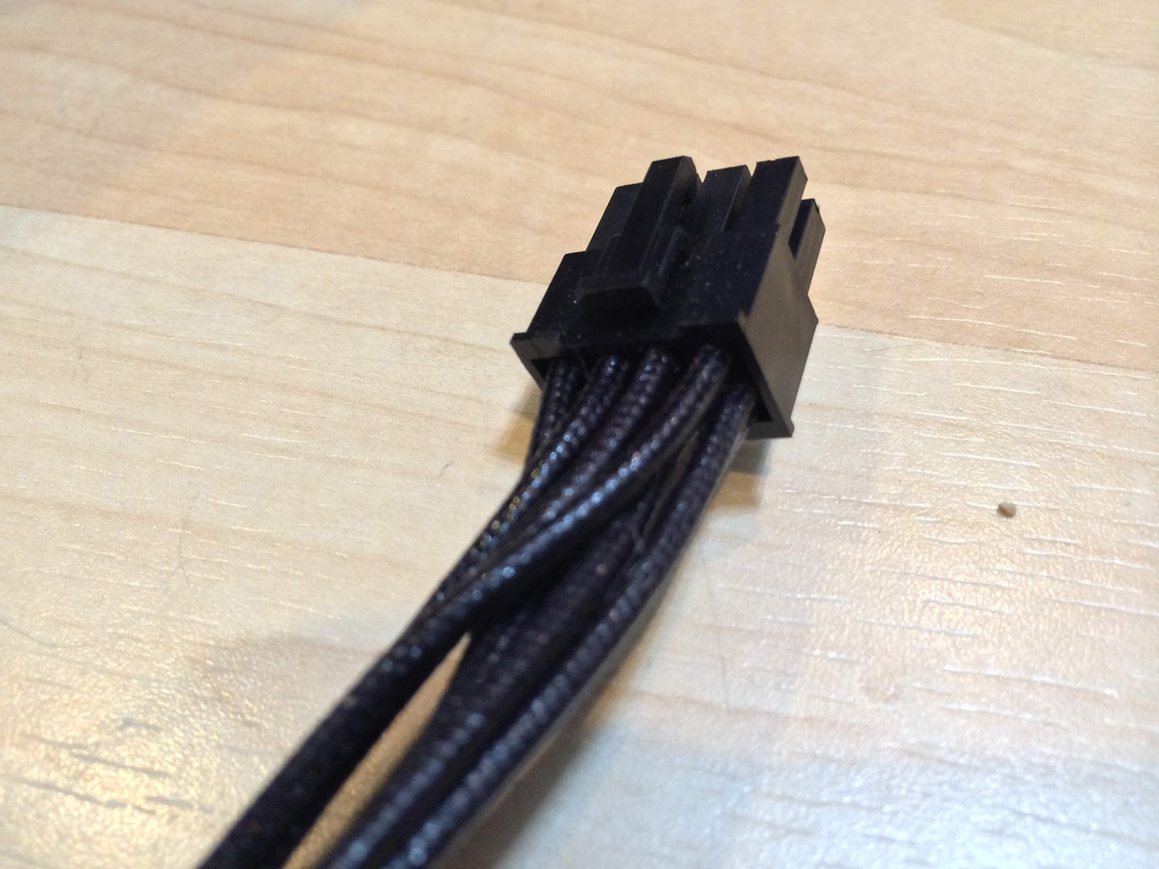

Here are photos of the 2x6-pin to 8-pin adapter.
Thanks!

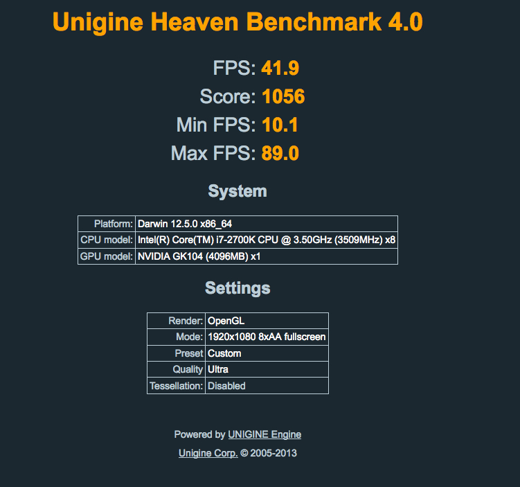

For comparison here is a Palit GTX770 4Gb Jetstream in an i7 Hackintosh, the 8xAA really hits it hard.
I would turn it down in games if you are struggling:

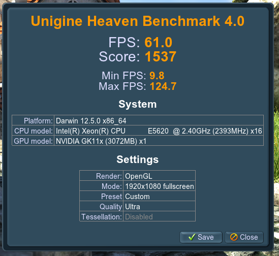

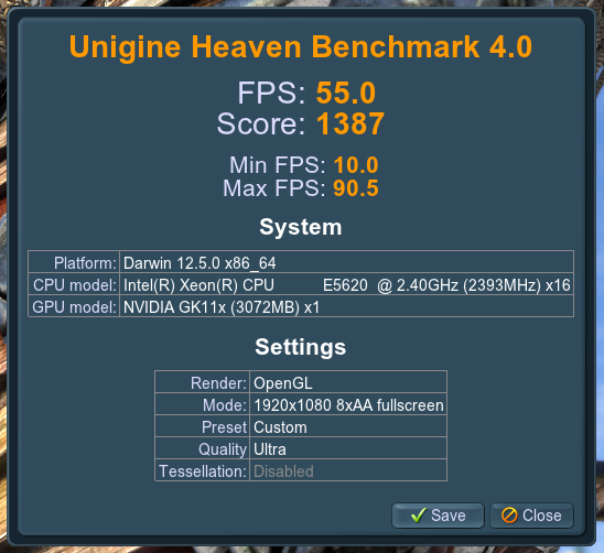

Alright, I just did some more Heaven benchmarks and they're looking good now. I did some more Guild Wars 2 tests and can get it to run at 50-60fps with reflections off & medium settings. Borderlands 2 runs at 30fps when there's lots going on, but typically 45-60fps when just cruising around. That's with FXAA on, but most other things set near the medium/normal settings.
I still don't understand why it was running slower before. I always check to make sure I didn't have anything else running (well, anything big -- I don't clean out system-level things), so I don't expect any differences there. Who knows though. Maybe loose power somewhere?
So, overall, I'm definitely happy with those results. I still want to understand what was going on. If anyone sees any power issues and would like to shed some light, I'm all ears.
Thanks!!

I can't speak for exactly what he did but the cards he got were modded same as yours.
Using an 8 pin adapter will in most cases disproportionately place load on 2 of the grounds. My mod equalizes load over the 3 available pins.
MacVidCards, can you please reply to my pm. ive sent you 4 over the last two days, but i still have not heard from you!!!
Note on 6 to 8 adapters
Here is what people using adapters need to think about. FOLLOW THE WIRES. If only 2 wires are actually being used to power 4 pins, you have actually INCREASED THE LOAD on the traces and left one totally idle.
