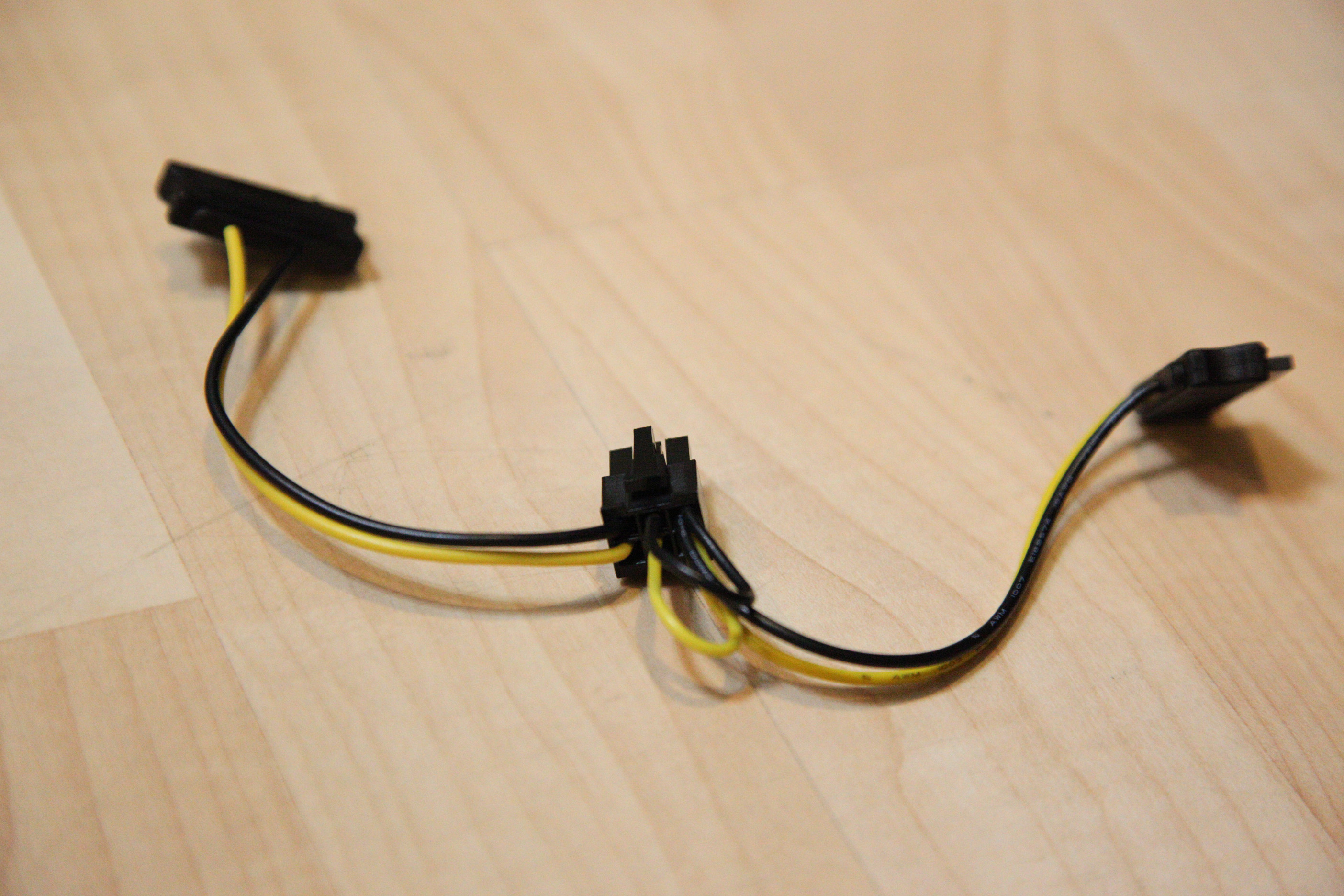

Here are photos of the 2xSATA to 6-pin adapter.
I'm using a 6-pin extension to reach from this adapter to the card.
If you flip over the connectors in the top left photo, you will see that there are only 2 wires connected to ground side.
Those 2 wires lead only to the sense pins that turn on card. So instead of 4 total pins with ground, only 2 would be connected to anything.
So if that connector was only one plugged in, the 8 pin plug would "think" all was fine but card would be starved for power. Perhaps this is what happened when you got those half speed results.
The fact that this plug is included with PC cards and when plugged in this way in a Mac Pro leads to double current being pulled from just 2 pins while 2nd 6 pin only gets normal load makes these plugs especially dangerous for Mac users with PC cards.

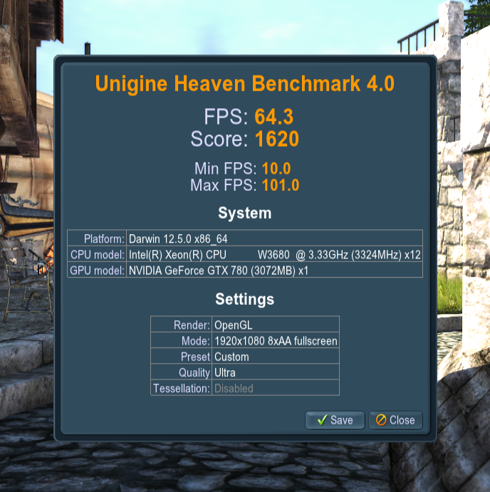

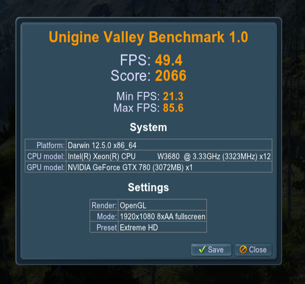

First benchmark results!
Dude, nice! Go, Titan!
I definitely see your point. I attached a photo of the 2x SATA to 6-pin adapter I'm using. It has one of the SATA plugs connected to 2 of the pins and the other SATA plug connected to the remaining 4. All 6 pins are wired, but if one of the SATA plugs wasn't seated correctly, it'd definitely cause issues.
The SATA plugs themselves don't actually stay seated well at all, so it would have been easy to bump one loose when routing the wires of even closing the case.
The 2x 6-pin to 8-pin adapter that came with the card actually has wires connected to every one of the pins in all 3 of the connectors. It looks like it's designed to share the load equally between both of the 6-pin connectors. Likewise, however, if one of the 6-pin connectors wasn't seated correctly, it'd be bad.
I believe the 8-pin adapter is fine, but I'm not happy with the 2x SATA to 6-pin adapter. I'll do some looking for a better solution. Overall, however, using the stock 2x6-pin plugs and 2x SATA plugs to power the GTX 780 seems like plenty power. (That is, if the 2x SATA ends actually draw power from all 3 of the 12V pins.)
