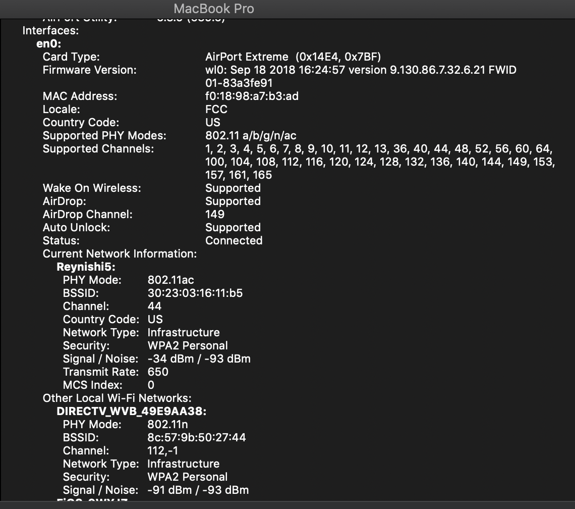

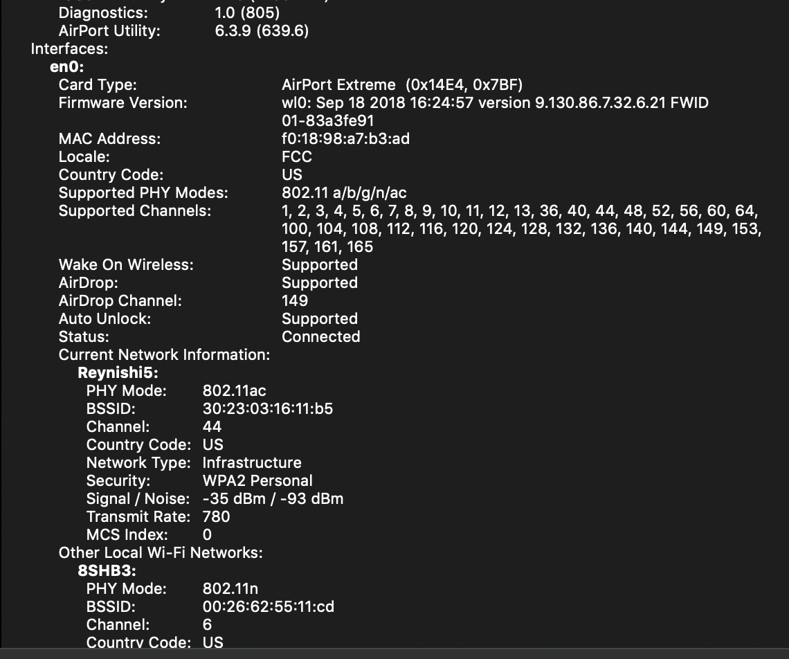

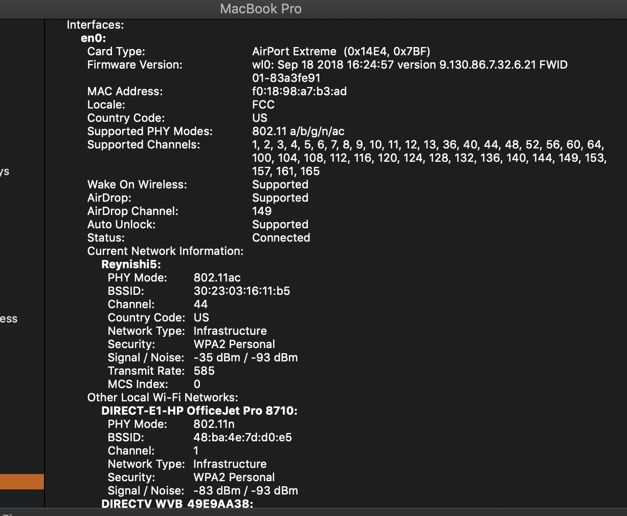

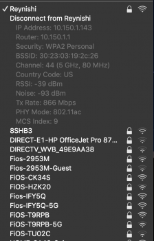

Please post the details from the opt-click on the wifi icon.
I’m not a fan of mesh systems at all, but I would expect the MBPro to keep up with the iPhone for speed.
This is after the split

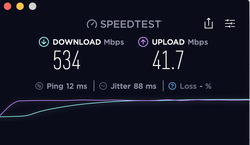

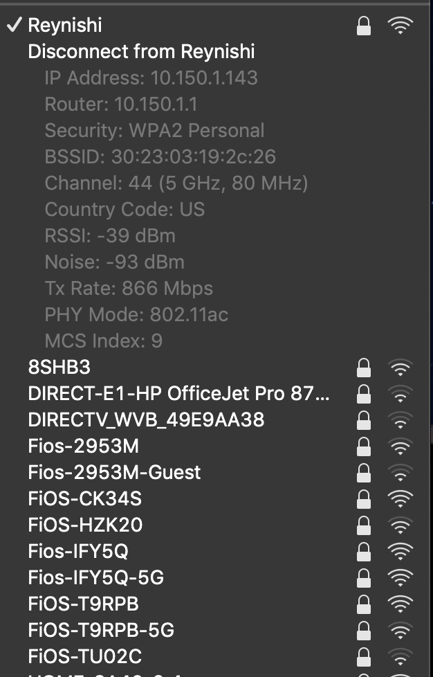

866 is one of the highest you can get...yep, defiantly looks fixed vs the 54 that you have. Just keep it named separately & you'll be fine. A little research & you'll learn that those of us who split it & don't make it easy have better network performance.
Thanks. It’s only using 2 antennas to connect. That might be ok, depending on the configuration, but it’s not ideal. Regardless, if that’s correct, based on the configuration, I’m surprised the iPhone is getting such high scores.
For the avoidance of all doubt, if right now you turn off the other velop devices in the mesh so only one is turned on, and then restart the MBPro, then restart the performance test on the MBPro, then the iPhone, then the MBPro again, you still get the same results? Around 600 up/down on the iPhone and 270/140 on the MBPro, while you have both in front of you? Just looking to see how consistent that is.

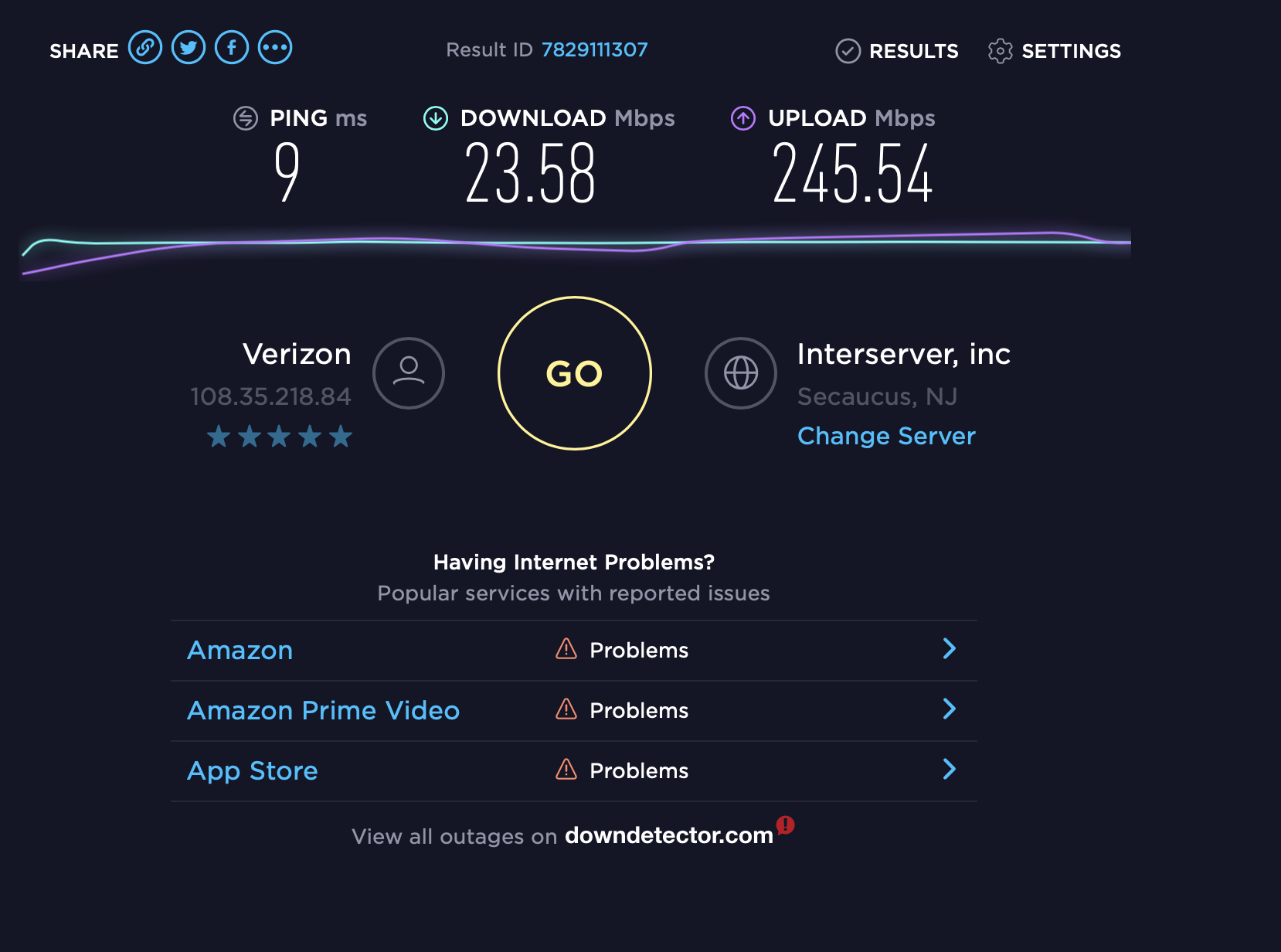

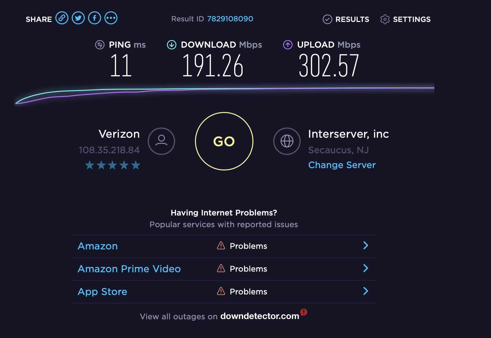

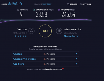

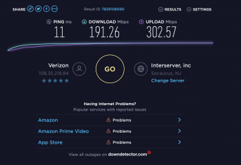

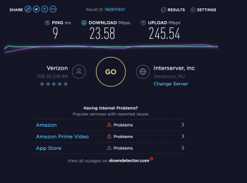

Iphone is getting around the same as before and the MBPro is fluctuating between 250 and 270. I am so frustrated, Any recommendations on a new mesh? I heard good things about Google mesh. Since I have weekly chemotherapy, I am working from home, Therefore, I need a reliable download and upload.

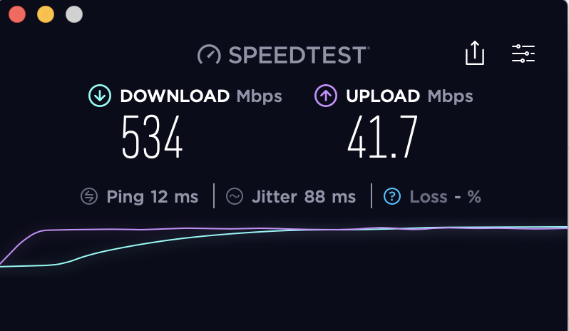

I have a 2018 MacBook Pro, and Google WiFi mesh with a Comcast gigabit ISP connection. I just ran this. Google is reliable, but not the very fastest IMHO - I am happy with it though as it is consistent and overcomes dead zones in the house. If I connect this MacBook Pro by ethernet to the cable modem, I get 900 Mbps or so download. The speed demon from what I have seen is the Netgear Nighthawk XR700, although watch out for the Asus ROG Rapture GT-AX11000 which is coming soon.
From my 2018 MBVP - this is pretty good and more than ample for anything, with WiFi.

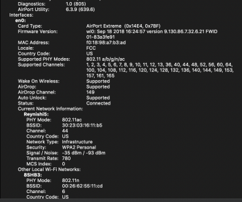

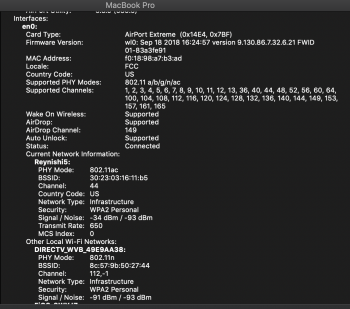

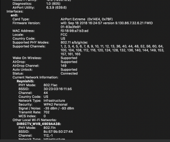

Here are the transmit rates standing three feet from the second node. I have taken this photos every 10 seconds. As you can see the numbers are so volatile.

Keep in mind you should only get half of what your transmit rate is on your device. This is caused by a lot of real world scenario stuff. You should be getting between 250 & 350 & your transmit rate.
