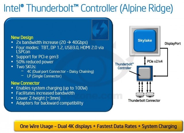

But TB2 was done in the late 2013 Mac Pro -
by integrating 3x Intel Falcon Ridge Thunderbolt 2 controllers (each driving 2 TB2 ports each).
Would't we just need Intel to release TB3 Alpine Ridge controllers?
How do you drive three Alpine Ridge controllers ( x4 PCIe v3 each ) with just x8 PCIe lanes ? In short Alpine Ridge requires new inputs also. If don't have the new minimal required infrastructure just having the controller doesn't do much.
If Apple wants to stick with three then they will need a 'new' source of added PCIe bandwidth. That would come in the form of new CPU package and/or I/O chipset.
Either the CPU package can move to PCIe v4.0 and a new PCIe switch could use x8 v4.0 lanes to cover 4 x4 v3.0 lanes or the lane count on the CPU package goes up another 4. Neither one of those are happening before 2016.
Same issue with the rest of Mac line up. There is no large block of unused PCIe lanes to which to connect the Alpine Ridge controller until the IO chipsets are upgraded to to supply the additional bandwidth.
If Apple plateaued bandwidth then they could backtrack from three TB controllers back down to just 2 ( 4 ports). The C610 chipset supports 6 USB 3.0 ports. Apple could go with a 2 USB Type C ports that were USB 3.0 + Alternate Mode Display port, 4 regular USB 3.0 ports ( so didn't need dongles for everything), and just 4 Thunderbolt ports. The system can still could drive 6 directly connected displays.but backtracking a bit from Thunderbolt.

DisplayPort 1.3 won't be enough for a 5k Cinema Display. They'll be needing Thunderbolt 3.

If Apple is going to hook Mac Pro updates to Thunderbolt updates then someone in Cupertino is drinking a ton of "reality distortion field" kool-aid. Thunderbolt's update cycle is 2-2.5 years long and is completely unaligned with both the GPU and CPU update cycles. To design a workstation system soley and primarily around a i/O support chip is wandering into bozo land.
If the Mac Pro had just one TB v2 controller than perhaps it would be more dire situation to upgrade as quickly as possible to TB v3. It has three. If they want to keep three then they will have to wait for the infrastructure to support three to come. It isn't coming any time soon for workstation class systems.
Sure it will, DP 1.3 can do 5K. Not clear what the connector situation is though. If it's possible to run DP 1.3 at the current mini-DP form factor, we might see that Apple does something with it in advance of TB3.
Yes, but the Mac Pro doesn't use mDP as a port, it uses Thunderbolt. And Thunderbolt controllers are not currently compatible with a DP 1.3 source until you get to Thunderbolt 3.
There just isn't enough bandwidth on the controllers to carry a DP 1.3 signal.

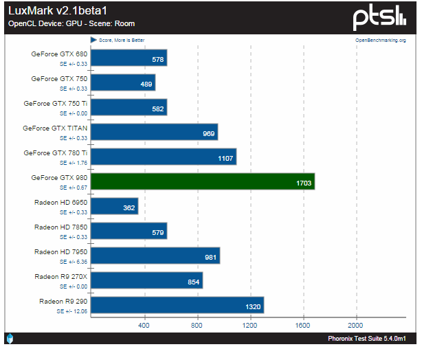

No, it doesnt. GM204 is biggest marketing gimmick I have seen in my whole life.
Yes it does OpenCL good, but not as good as AMD GPUs. When it has to do it, unless there is a TDP cap in BIOS is SUCKS power as hell. It uses only 35W less than R9 290X. If you have a TDP cap it will not use more than 180W, but... will be MUCH slower, cause of nacked TURBO state of GPU. They sip electricity only on average. Peak and max power draw are the ones to look.
Funniest part, AMD in their marketing materials show max TDP of their cards. Nvidia for Maxwell shown average, and that is the difference, that people dont see.
I wonder what will happen, when R9 380X will be made on 20 nm process, and will draw around 200W, and give 7-8 Tflops? 😉 So far, ChipHell slides show that TDP of FijiXT should be around 200W.
Secondly, why would Apple use CUDA, if Mantle in future will be much more than CUDA is? Mantle will replace DX, OpenCL, OpenGL, and CUDA. And it will be one simple platform.
I really sugest to read carefully reviews on sites, and start paying attention to tech forums, not only Macrumors.

Overall, while NVIDIA can’t win every compute benchmark here, the fact that they are winning so many and by so much – and otherwise not terribly losing the rest – shows that NVIDIA and GM204 have corrected the earlier compute deficiencies in GK104. As an x04 part GM204 may still be first and foremost consumer graphics, but if it’s faced with a compute workload most of the time it’s going to be able to power on through it just as well as it does with games and other graphical workloads.
http://anandtech.com/show/8526/nvidia-geforce-gtx-980-review/20

About the performance - I have already said what I have seen on reviews, and on user experience from using those cards.
http://www.tomshardware.com/reviews/nvidia-geforce-gtx-980-970-maxwell,3941-12.html
Windforce does not have TDP cap - it draws almost 300W in GPGPU constantly. Reference does have TDP cap, but also it has way lower TURBO state clocks. Thats why it draws only around 180W of power.
Imagine now. 280W TDP Windforce GTX980 delivers 5Tflops of power. AMD releases 200W with 8Tflops version of their GPU as a reference and it blows away not only the 180W chip but also 280W version of GTX980.
TB v3 doesn't particularly solve the DP 1.3 problem. TB v3 still only deals with DP 1.2. Note the DisplayPort version in leaked Intel's slide:
http://arstechnica.com/gadgets/2014...olt-doubles-speeds-but-changes-the-connector/
To get to DP 1.3 sooner rather than later Apple would have to get 'raw' DP 1.3 signal out to the connector. It is unlikely Apple will go to a display port only connector. Just look at the trends on the other Macs ( especially the new MBA 12" one with just a single "kitchen sink" do-everything port ). There are no Mac now that have a display only output besides the HDMI variants on two. ( and that isn't bleeding standards compliant edge either).
Apple could go USB Type C if they can find a DP 1.3 USB 3.0 switch to put behind the connector and the DP "Alternate Mode" also covers DP 1.3 signaling. It would also be consistent if Apple is going to slap Type C connectors on all new Macs ( which wouldn't be surprising).
TB v3 controller may pragmatically be a pre-built USB Type C Alternate mode backing switch. The "Four Modes" , 100W power , and lower z height, suggests that will be the case. To keep costs reasonable though it is unlikely it will be the super duper does everything at the most bleeding levels switch. A TB controller is probably going to be skewed to just be top end TB in support. The others will be the more mature ( and easier to implement because all the kinks have been worked out elsewhere) stuff. When TB came out it supported DP 1.1 and PCIe v2 which were not the bleeding edge at that point.
However, for a 2015 product though, the stumbling block is can acquire a GPU that actually outputs DP 1.3 while designing building a custom GPU card (have to license the reference design) , write OS X custom drivers ( OS X driver availability trails Windows/Linux as smaller market ) , and get access to the volume needed for their production.
AMD released the Tonga based W7100 in August 2014. It wouldn't be surprising to see Apple's customized version of that drop in Feb-March 2014 ( trailing by about 6 months). The driver work gets a modest priority bump since similar tweaks needed for the M295X in Retina iMac also (and can protoype off of standard stuff in AMD's pipeline; e.g., earlier reference boards for mainstream products).
Apple releasing a Mac Pro GPU cards that are bleeding edge of AMD ( or Nvidia) would be a huge departure from what Apple has done over last 5-8 years. Throw Apple custom board & connector designs on top of that and it is just more unlikely.
The Pirate Island 380X stuff is just likely too late to make a 2015 Mac Pro given the additional logistical overhead a Mac Pro GPU card adds.
That's true. I'm assuming TBv3 will be changed to use DP 1.3, because if it isn't, we really all are truly screwed.
I don't know exactly what Apple is planning with USB type C. I can't believe they'd abandon Thunderbolt. Maybe like you suggest they could get it to switch to DP. Maybe another option is that Thunderbolt gets some sort of bypass that when you plug in a DP display directly, it bypasses the Thunderbolt controller.
I'm pretty sure what will happen is TBv3 will get support for DP 1.3 though.
