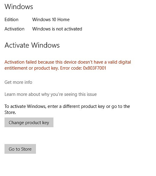

Well this sucks, my Parallels VM of Windows 10 has deactivated. My Boot Camp volume is fine.
I'm leaning toward the November Update being the culprit.
Try going back and forth between them, activating each time ... it may recover. Also, it sometimes takes a few tries, or some time to reach the Microsoft activation servers ... they may be really busy
Reactions: ActionableMango
I assume you are using your VM with your BootCamp installation. Go back to the bootable version and check your activation there ... you may have to re-activate at this time. Then, return to OS X and your VM and try to activate again. I usually end up with another button "Activate" on that screen, and sometimes it takes several tries for success, or I have to give it some time and then try again.
Once your hardware is registered with the Microsoft Activation Servers, you should be able to re-activate either instance at any time (subject to server availability). Sometimes a few attempts are required.
I just now finished creating a new Fusion VM for my BootCamp as the one I was using developed some problems (such as not being able to open the Windows Explorer application). Took a couple of tries to activate including a reboot to BootCamp, but it is again activated and appears to be running fine.
Good luck with yours ...
Reactions: howiest
The error I posted above in #335 is persisting. MS made changes to authentication in the November update where it is possible to install Windows 10 directly and activate it by entering a Windows 7 or 8.1 key. That seems to have changed the game somewhat for virtual installations.
I currently have 2 choices... change the product key, or, buy a licence. I'm reluctant to change the product key because I don't want to mess with my activated Boot Camp volume which is running well.
These activation issues are alive and well on the Parallels forum.
Yeah ... there is another member here having the same issue with Parallels VM activation using the BootCamp installation. From the little I have read here, it seems that VMware Fusion has somehow solved the issue with Windows 10, whereas Parallels has a problem. Hopefully Parallels will release a fix for the users (I should probably carefully read the full license agreement before getting too carried away with that thought ... it may be specifically addressed there).
Windows Activation has been a problem with VM software for many years, ever since the feature to use the bootcamp installation as the VM was introduced. The problem is that Microsoft activation makes a hardware fingerprint of the computer and ties that to the activation. The hardware fingerprint is almost completely different when Windows fires up again in the VM, so activation is lost. The fix has always been to just push through and reactivate multiple times when you boot one way or another until Microsoft activation is satisfied and working on both.
Honestly, I don't see how this is a bug that VMWare could have fixed on their own. I think any fix would have to be a collaborative effort with Microsoft.
The original solution was to create a new, temporary VM and do the whole 7->10 upgrade process on it, which would register the VM "hardware" with MS's activation servers and thus stay activated in both environments. The temp VM could then be deleted after. Not sure if that changed with the 10586 build. There are a few guides on Reddit for this trick.
I can tell you that buying an OEM product key fixes all these headaches and lets you do the internet + phone dual activation trick if you don't mind coughing up $120. The peace of mind and time + frustration saved was worth it to me.
Reactions: m4v3r1ck
I dunno, I think I'd rather invest that $120.00 into a PC gaming rig or console (since 90% of my Boot Camp use is for gaming), and just kiss Boot Camp farewell.
But who knows, maybe Parallels will find a solution. 🙄
I do regret the November Update though. Everything was working fine before that "new" digital entitlement procedure was introduced by MS.
