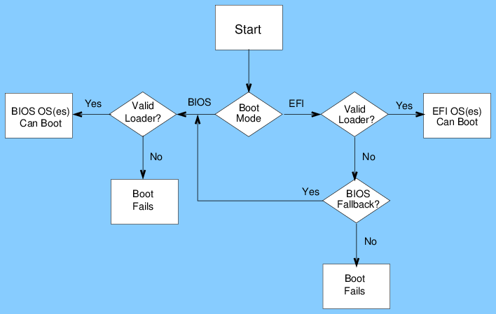

This is a really interesting problem for me because I've installed Windows 8.1 EFI twice now, clean installations to wiped SSDs both times. The first installation was gravy and all boot/reboot methods worked great. Verified EFI installation.
The second I did the same using the same process from the same install media on the same computer, only just a larger/different SSD. Verified EFI installation and everything is working fine, except for the boot methods you mentioned. If there is something I did differently, I don't know what it is.
Basically, in the chart below from Rod's Books, the Mac is going left at the first diamond instead of right. Then it doesn't find a boot loader so it fails. But for some reason if you/I hold down ALT/OPTION then the Mac does figure out that the Windows drive is an EFI boot and boots it correctly.
From http://www.rodsbooks.com/efi-bootloaders/csm-good-bad-ugly.html
He explains it pretty well in the first bullet point after the figure.
It looks like boot behaviour follows the map randomly so sometimes it goes right and sometimes wrong. Maybe Mac EFI is confusing to Windows especially less than version 2.0 which isn't supposed to work anyway
