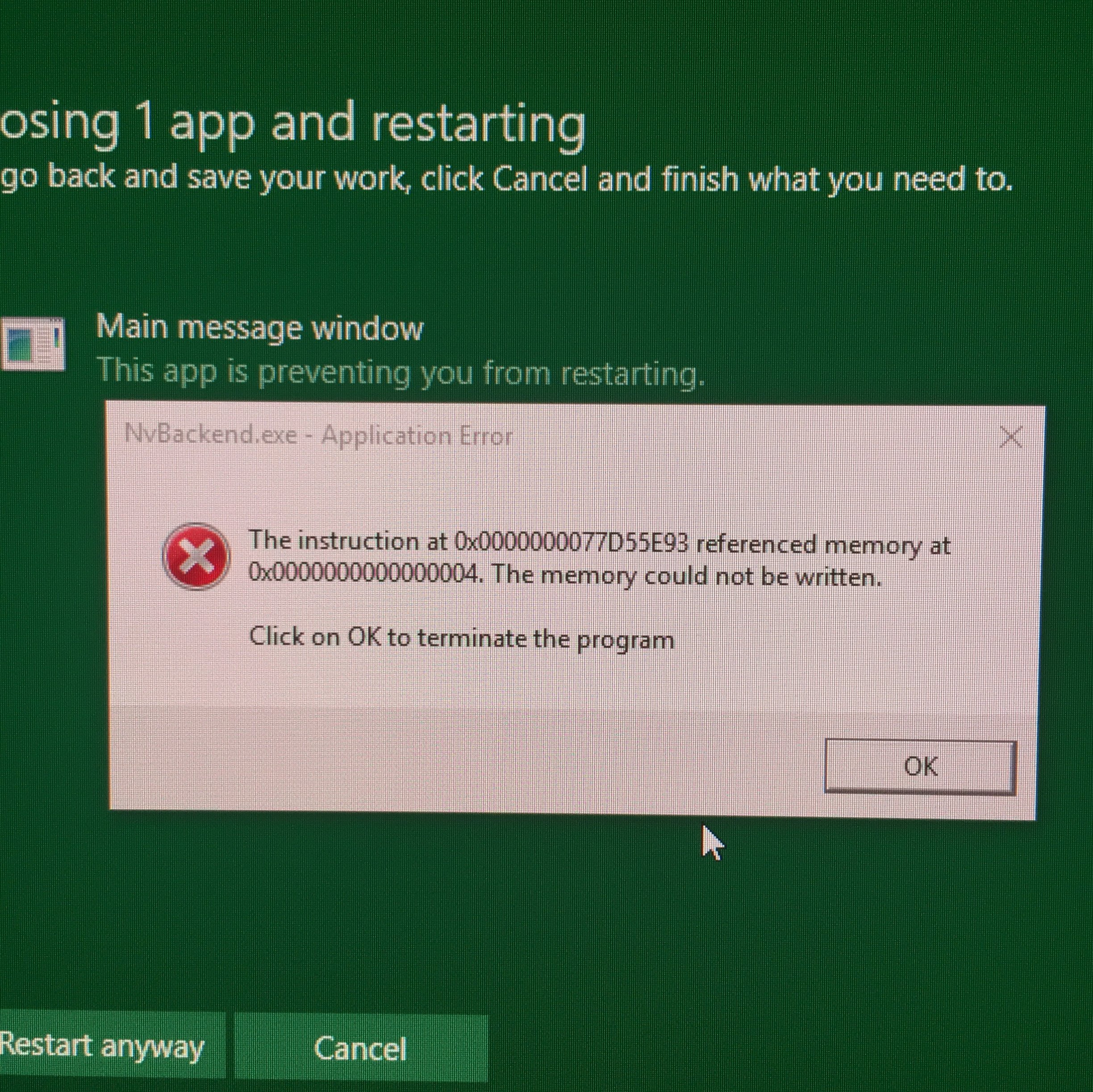

If you ever get this nice message when restarting or shutting down it means the Nvidia drivers need to be reinstalled.
