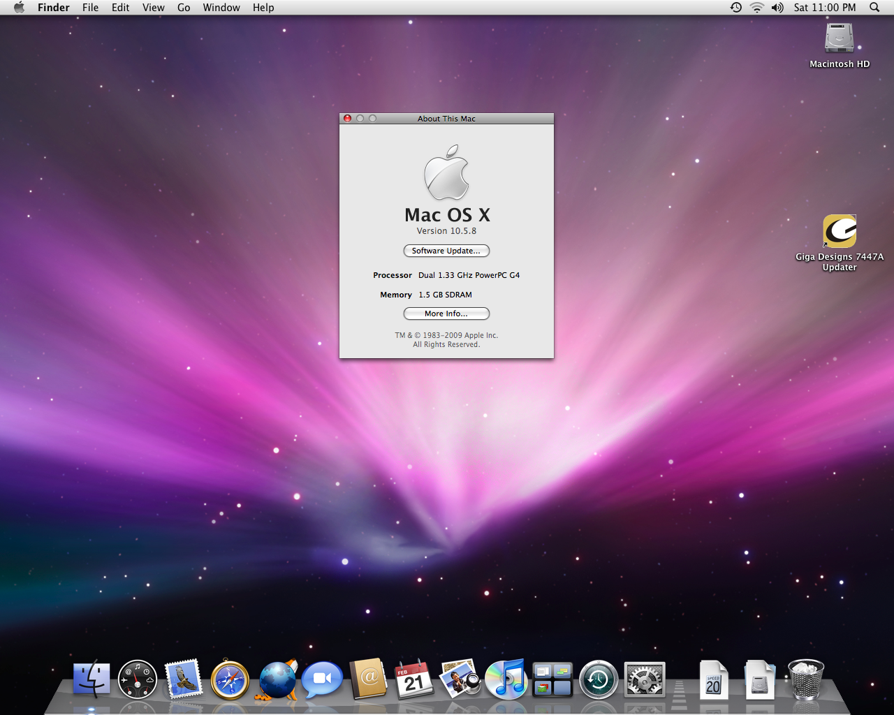

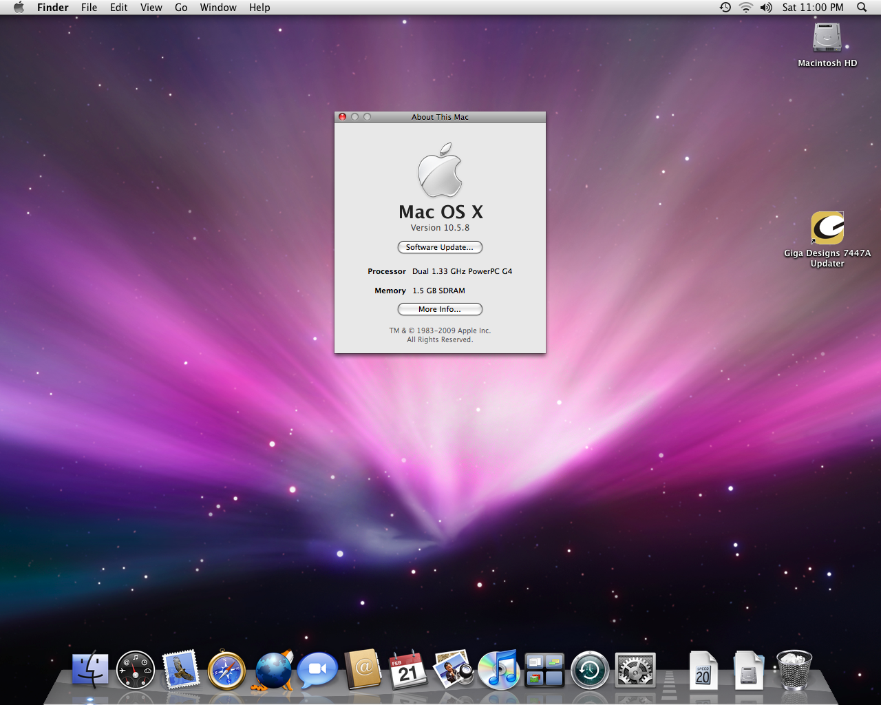

Well, things took an interesting turn. I'm typing this post from the Gigadesigns-equipped computer.
I finished doing a complete clean install and software updates(entirely in the computer I intended to install the upgrade in) and then flashed the ROM again.
I wanted to see how far I could get into a Leopard boot without installing the Kexts, and amazingly enough when I powered it up, it booted to the desktop.
Here's the interesting part-it's only reporting the speed as 1.33ghz despite using the DIP switch settings for 1.6ghz.
I'm going to install the Kexts now, and see what happens, but at least it's booting!

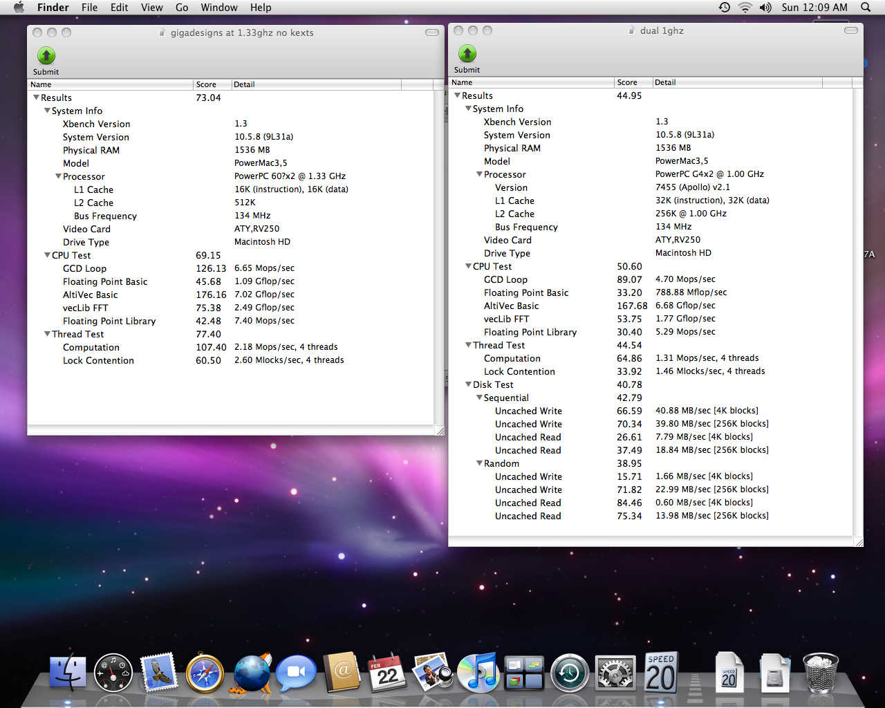

In addition, here are the Xbench results from the factory dual 1gzh and the Giga dual running at 1.33. The L3 cache on the factory 1gzh doesn't show up under the specs, as I was never able to get the computer to recognize it(supposedly, it was locked out on computers that didn't originally ship with L3-this was originally a single 800mhz QS 2002)

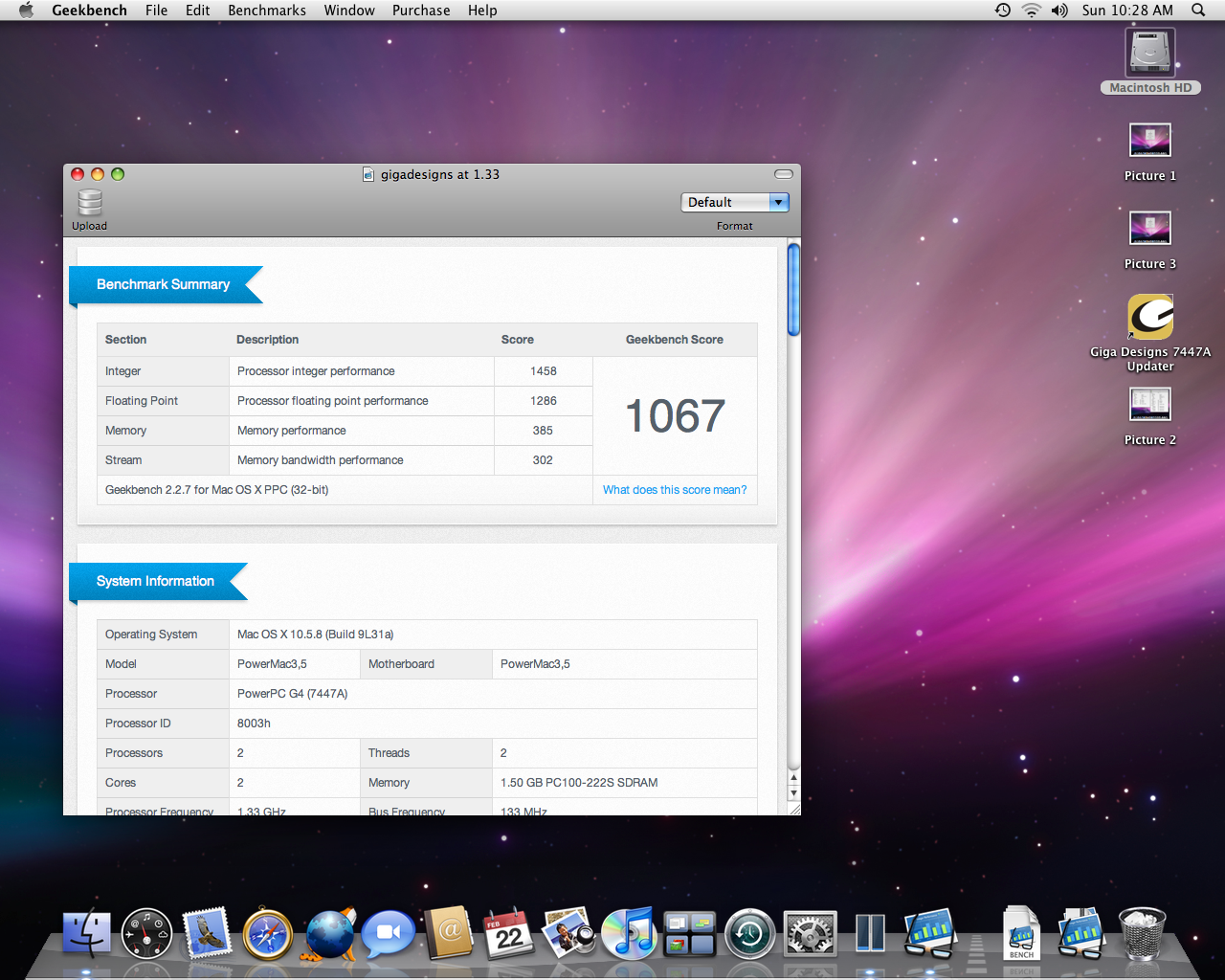

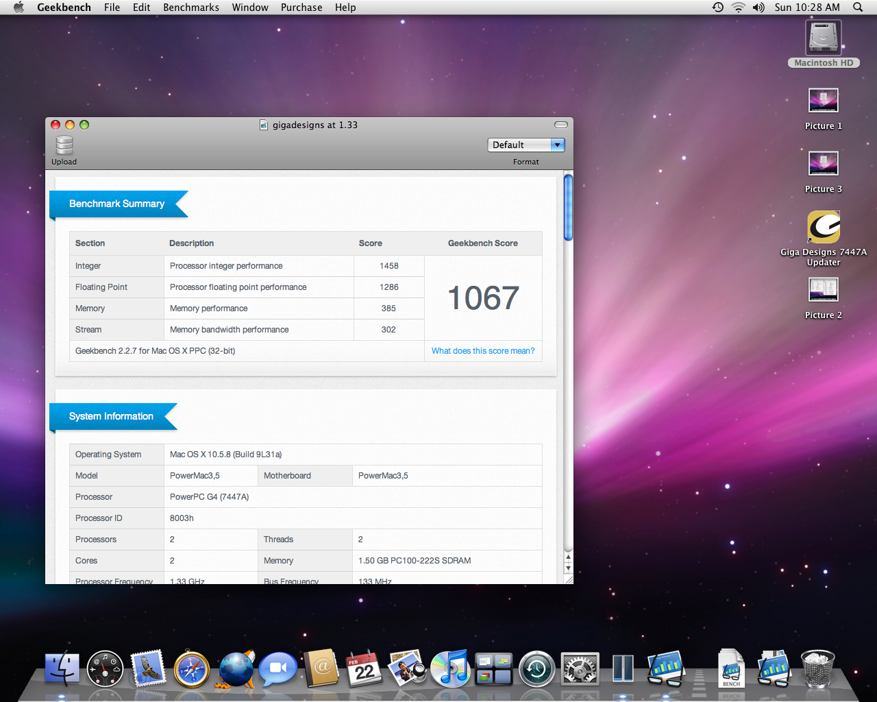

I didn't run Geekbench with the factory processor, but from past experience I know that the score with the dual 1ghz should be around 850-900. Here it is with the Gigadesigns at 1.33.

So far, I've had absolutely zero issues with this running at 1.33ghz-as I said, I'm just glad that I discovered this setting by accident(and didn't inadvertently fry something). It's as reliable and stable as a factory processor.
Until I get some more cooling on it, 1.6ghz just isn't going to happen. I've gone through and cleaned and oiled all three of the factory fans to get the most I can out of them, which means that I need to add more and/or replace the stock fans with better ones(I'm inclined to do both, at least for the main case fan and PSU fan). I'll try the 80mm fan on top of the two CPU fans and see if that helps any.

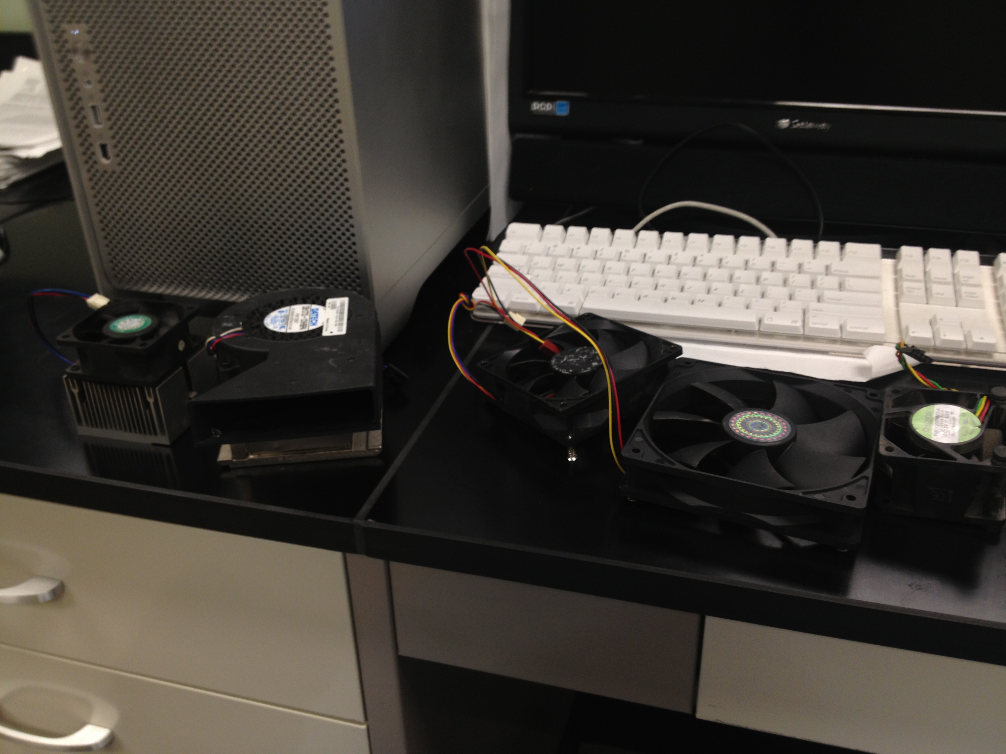

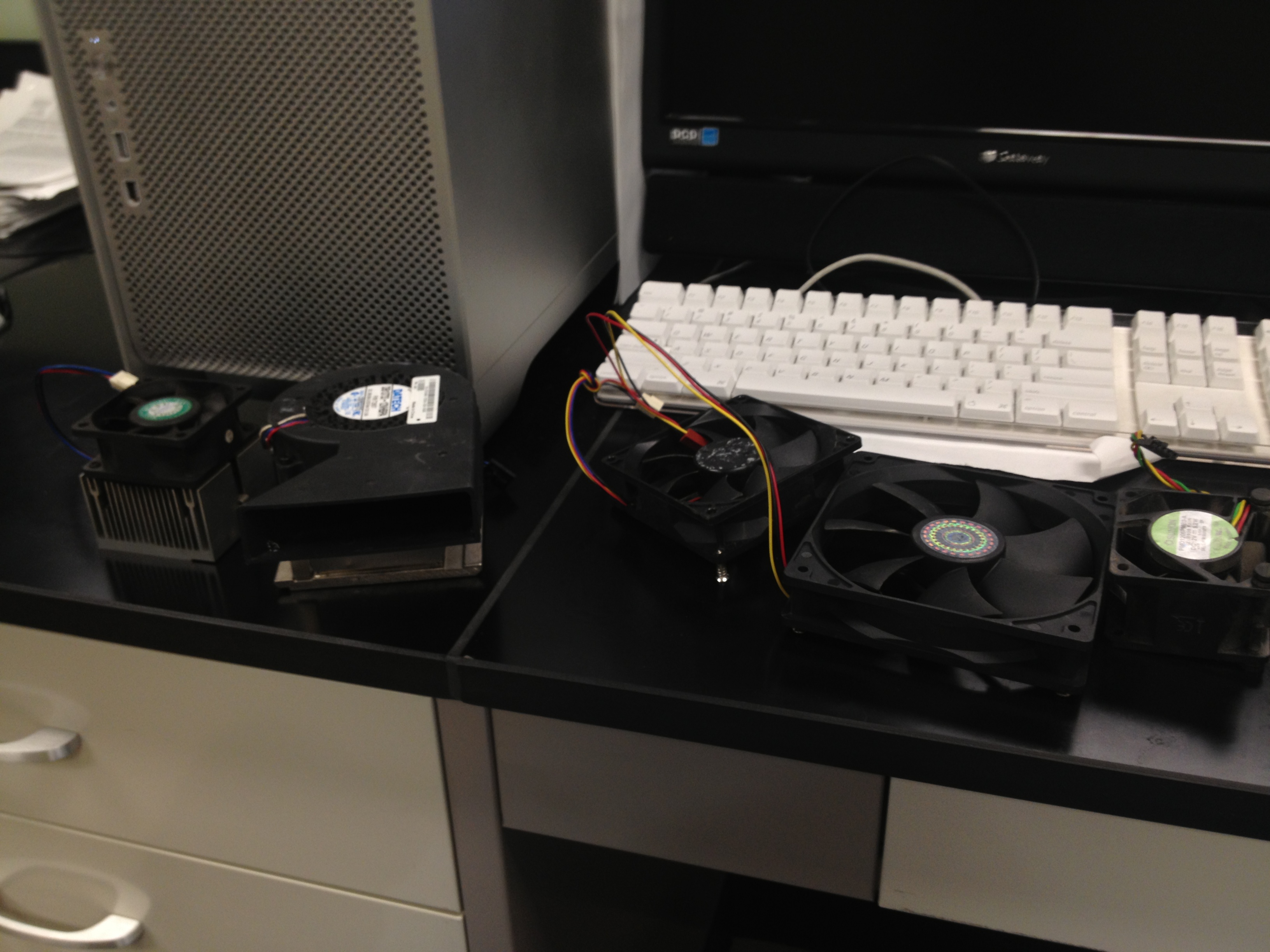

I went "shopping" today in Surplus for fans, and picked up a whole range of sizes from 40mm to 120mm.
The big blower-type fan should be interesting-I'm thinking about sticking it in the ZIP bay, and it should draw a lot of air out of the case.

i went "shopping" today in surplus for fans, and picked up a whole range of sizes from 40mm to 120mm.
The big blower-type fan should be interesting-i'm thinking about sticking it in the zip bay, and it should draw a lot of air out of the case.
FANS FANS YAY FANS!!!! 😀 😀 😀
