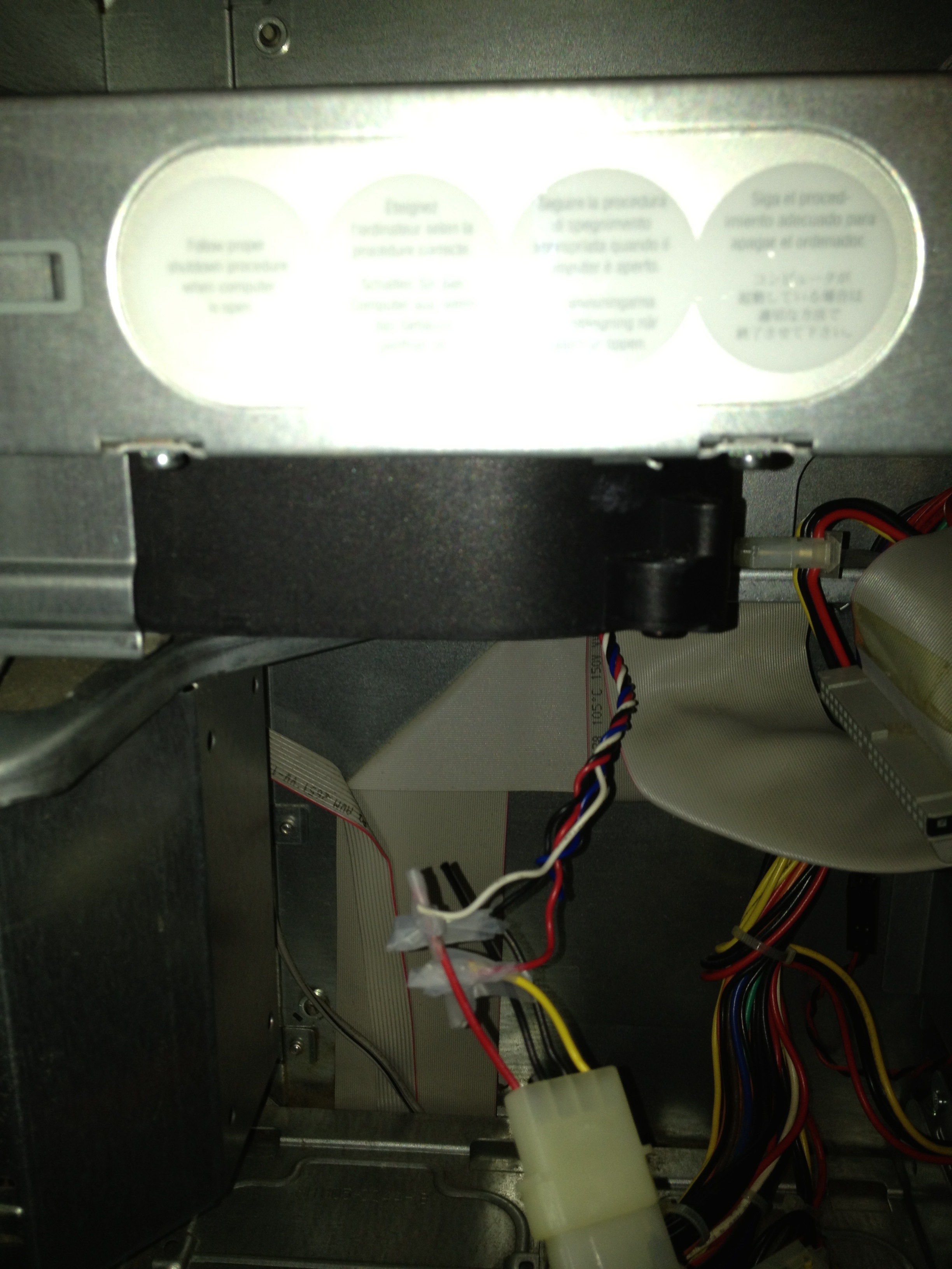

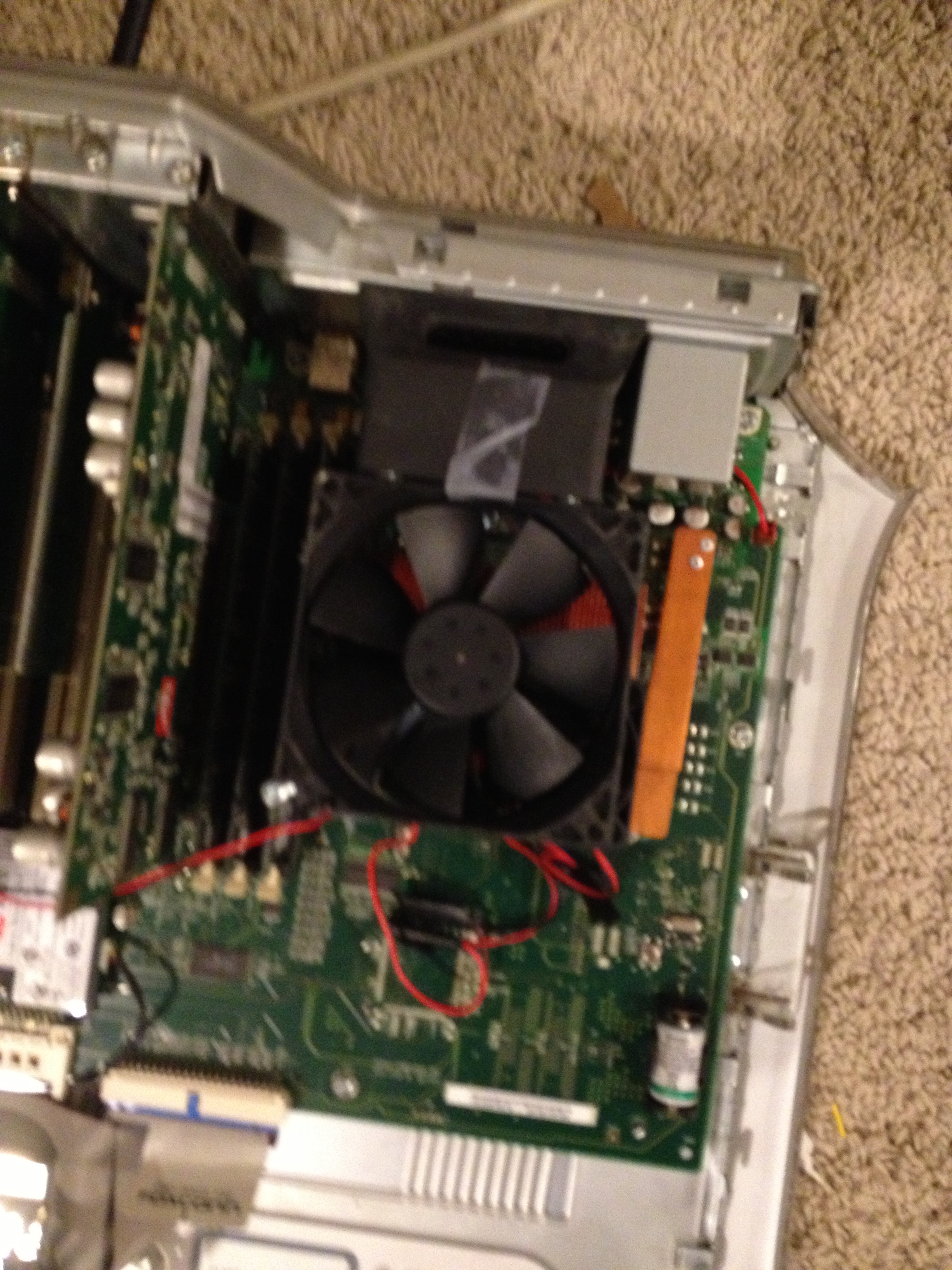

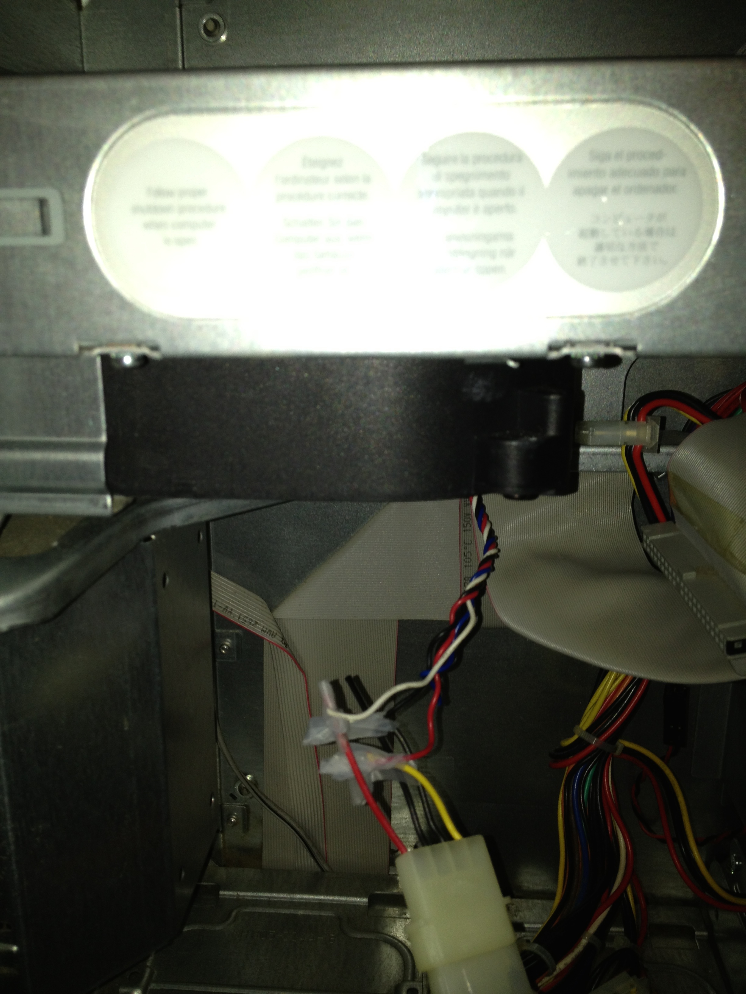

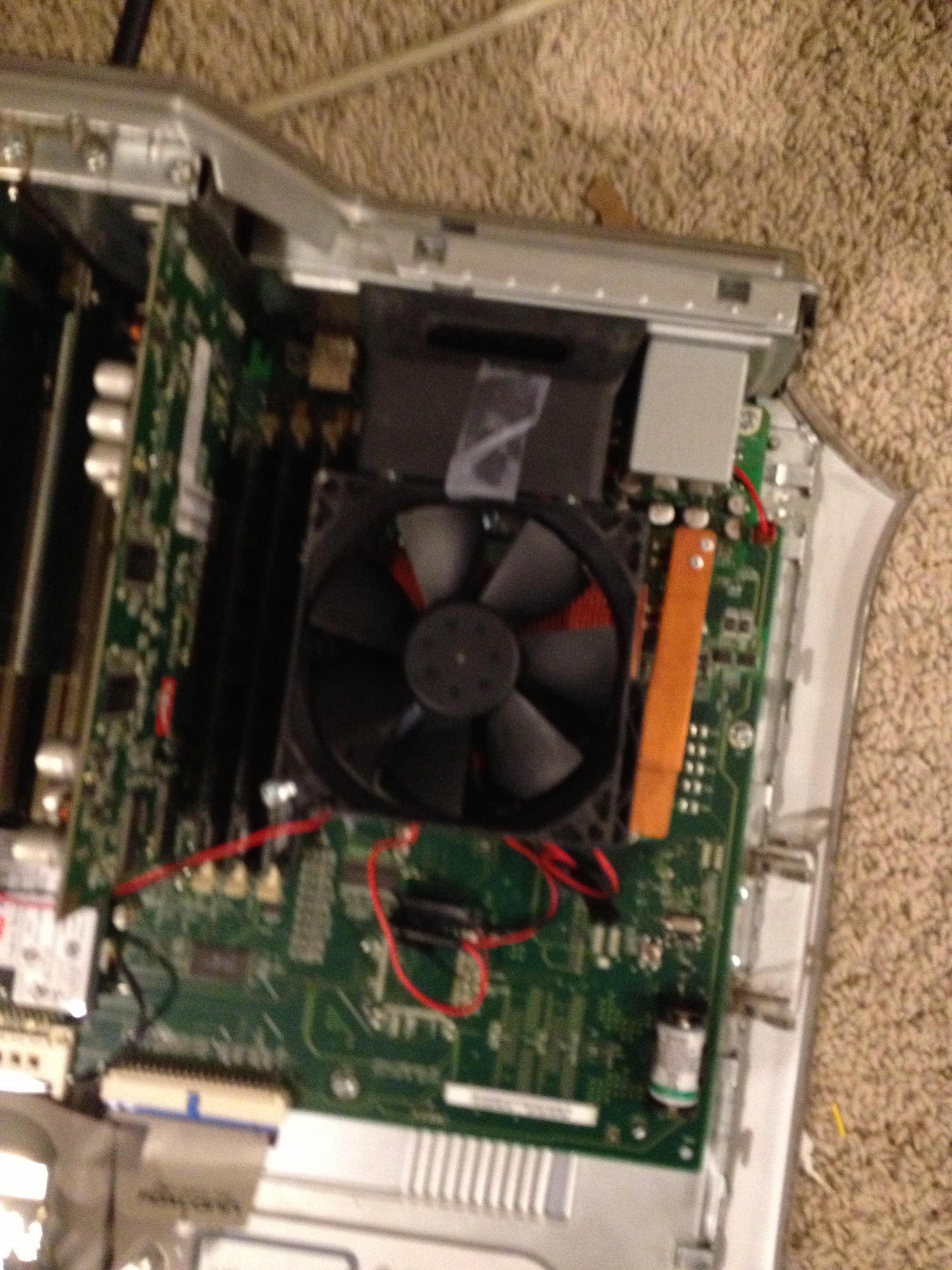

I installed two additional fans-an 80mm on top of the two CPU fans, and the blower in the Zip bay.
I think that I'm going to have to knock the blower down to 7V-at 12V, it makes the computer sound like a vacuum cleaner and pushes enough air to blow papers around.
I'm still tinkering with voltages, but I've at least been able to get a few minutes of stable operation at 1.6ghz and 1.45V.
I also need to get some electrical tape to clean things up and make them look a little bit better-I can't seem to put my hands on a roll. All the electrical connections I show are soldered, so the Scotch tape is really just serving as an insulator.
I'm considering taking the time to lap the heatsink also-obviously something is going on here to that's keeping the processors from getting as cool as they should be.
oooooooooo blower vac very cool 😀 😀 😀
I'd like to do that 😀
But does it actually make any difference of the air temperature inside at all?

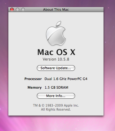

Back to 1.33ghz-this time at 1.45V. I just can't it to be stable at 1.6 for any appreciable length of time, although I did get it there long enough to take a screen shot. For the couple of minutes I had it running, I was getting weird screen artifacts and other issues.
A couple of reports with the additional fans:
1. 1.45V and 1.5V both were probably equally stable, although it probably ran a little bit longer at 1.45 than at 1.5.
2. I was able to get it to boot at 1.55, but it hung at the blue screen
3. 1.6V cause a kernel panic on booting
4. 1.4V would get stuck at the Apple with the spinning wheel under it.
I've also disconnected that obnoxious front blower for the time being until I rewire it for 7V. 🙂 I may also completely remove the Zip bezel to provide a little bit less restriction-and hopefully less noise. If I do that, I'll probably put the Zip drive in my dual 1ghz. I have a spare blank bezel around here from a Quicksilver I junked-I may try opening that up and putting some sort of mesh or something in it so that I have something that looks decent over the opening, but is less restrictive than the Zip bezel.
The only thing I have to go by is the hard drive temperature, and my finger.
Normally, the front part of the base of the case will get warm-but not hot. With the blower running full blast, the base of the case stays more or less at room temperature. The hard drives also stay fairly cool.
I doubt the blower is moving much air directly over the processors. If you look at the basic layout of the QS case, it basically is only drawing air out of the bottom part of the case-the PCI cards also seem to stay fairly cool. After 20-30 minutes of use, the heatsink on the GPU-a Radeon 9000-would normally be warm(I'm driving a 22" Cinema Display under Leopard), but with the blower running it stays cool to the touch.
So, I'd say overall it benefits the hard drives and cards, but probably not the processors. Even so, reducing the total amount of heat in the case isn't a bad thing, and probably ultimately helps the processor run cooler.

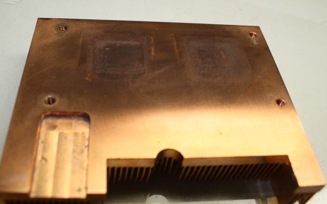

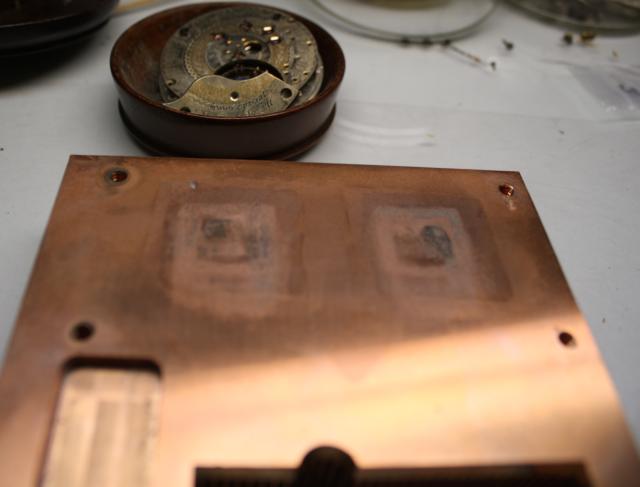

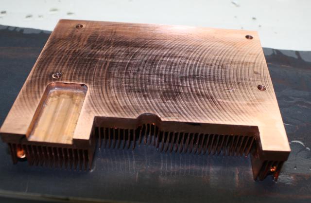

Before going full-on with the Peltier, I thought that I'd give lapping the heatsink a try. Improving the contact area between the heatsink and processor is always beneficial, so thought I didn't have anything to lose by trying this.
For those interested, here's the general process. This was the first heatsink I've lapped, but have done enough high-precision work(I am a watchmaker) that I was familiar with the general process.
First, I removed the heatsink
(since I did this whole thing on my watchmaking bench, I "photobombed" a disassembled Bunn Special in the background 🙂 )
And gave it a good cleaning with denatured alcohol to get rid of the thermal compound and other "crap" left behind.
As you can see, the finish on the heatsink is actually pretty poor, with a lot of remnants of machining marks.

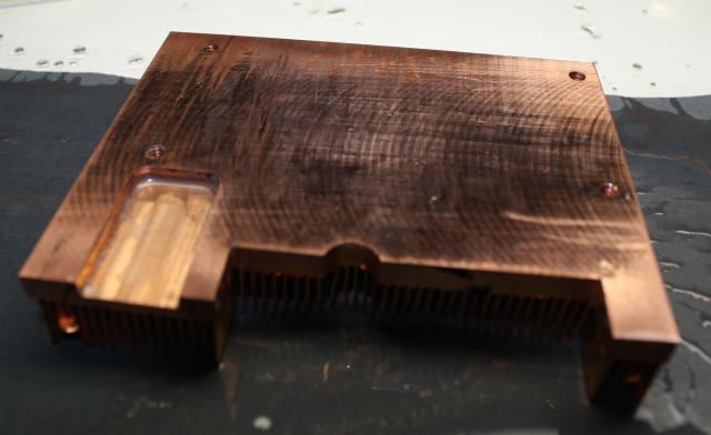

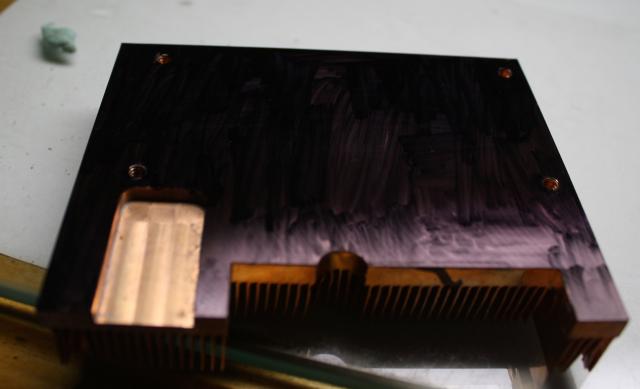

Once cleaned, my first step was to take a sharpie and color the entire bottom surface of the heatsink. I've not seen any online guides that suggest doing this, but it's a pretty standard technique in machining. Basically, since I'm assuming that the lapping surface(sandpaper on a sheet of glass) is perfectly flat, the sharpie allows me to monitor the flatness of the heatsink.

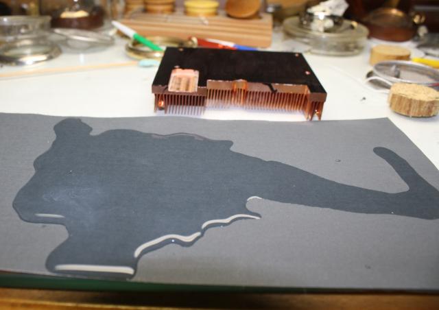

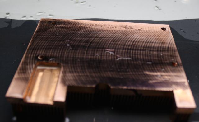

All the finishing work was done wet-copper is a very difficult metal to work with, and tends to be fairly "gummy" on abrasives. The liquid-which can be either water or oil-helps to carry the abraded metal particles away. If using water, a small amount of soap is also a good idea both to serve as a lubricant and to help keep the metal in suspension.
The first 10 passes over 400 grit sandpaper showed that the bottom of the heatsink is actually far from flat
About 100 more passes over 400 grit sandpaper didn't get me very far
Neither did a few hundred more
So, I did something that's a bit unconventional-I actually regressed to 320 grit sandpaper. The courser grit makes flattening out the surface a lot faster, at a cost of a lot more "cleanup" work later.
After getting the surface more-or-less clean with 320 grit, I went back to 400 to remove the marks left by the 320 grit(unfortunately I didn't take photos of the intermediates)
As you can see, I didn't eliminate all of the machining marks, but did at least get the worst of them.

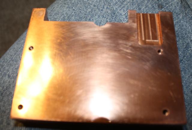

I then proceeded through a progression of finer grit sandpapers-600, 800, 1000, 1500, 2000, and 2500. I didn't take photos all along the way, but the general process is the same-basically you just sand until you can no longer see the lines left by the previous grade. One trick I learned a while ago is to turn the part being sanded 90º with each change in grade. This makes it easy to see which lines are from the grit you are currently using, and which are from the previous grit.
When I went to 600 grit, I switched over to using oil. It's messier, but I've always felt that it gives a better finish. Here's a photo of sanding in oil-the orange tint is from copper suspended in the oil.
And, here it is after finishing the 2500 grit polish
Finally, I gave it a good polish with Simichrome. This is probably unnecessary, but makes it look better 🙂

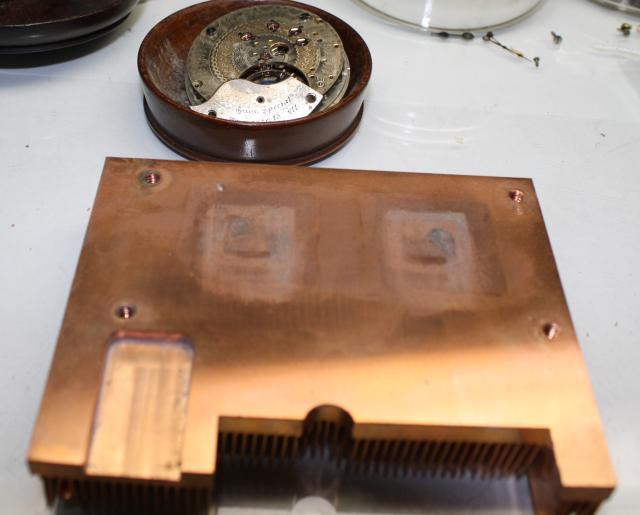

I gave the whole heatsink a bath in hot, soapy water so I'm going to let it dry overnight before re-installing.
By the way, the screws are a standard 6-32 machine screw. While I was at the hardware store buying sandpaper, I also picked up some 6-32x1/2" screws to replace the idiotic pin-headed ones that Gigadesigns used to fit heatsink to the processor originally.
I don't know if this will actually make any difference, but it certainly can't hurt anything.

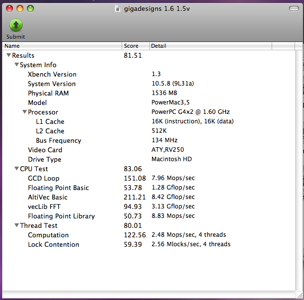

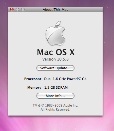

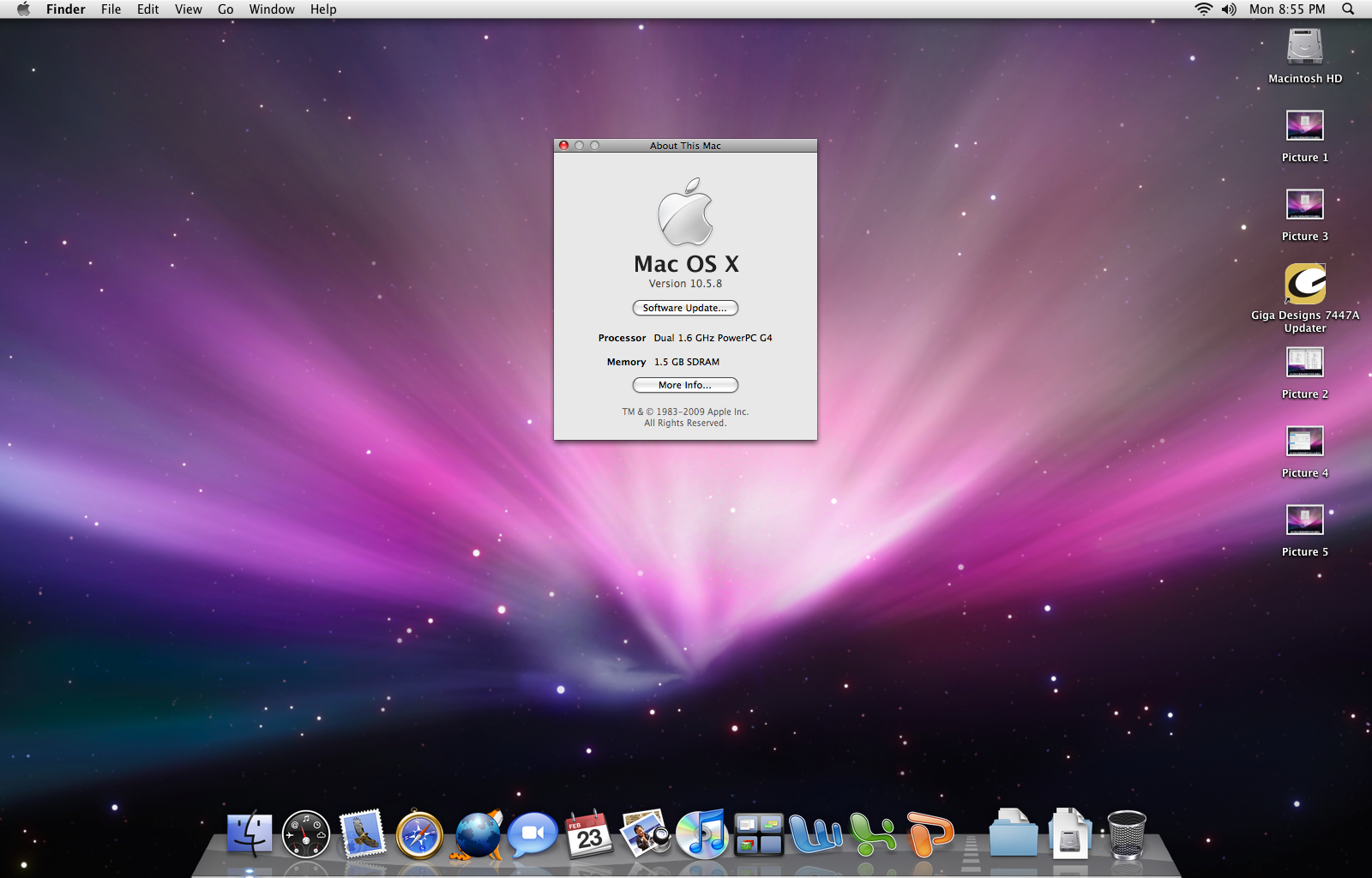

1.6ghz at 1.5V, here I am! That's without running the leaf blower on the front, too, although I do still have the extra 80mm on top of the CPUs.
So far so good-I've actually had the system running stably for about 5 minutes now, which is much further than I've been able to get before at 1.6ghz.
After really seeing how poorly finished the factory heatsink was, I'm not surprised that this thing has always had heat issues.
The Peltier pumps may end up being a science project and not make it onto the CPU...

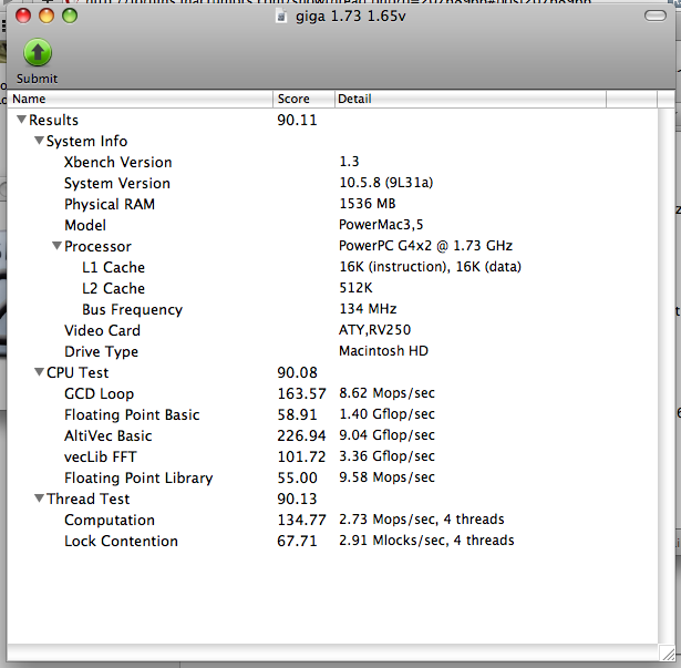

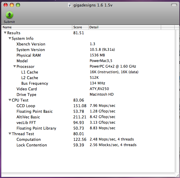

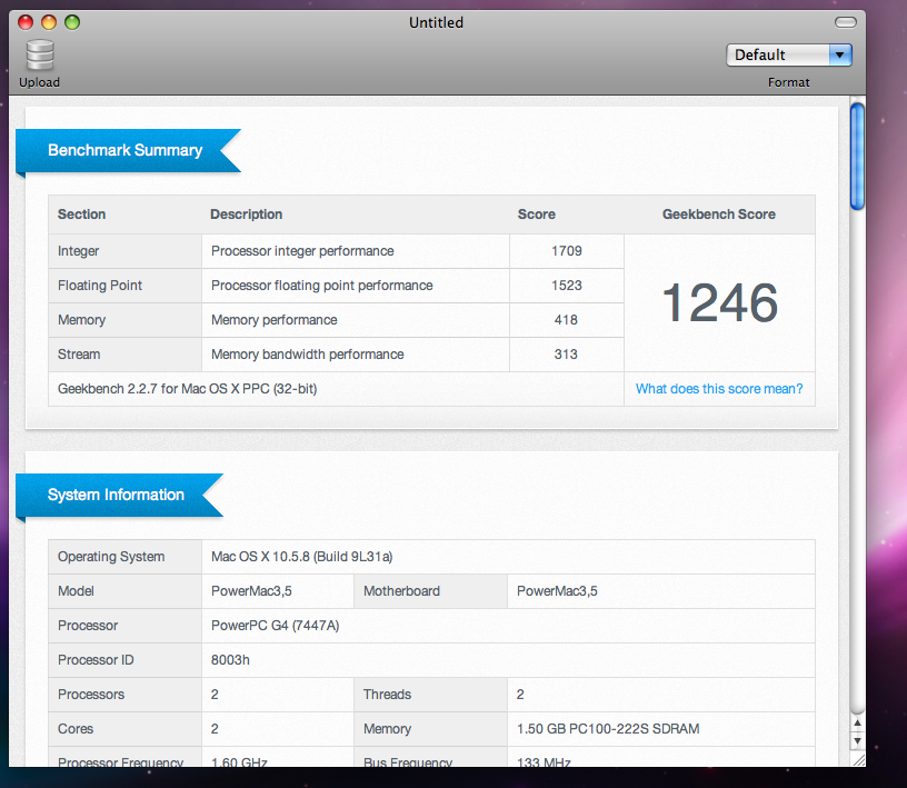

Geekbench and Xbench results at 1.6ghz. The Geebench score is higher than one Everymac has recorded for the dual 1.42 MDD!

Oh very Nice! Good to see you got it going at 1.6Ghz 😀 I wonder if you can make it to 1.8Ghz or with the Peltier cooling maybe push it to 2Ghz? (that would be one beast of a Machine LOL) this makes me wonder if i could push my CPU upgrade to a stable 1.6Ghz...(it runs fine at 1.5Ghz) the Heat sink on my one is not as bad as your one was. Maybe if I strap an extra fan or 2 to mine LOL and maybe shove it in something better then the beat up Sawtooth I have. (any one want to give me a DA or QS? 😛)
I actually briefly tried 1.8 this evening just to see if it would boot.
I couldn't get the computer to chime, which makes me think that I probably need to tinker with the voltage a little bit more(from my earlier experiments 1.5V was pushing it at 1.6, although it's certainly stable now).
I'm going to give the paste a day or two to cure(I'll probably stress test it overnight and then shut it down when I go to church in the morning to let things cool of), and then maybe try again with 1.8.
By the way, now that it seems to have "settled in", I can't believe how fast this thing feels. It's easily the fastest G4 I've ever used, and I would say that at least in things like web browsing it's every bit as fast if not faster than my single 1.8 G5. I have the Activity Monitor "bar graphs" in the dock, and tasks that would peg both bars on my(factory) dual 1ghz QS won't come close on this computer.

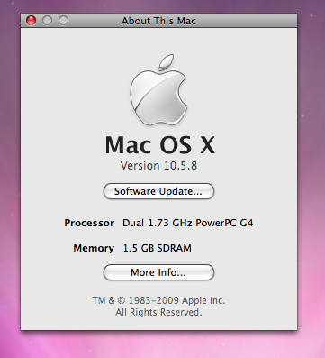

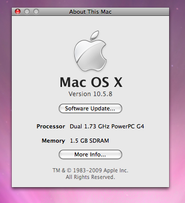

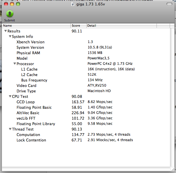

1.65V was enough to get me to 1.73ghz for a few minutes, although the computer froze(completely) while I was running Geekbench. It would get hung at the blue screen before log in at lower voltages, and I don't have diagrams for anything higher than 1.65. It would at least chime at 1.8ghz/1.65V, but never even get to a grey screen.
In any case, here it is for proof that it happened(along with Xbench), although I'm now back at a comfortable 1.6ghz/1.5V.
Perhaps I should start investigating some of those new miracle thermal pastes. I've always been happy with AS5, but it seems as though I'm on the threshold of of the thermal limits. Maybe a few more days of curing the AS5 will help some.
By the way, I also hooked up the blower at 7V, although it barely moves any air. I'm thinking a pair of diodes in series with it at 12V to drop it to about 10.5V might be the ticket. The closing Radio Shacks in the area have made that stuff really cheap 🙂
I shouldn't be complaining about 1.6ghz, but I feel like 1.8 now is an elusive goal that's at least within reach.
