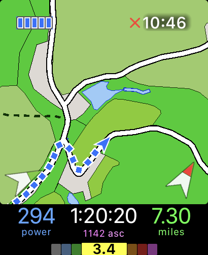

Hi, love the app but just have a couple of queries that I'm struggling to find answers on please. (1) I periodically get a red "X" next to the time on the map screen. Am I right in thinking that this is indicating there is no cellular connection or does it mean something else? (2) post run my AWU doesn't seem to automatically upload to Strava (I thought it used to on my previous AW4). When I manually try to upload it from the watch I receive the following "Error: No Strava Login". Am I doing something wrong and is there a way to link Strava from the watch - it uploads from the iphone just fine so no major issue. (3) I thought I recalled a previous option to include the apple music player on the screen list but I can't seem to find this option anywhere. Did I make this up or am i just overlooking this option somewhere. Thanks in advance 🙂
1) I don't know what a red cross next to the time indicates. Can you post a screenshot?
2) You probably haven't re-sent your settings from the phone app to the watch after getting a new watch. To resend the Strava details go to the Settings tab on the iPhone app and tap Export Options. Then disable Automatic Strava Export and then re-enable it. That should send the Strava details to the new watch.
3) You cannot configure the Now Playing screen as a screen. However you can configure the app to show it in response to a gesture. To do this go to the Settings and tap "Commands" and then "Shortcuts". This will show a list of gestures such as swiping, tapping multiple times or using both side buttons at once. Tap the gesture that you want to display the Now Playing screen and a list of operations will appear. Choose "Show Now Playing" and the music controls will appear whenever you perform that gesture.
Amazing response for an amazing app - thank you. I will come back to you with a screen shot on the red cross asap. 👍
As advised, re-syncing the phone and watch Strava settings worked - thank you.
The is a screen shot with the red cross next to the time I was referring to. From memory this area normally shows the symbol relevant to the focus mode I am in (I think) but the red cross appears intermittently and I’m thinking it’s when the cellular connection is lost but would welcome your thoughts 👍
