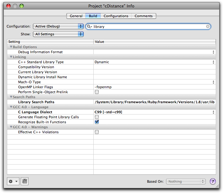

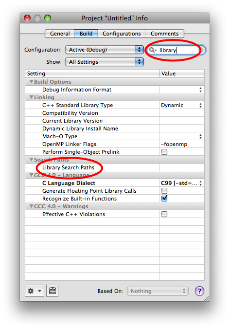

Hi,
setting up a search path for libs can be done in the same way as setting up a search path for *.h files.
Best regards
Peter

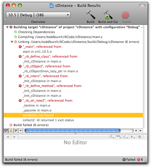

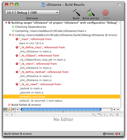

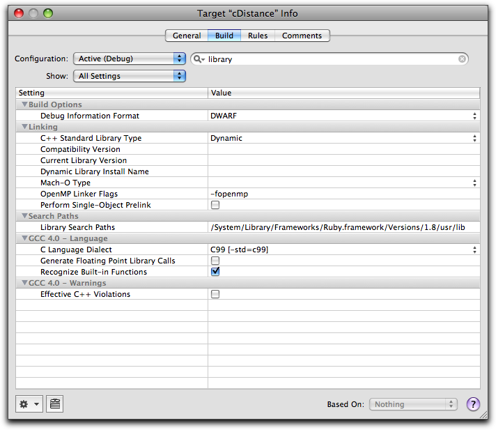

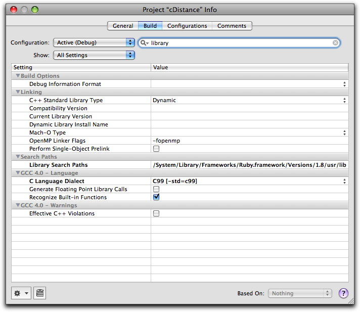

I've taken a stab at that, and no joy yet. Building a Ruby extension, outside of Xcode, works fine. The output of the extconf.rb is a Makefile, and the output of the Makefile is this:
Code:
todd-burchs-computer:cDistance toddburch$ ruby extconf.rb
creating Makefile
todd-burchs-computer:cDistance toddburch$ make
gcc -I. -I/System/Library/Frameworks/Ruby.framework/Versions/1.8/usr/lib/ruby/1.8/universal-darwin9.0 -I/System/Library/Frameworks/Ruby.framework/Versions/1.8/usr/lib/ruby/1.8/universal-darwin9.0 -I.  -fno-common -arch ppc -arch i386 -Os -pipe -fno-common  -c main.c
cc -arch ppc -arch i386 -pipe -bundle -undefined dynamic_lookup -o cDistance.bundle main.o -L"." -L"/System/Library/Frameworks/Ruby.framework/Versions/1.8/usr/lib" -L. -arch ppc -arch i386    -lruby  -lpthread -ldl -lm

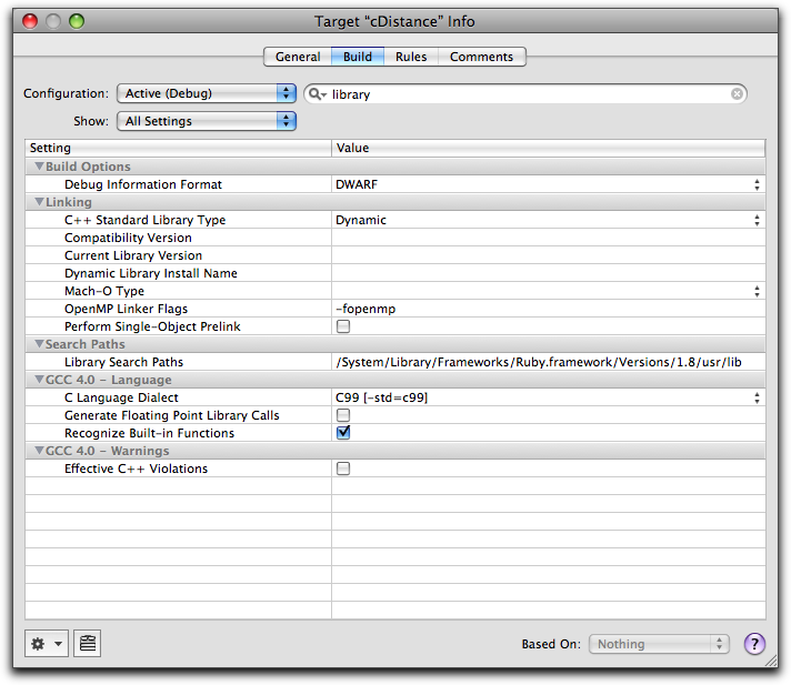

I've tried adding /System/Library/Frameworks/Ruby.framework/Versions/1.8/usr/lib to the Library search Path as you suggested, but the link continues to fail on the external references.
I have a friend that writes Ruby extensions with Xcode, but I think he has changed his Build system to leverage extconf.rb and make. I'm still reading up on how to do this. I've asked for him to create a YouTube video on his setup, but that hasn't happened yet. He said is able to use the debugger and profiler with his setup. That would be great.

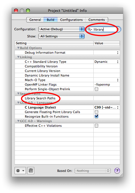

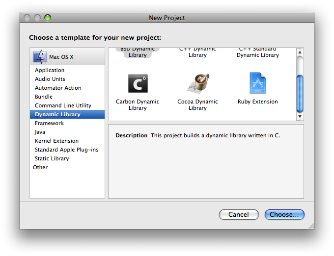

@toddburch Maybe you should have a closer look at the documentation of Xcode? A search for "Xcode ruby extension" gives 42 hit at developer.apple.com!
In addition, you can set up a new project create a ruby extension ...
