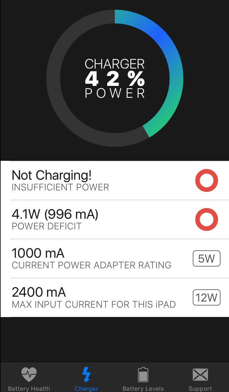

Basically, the iPad Pro is consuming about 1875mA in total at that particular moment, 1000 of which are coming from the power adapter, and the rest are coming from the battery...
As for longevity, as always the recommendation is that deep discharges (draining the battery all the way down to 20-30% or so) tend to shorten the life of Lithium Ion batteries. The ideal usage is shallow discharges down to 50-60% if you can help it.

I wonder if the maximum charging rate the app reports is correct. Maybe it would charge faster, if you used the retina Macbook charger with a USB-C -> USB Adapter and the Lightning cable…
The app reports the maximum current allowed on the Lightning port, as reported by the device. All other Apple devices have reported this accurately. For example, the 6 Plus and the 6S Plus both report 2000 mAh, which is exactly right. All recent iPads report 2400, and older iPads report 2100 (10W).

Basically, the iPad Pro is consuming about 1875mAh in total in that particular moment, 1000 of which are coming from the power adapter, and the rest are coming from the battery...
