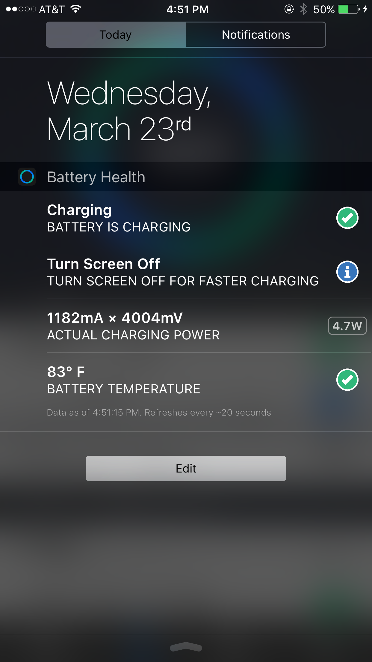

I actually added a widget in the latest version, but Apple is so far refusing to approve that version.
