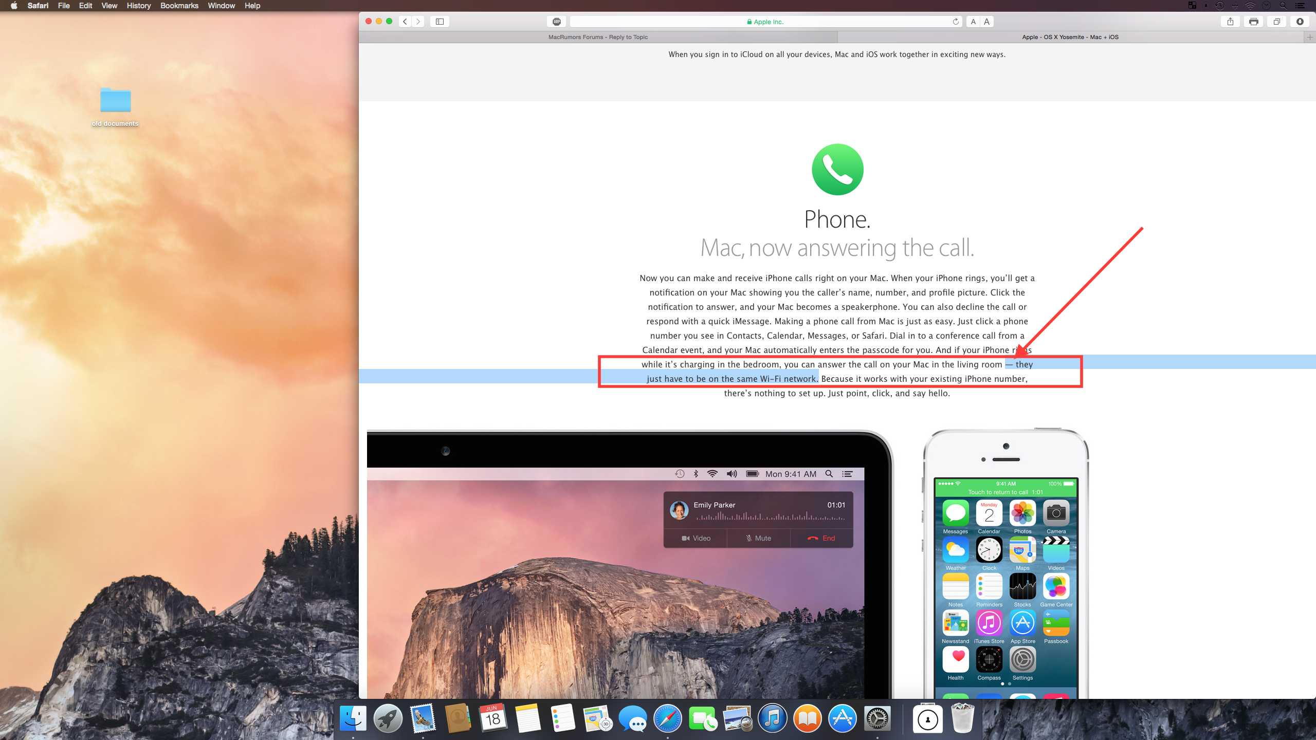

I have got an iMac 2011 and an iPhone 5 . They worked with phone calls while connected on same wifi network
Phone handoff doesn't REQUIRE bluetooth LE/
1.the bluetooth requirement is mentioned in iOS 8 beta 2 notes as being a bug and a known issue
2. Its even mentioned on Apple website See pic
