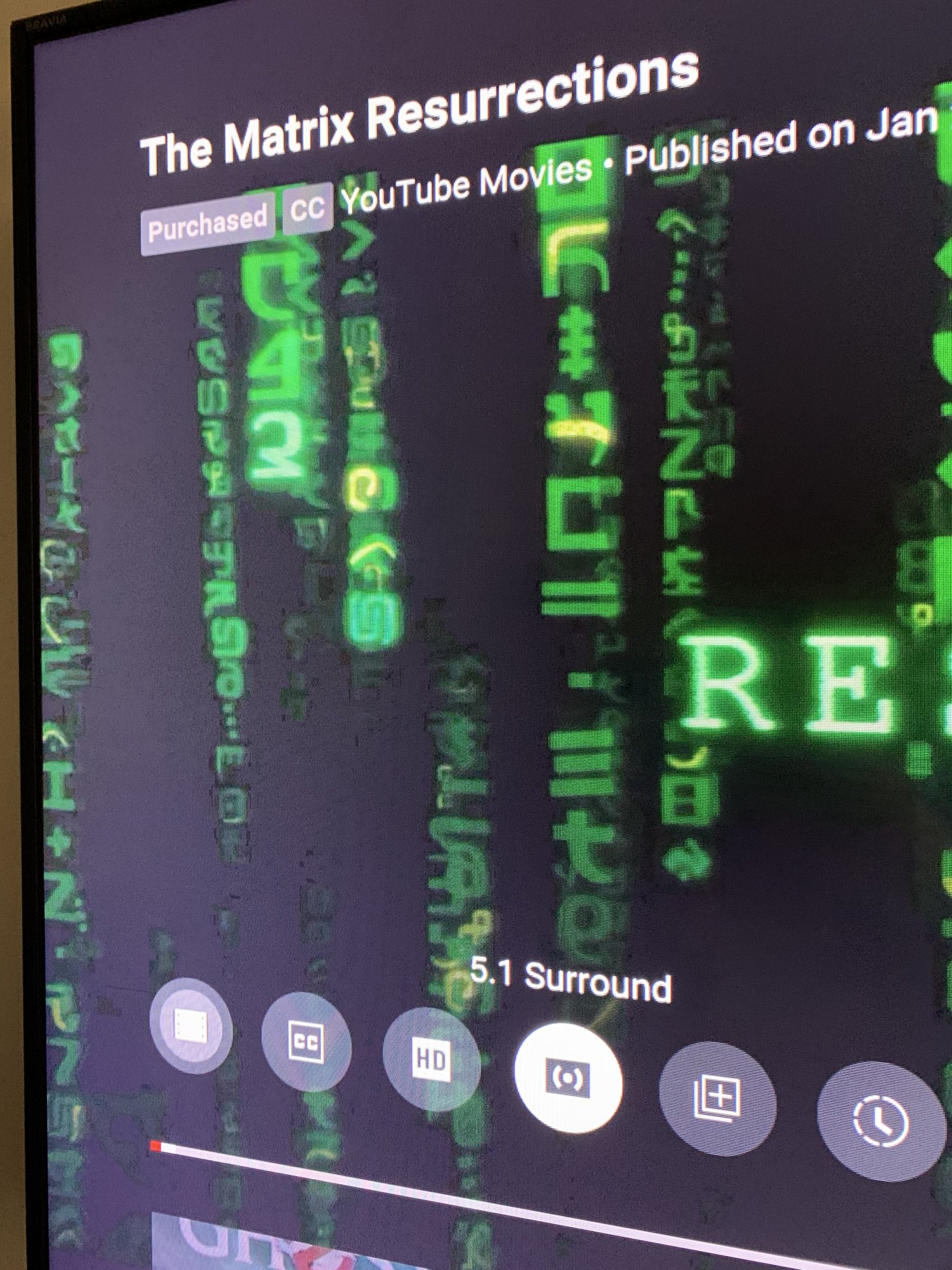

Just noticed YouTube has pushed an update on the Apple TV app with a “5.1 surround” button but it’s not working on my Apple TV. Did any of you check?

I still see only 2.06.22.00 - June 13, 2021 YouTube app on tvOS via App Store. How about a photo of this?

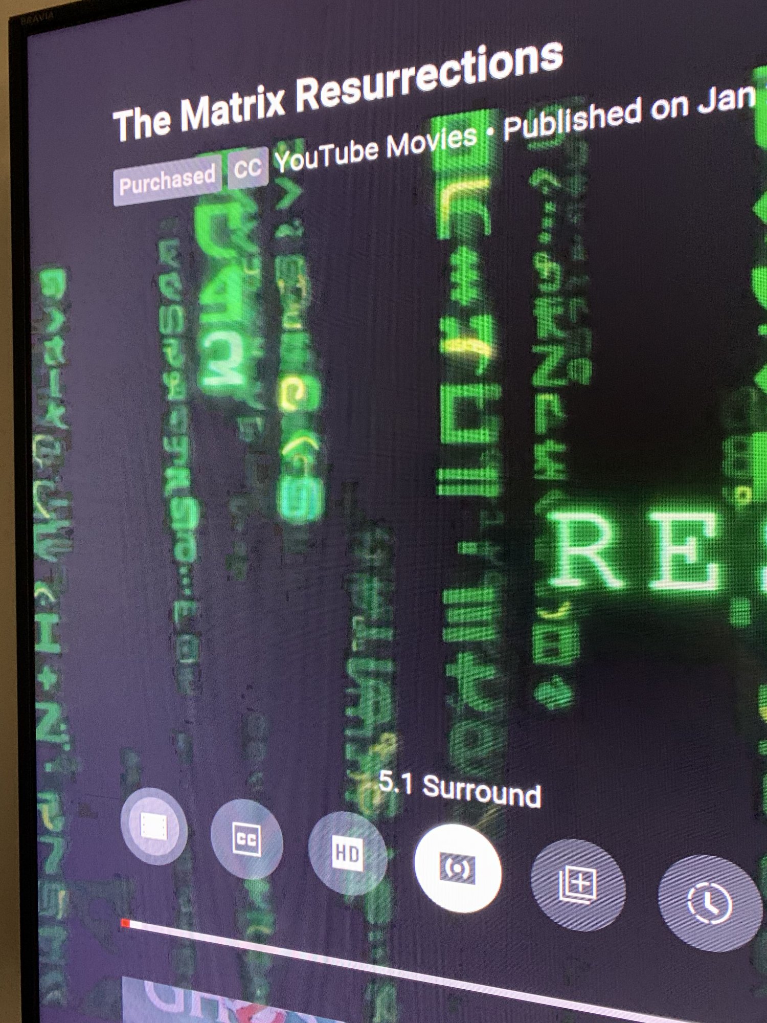

By the way, this is the button I’m talking about and the app version section says I’m on version 2.06.22.00/web_20220320_10_RC00
So apparently a release canditate version from March 20th

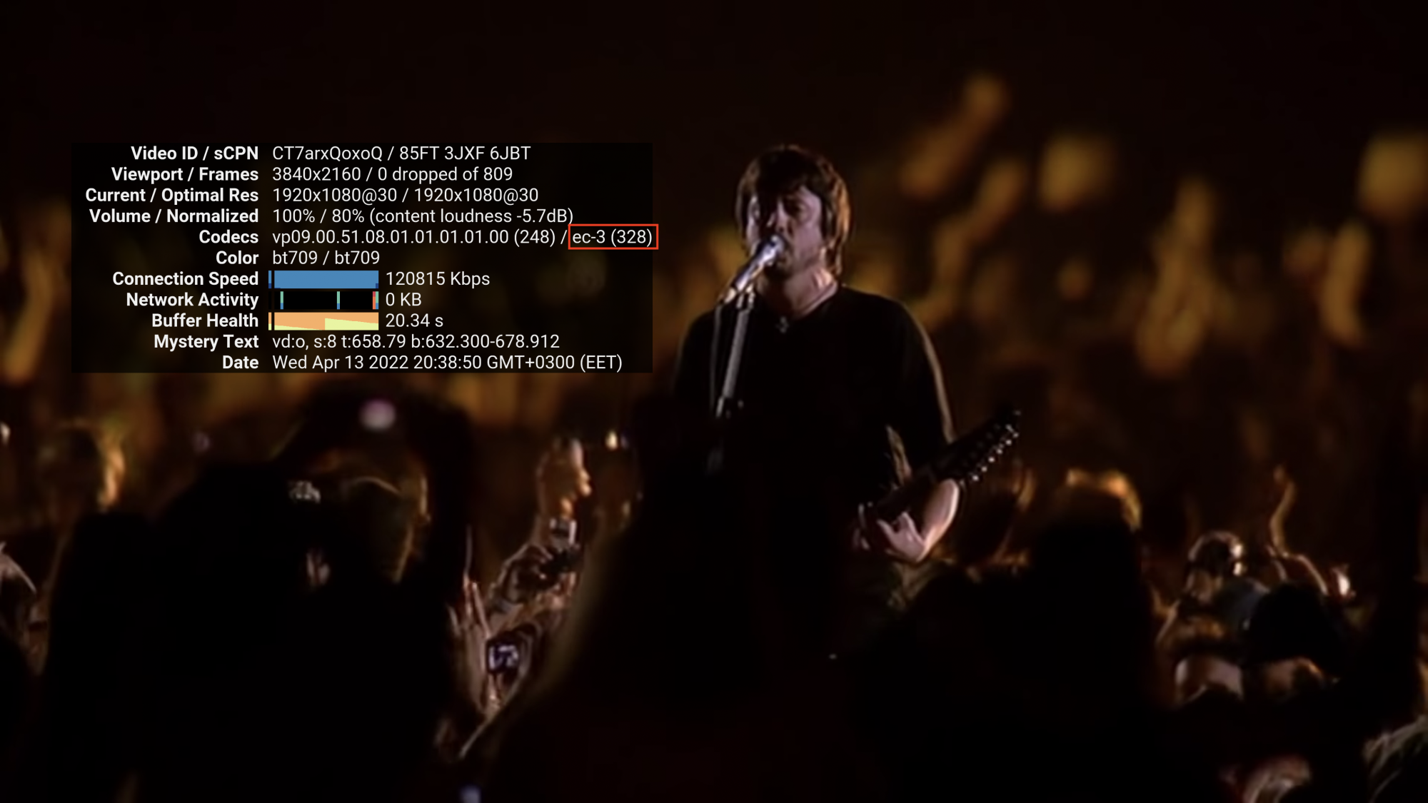

Yes, it looks like there are changes happening.
New audio formats that I can recognise are the 256, 380, 328 and 258
The YT app on my appleTV receives nicely the EC-3 stream.
