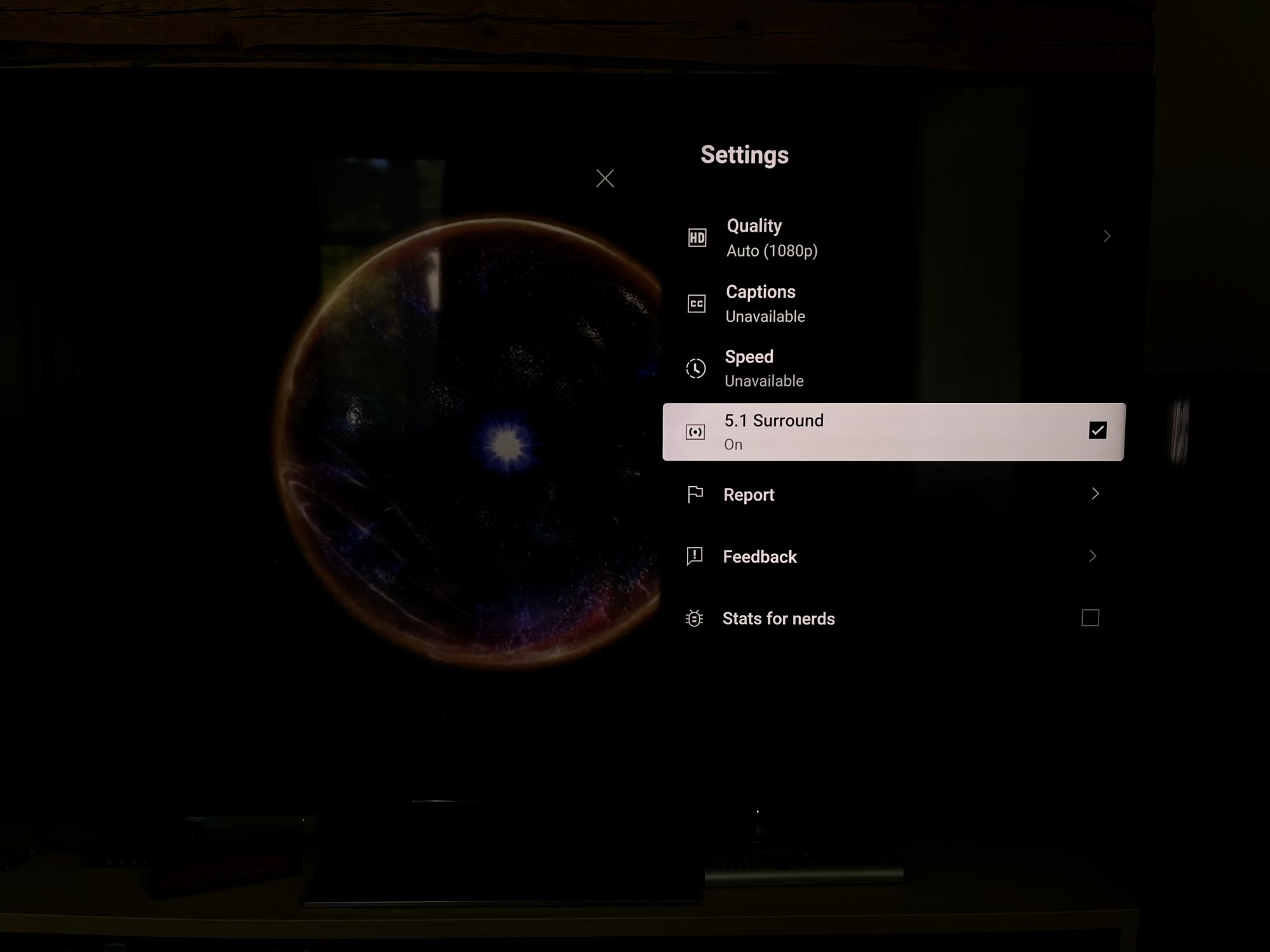

To the best of me, today, I am not able to see the Surround button any more, nor do I get 5.1 audio from that clip, whatever I try.
The track itself still contains the 4 multichannel audio renderings, so it must be something else.

You're right! I just checked the Foo Fighters video again and the 5.1 option has disappeared.
The same thing happened to me. Last week several videos uploaded by regular users (not just movie trailers on the GP store) would play in 5.1 surround. Now they are all playing normal stereo and the surround button option is no longer showing. Hopefully they are just testing this before a wide rollout. I can’t wait
Actually the button is still available when I play purchased movies in my library but, just like last week, it’s useless.

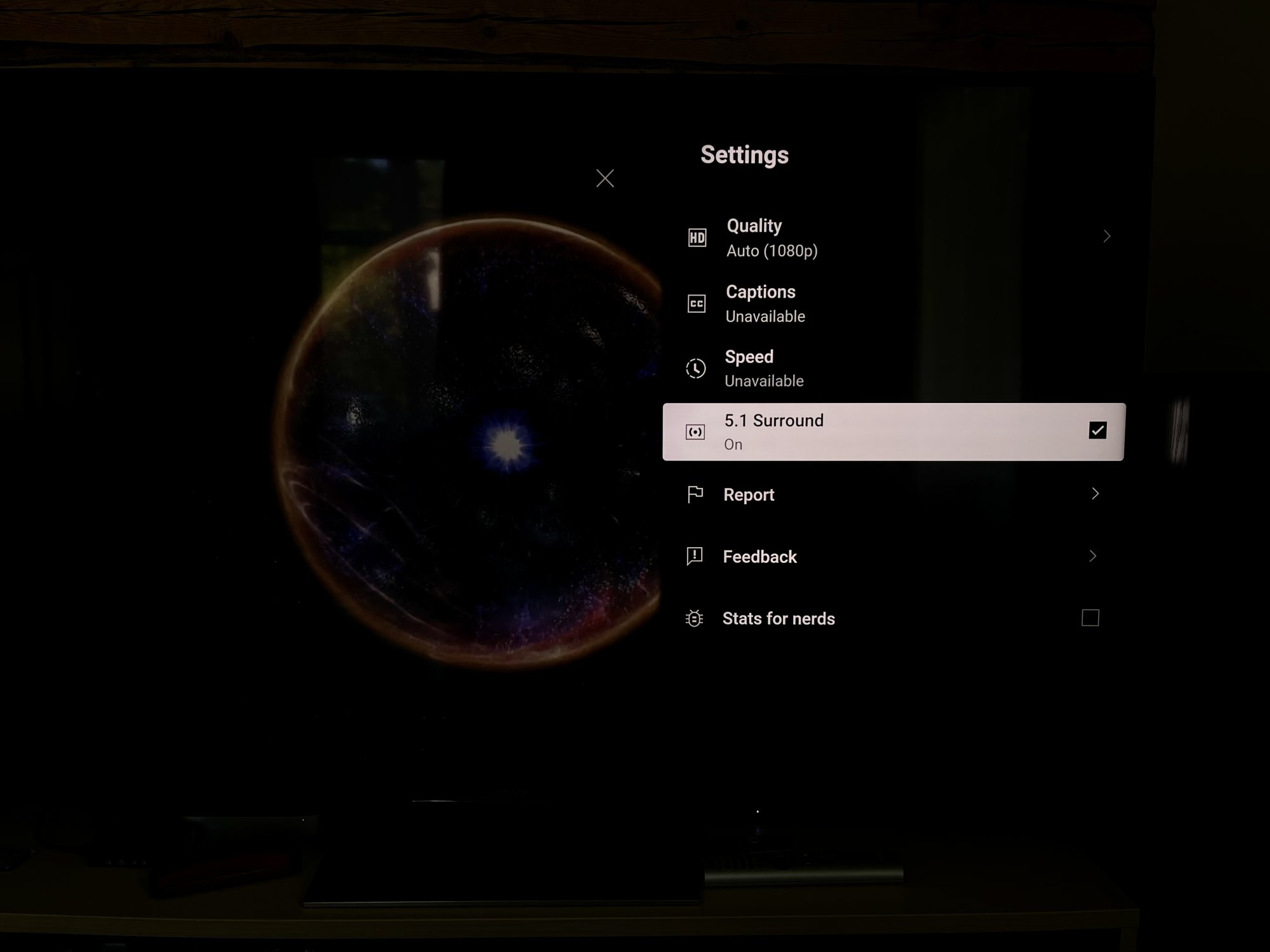

Actually a couple of weeks ago some videos played true 5.1 surround sound. I played several demo videos from Dolby and atmos and they were not Dolby pro logic mixes
Just found this. Not sure when it was first published. Unfortunately no details on which Apple TV models are supported
Just found this. Not sure when it was first published. Unfortunately no details on which Apple TV modes are supported
Yep, it's back for me. Tried that same Foo Fighters Hall of Fame video I linked earlier. Unfortunately, still has a very significant penalty in overall volume when switching to multichannel.

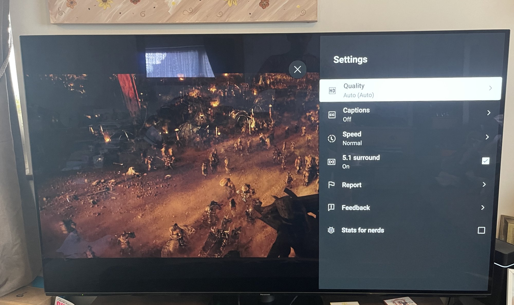

Yeah, the option is back but it doesn’t appear to be playing 5.1 audio regardless. I guess it’s still in a trial/beta stage but gee, it’s taking forever! In any case it was working back when I started this thread so I’m still hoping it’s coming soon
Reactions: HobeSoundDarryl
Tried it out today. The UI in tvOS has changed. This new sidebar is behind that cogwheel button. But I do get PCM5.1 out of my AVR!
