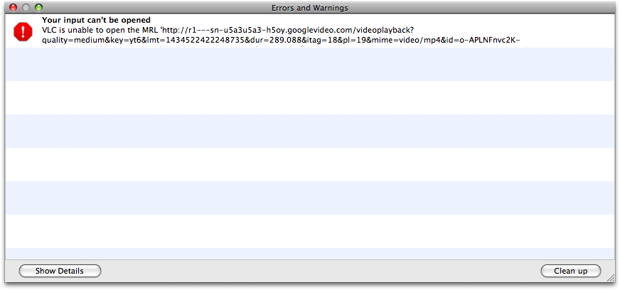

Yes, i had that covered already. SMtube is serving up a URL that none of the players can load, I tried VLC too, same story.
Can you post a screenshot of the URL or post it so I can compare with my system ?

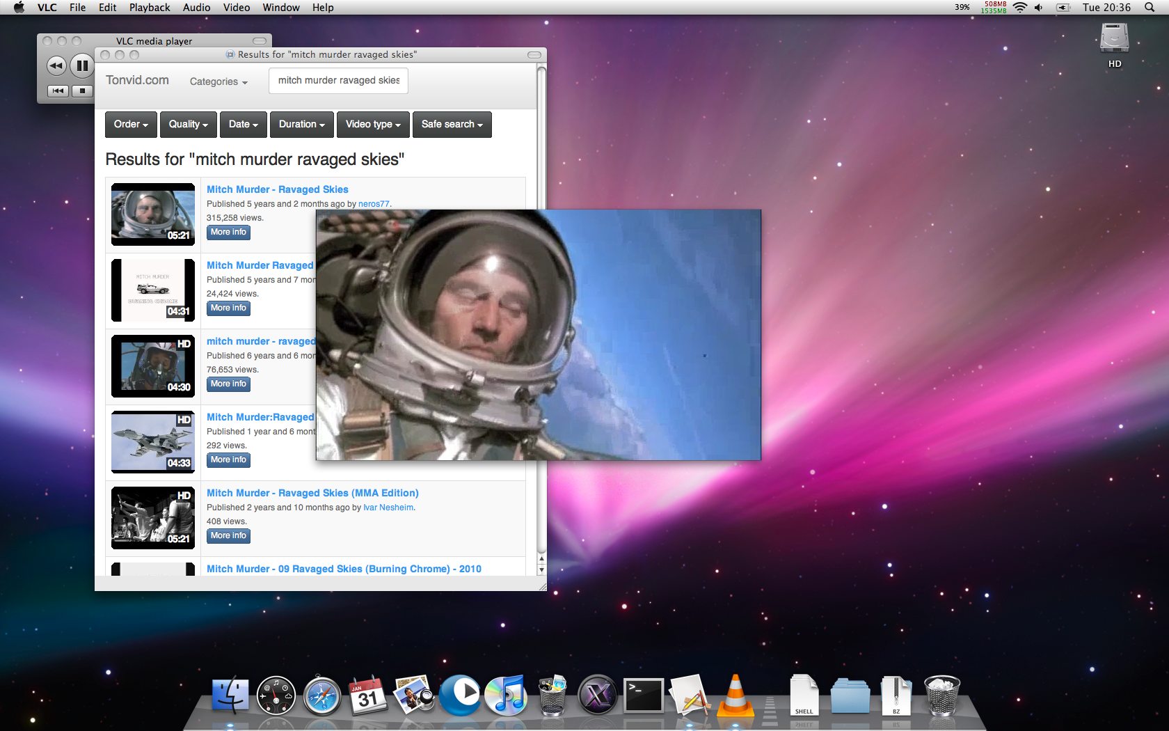

Here's a URL as shown from VLC:

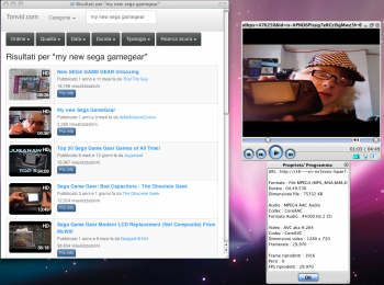

It's nearer Mactubes/Youview - you search from the app, see the thumbnails, click on the vid and it opens in your player of choice:
