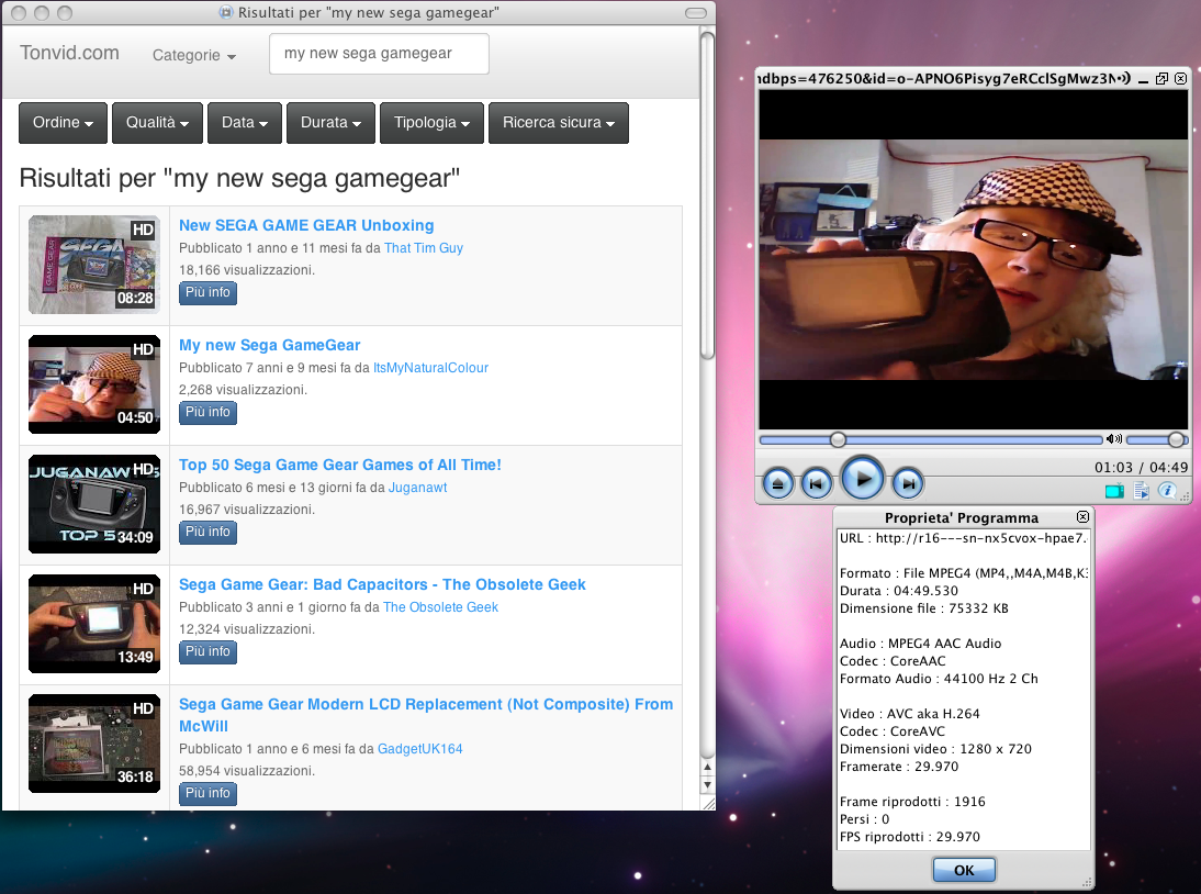

I tried them with 360/720p mp4 on Coreplayer on my PB G4 12".

The results are that the newer compiled source code ( see how to in the updated 1st post ) on Leopard now seems to be able to play the videos that Dronecatcher couldn't play with the previous version.
Dronecatcher tested the newer smtube on Linux and was able to play these same videos he couldn't play before.

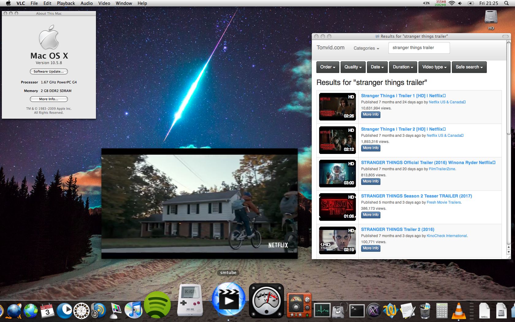

So, to recap, I just need to install the few apps/tools mentions in original post then "compile" the App? Is there a "pre-compiled" App I can DL from you that will work as long as I have the aforementioned apps/tools installed?
All appears to be working fine, tested with Mplayer, Coreplayer and VLC.
I've also used the SMtube icon and attached it here, along with the compiled app.
Many thanks again to Lastic and G4fanboy for prompting the update.
