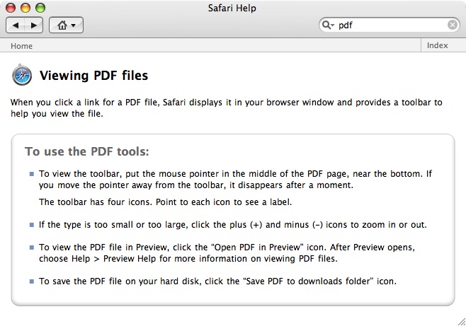

Shouldn't the finalized version of Safari 3 have the pdf toolbar? In the helps files, there's an article that describes how to use it, but I have yet to see it. Any other 10.4.11 user know if it's there??
