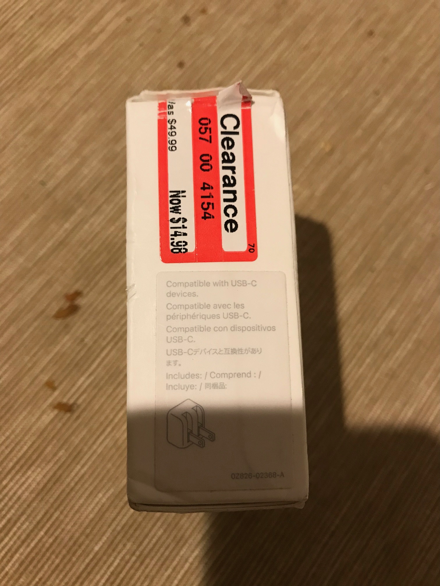

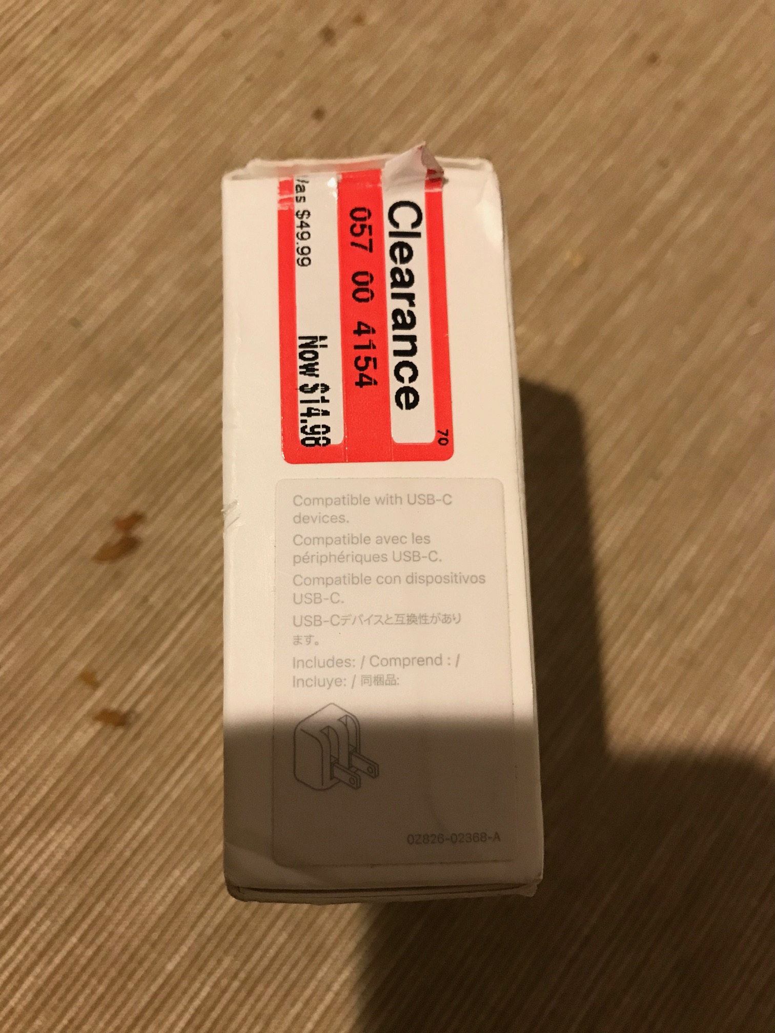

What seller? I just bought an 'OEM overstock' from ebay for $11, - http://www.ebay.com/itm/Original-Ap...&s=ci&page=main:email&cal=babe87f035949&cust=
I picked this up @ Target tonight, so now I needed a cable to go with it.
I’m in the UK so it’s a different seller.
However the 2nd picture showing the barcodes on the side is an exact match of the fake I received.
i can’t tell from the 3rd picture whether the cable is thicker than a normal USB cable, but overall I’d avoid it and just buy it from Apple.
