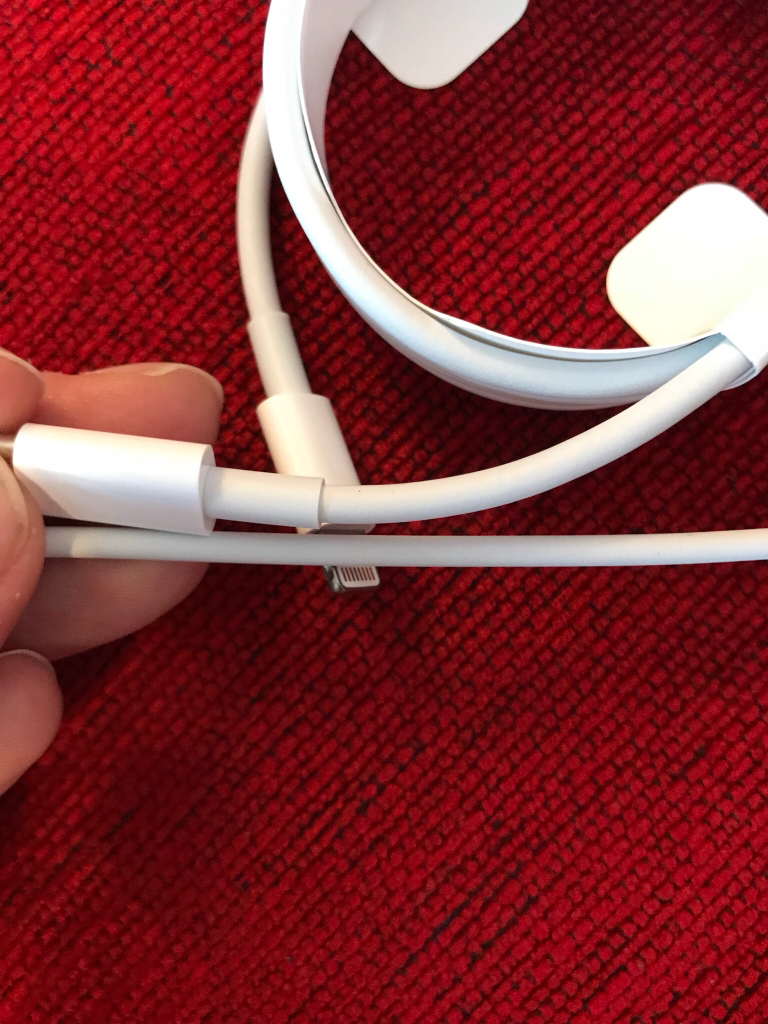

As noted in my posts earlier, I was having issues getting fast charging to work.
Turns out the USB-C cable was a fake.
The packaging is identical, it’s only when comparing against the thickness of the official cable and the adapters on it that show the difference.
The fake even has the right text printed on the cable itself.

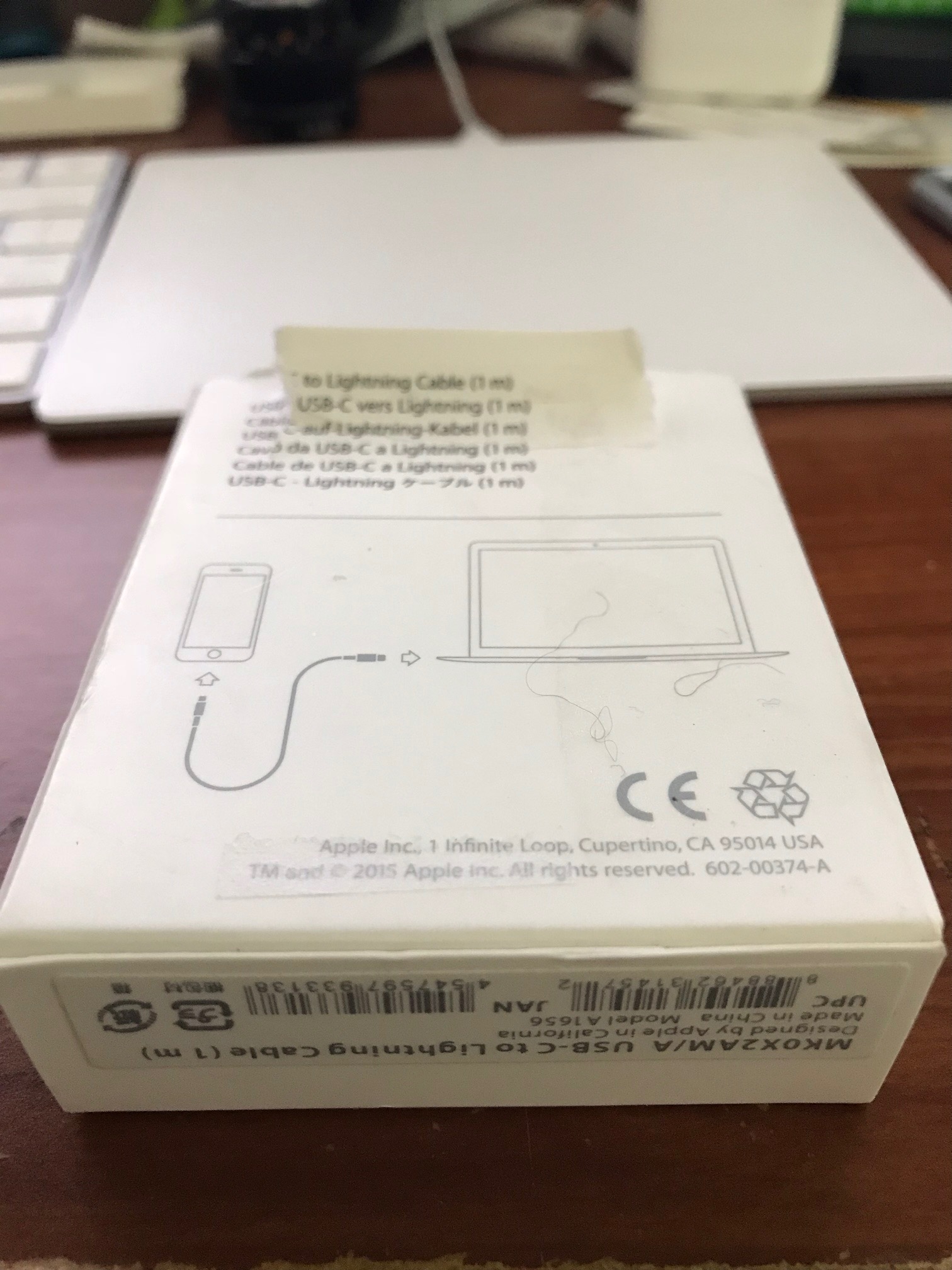

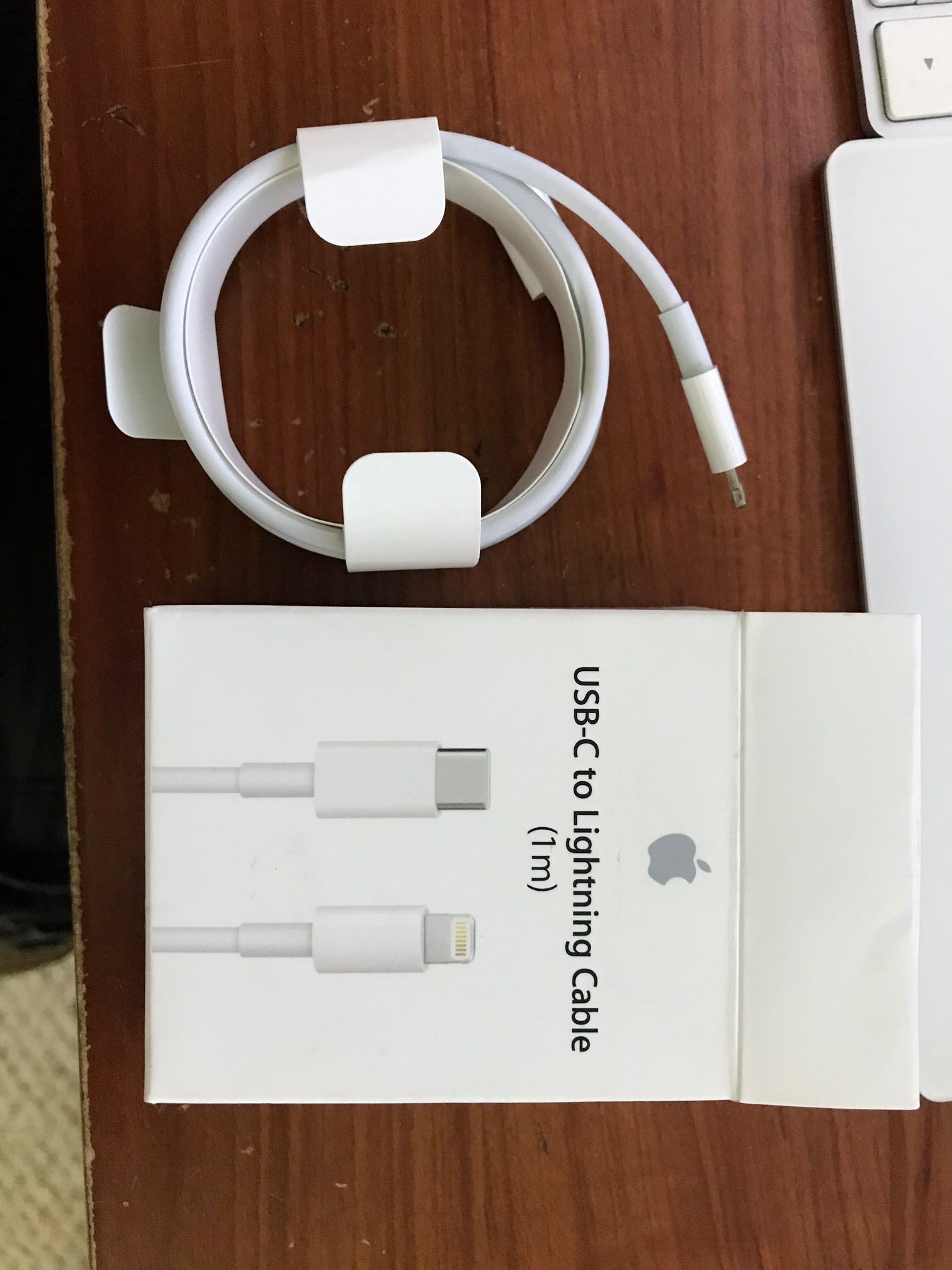

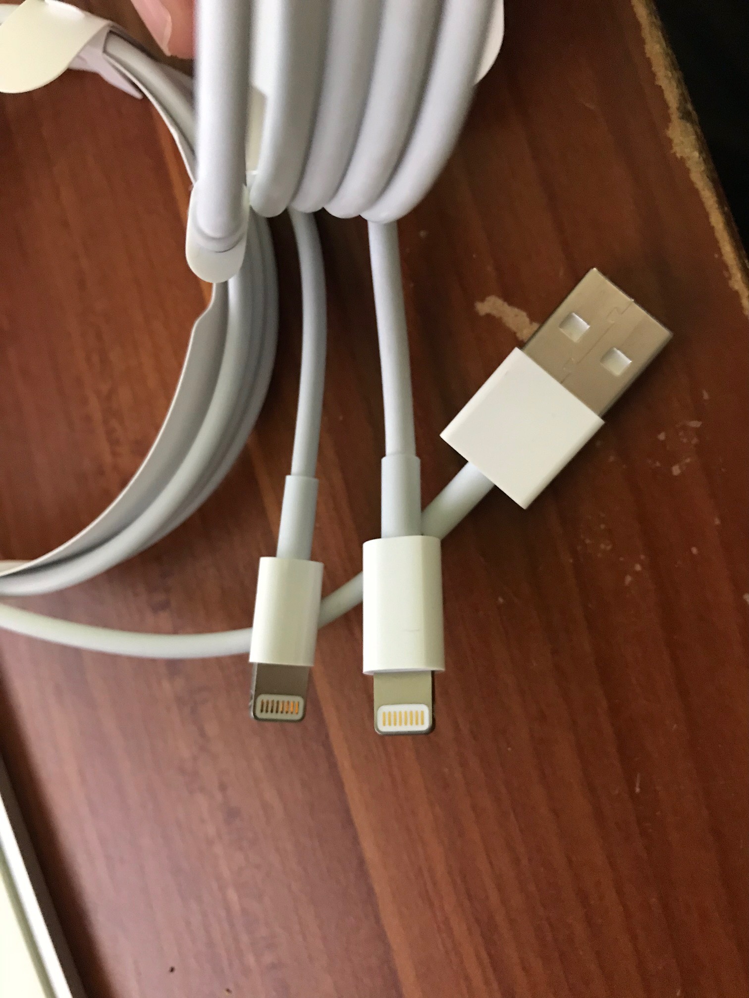

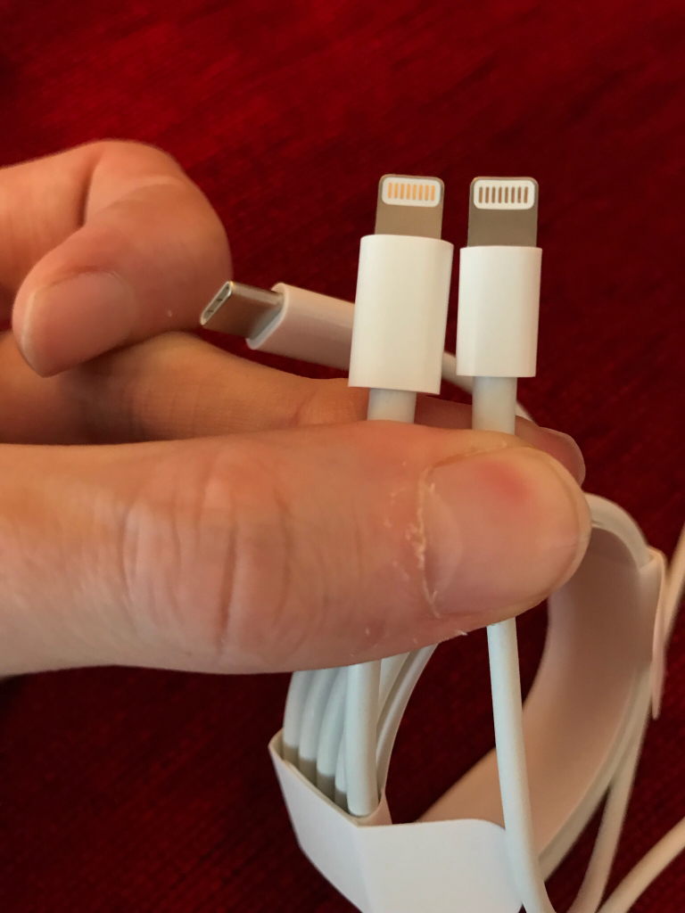

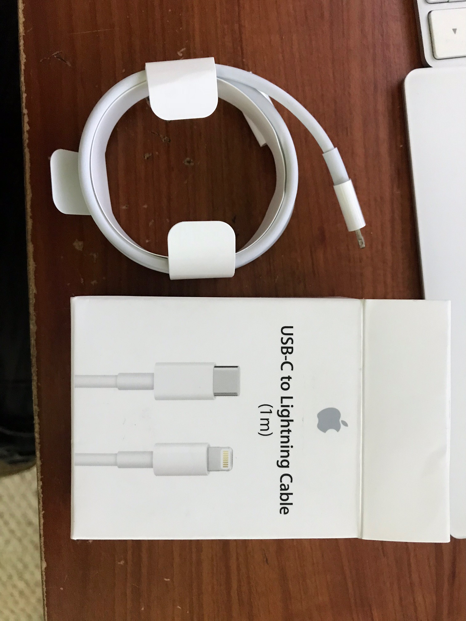

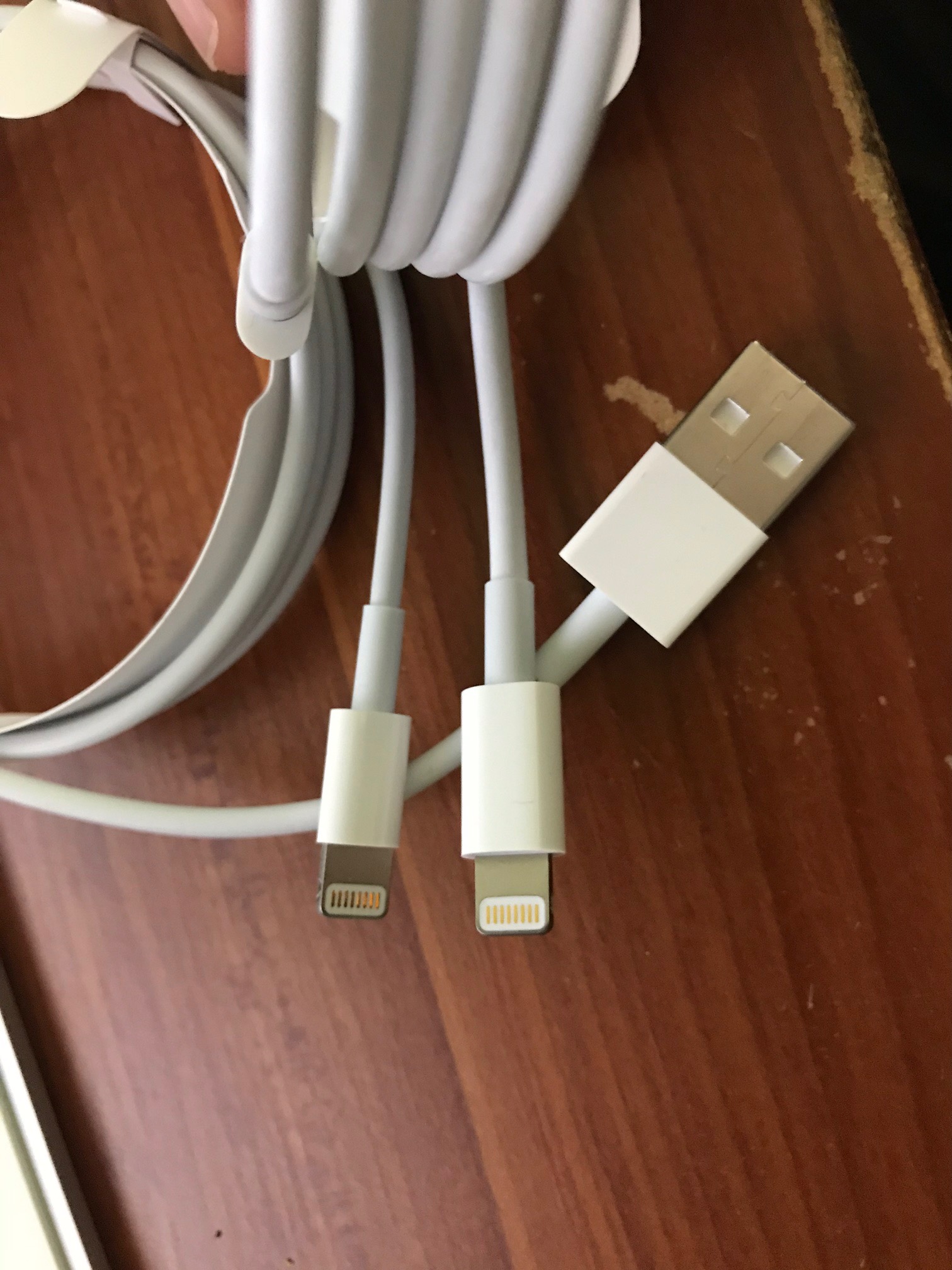

Got my ebay cable. Box and packaging are spot on, even has the 2 manuals, and the cable wound up. Compared to my USB Cable that came in the ipad box, the USB-C to Lightning cable is a little thicker (wattage increase?) and the connector is a touch larger. Only thing that says 'Fake' to me was there was a white dust / powder on the cable when I straightened it.
Thoughts? Should the lightning end be the same size as the USB lightning that came with the ipad?

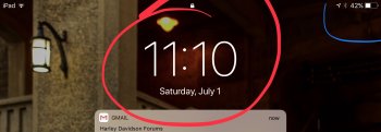

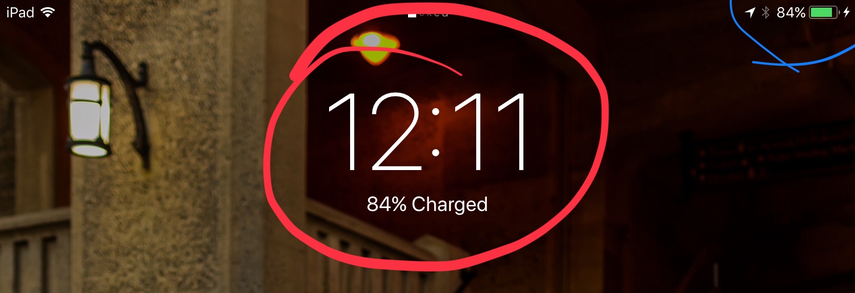

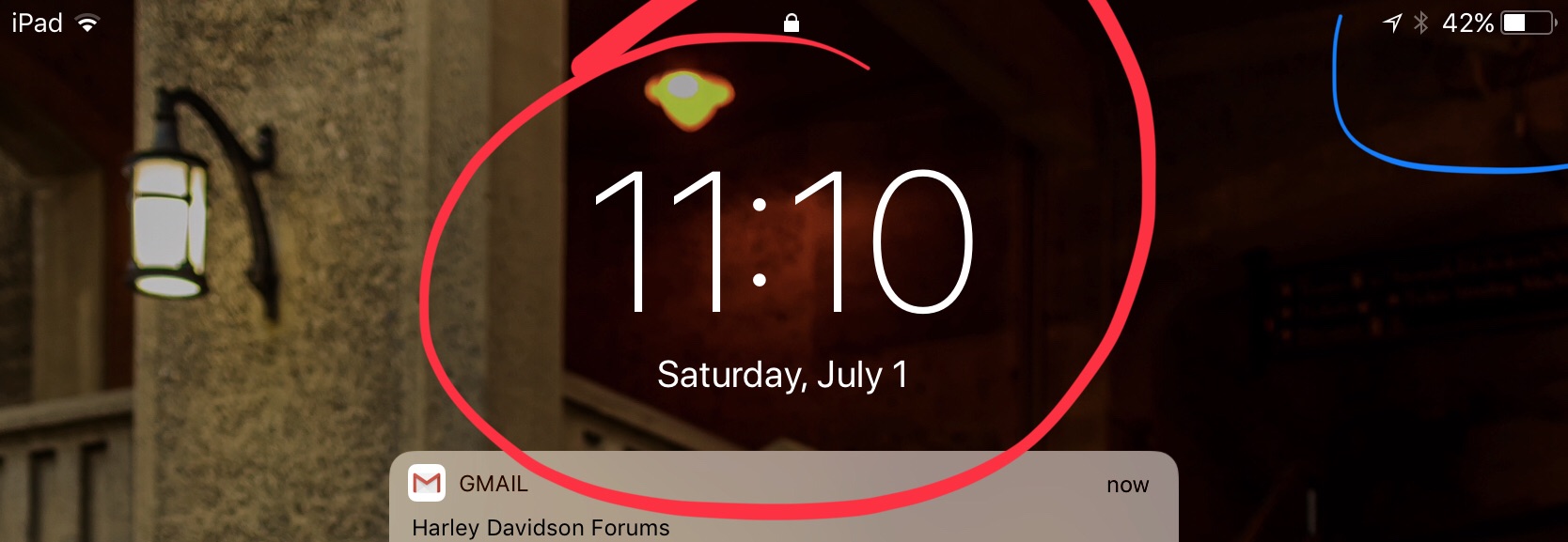

well i just plugged it into my power meter, and its charging @ 88% battery, with 25/21W so I guess thats good! 😀

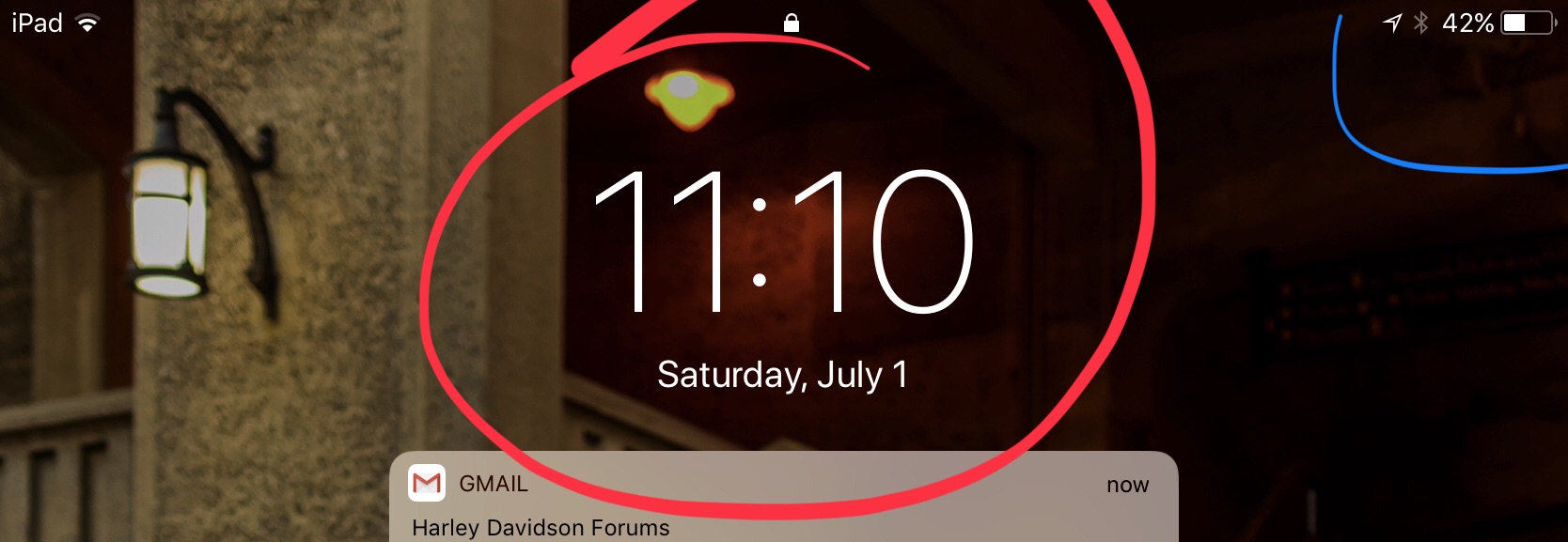

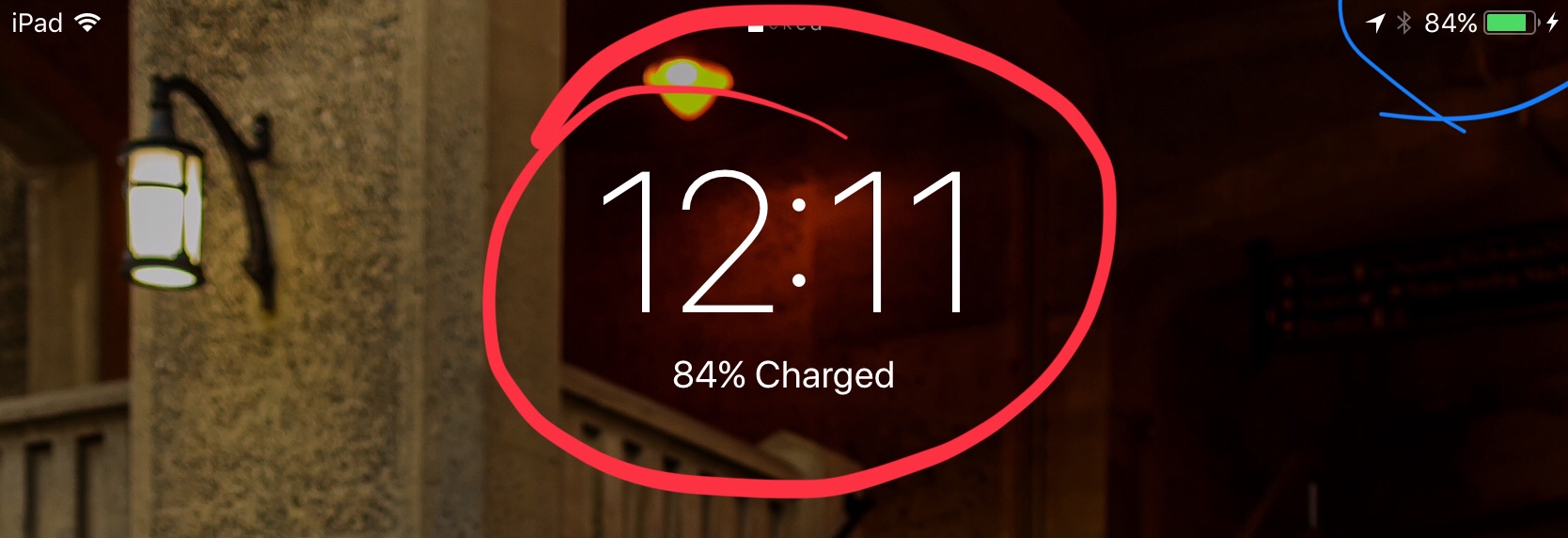

Well seems my eBay cable works well. Doubled my 42% charge to 85in an hour.
Can you provide measurements of the plastic bit on the lightning and usb plugs of the original cable please?
I had an eBay fake and took it to an Apple Store and bought a genuine cable.
The genuine cable should not feel the same as a normal USB-A lightning cable. The cable itself is thicker and therefore harder to bend.
The lightning end is also bigger on the original.
My fake wouldn’t charge at 29w.
Thanks a lot for this. My 2x Amazon refurbished cables look genuine then. The cable is thicker, and the plastic of the lightning plug is about 1mm wider and 2mm longer
