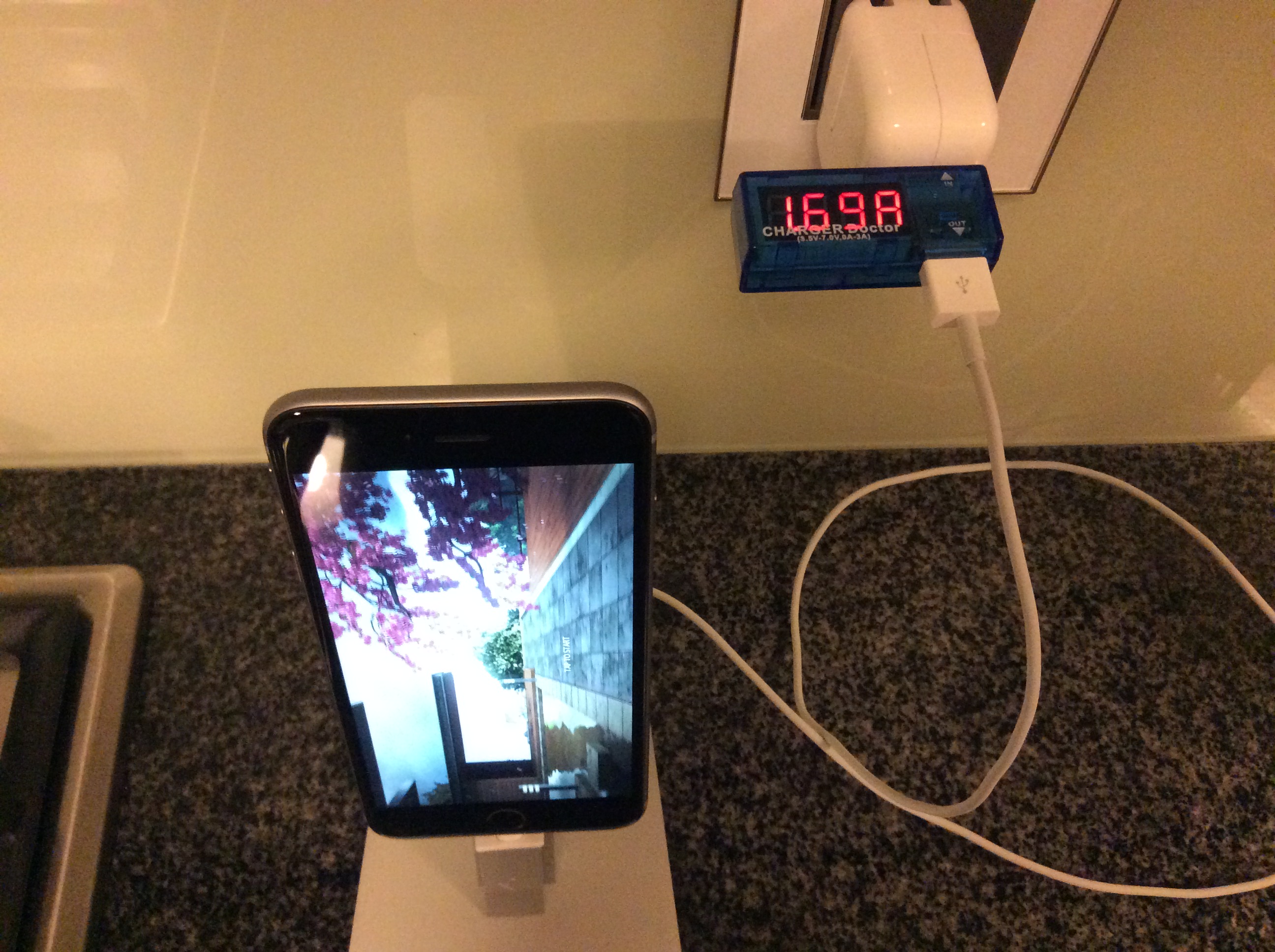

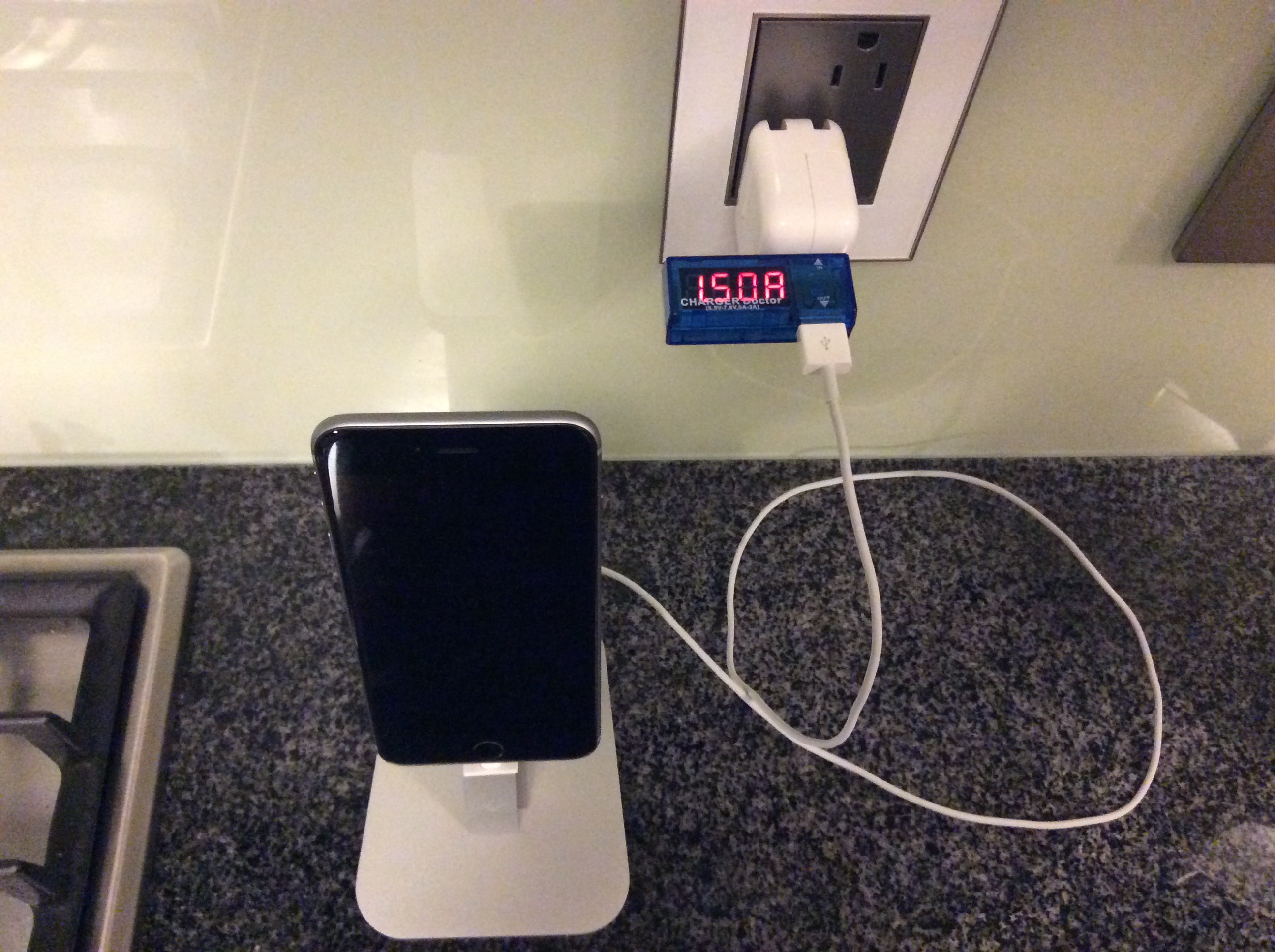

I tested my iPhone 6 Plus again from about 53% charge using a genuine 12W charger and lightning cable.
Screen off - 1.5A
Screen on running Zen Garden - 1.7A
I'm not sure why my previous result only showed 1.3A when charging from around 60% the last time. Perhaps just bad luck or a glitch.
Proof attached.
Screen off - 1.5A
Proof attached.
