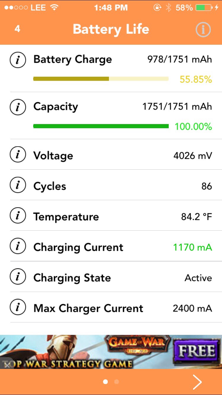

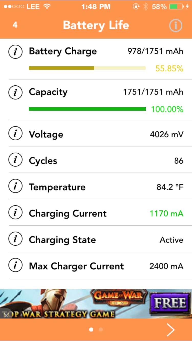

I went out and bought a 12W charger from Walmart, it's made by Gryphon and it has a 2.4 rated output. They included their own cable but I stuck with my Anker 6ft cable.
There is a significant difference in charging times compared to the included Apple charger my 6+ came with, it only takes an hour to charge compared to 2+.
The trade off is it weakens the touchid sensor while in use. But I only charge my phone at night with it, during the day if I'm about to go out or something after work I'll use the apple charger.
I think a higher watt charger helps but looking at this it goes a lil over 1.1 amp even though the charger can do 2.4

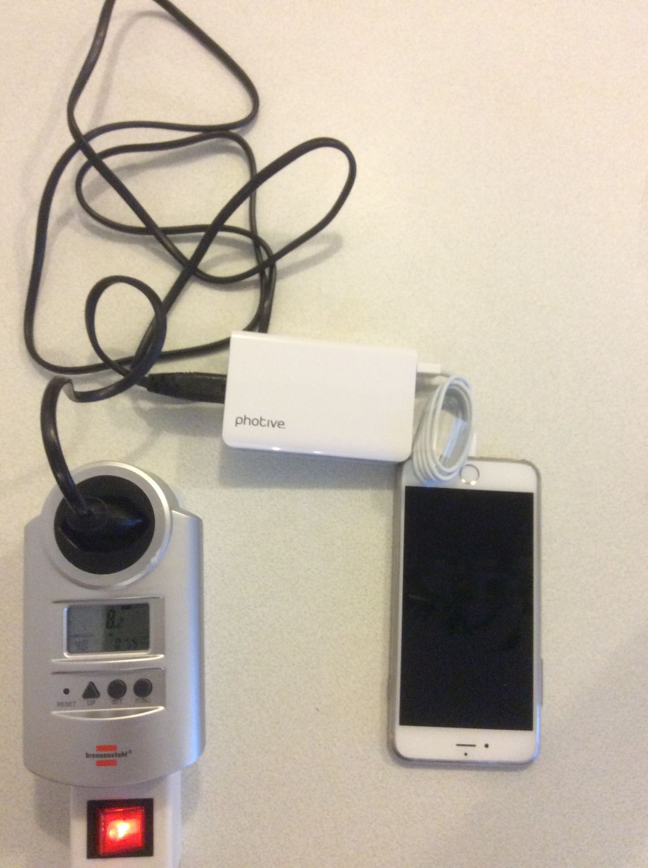

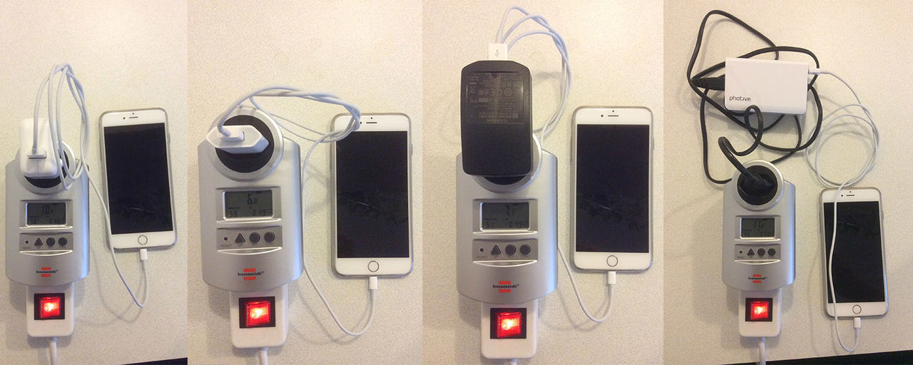

My iPhone was between 48% and 51% battery level while taking these pictures. An original Apple Lightning cable was used.
1) 12 watt original Apple iPad Air charger - 10.4 watt
2) 5 watt original Apple iPhone charger - 6.8 watt
3) 5 watt garmin gps watch charger - 7.1 watt
4) 25 watt 5 port photive charger from amazon - 11 watt
Now compare the wattage sucked when I use a cheap china lightning cable (not one where you get these "This accessory may not be supported." warning!)
Cheap china lightning cable (from sw-box) - 8.2 watt
The iPhone 6 plus charging controller seem to recognise the fake cable..
So the iPhone 6 plus charges faster using a >5 watt charger, assumed you use an original cable. Charging speed won't double, but it's definitely faster.
Thanks for reading.
