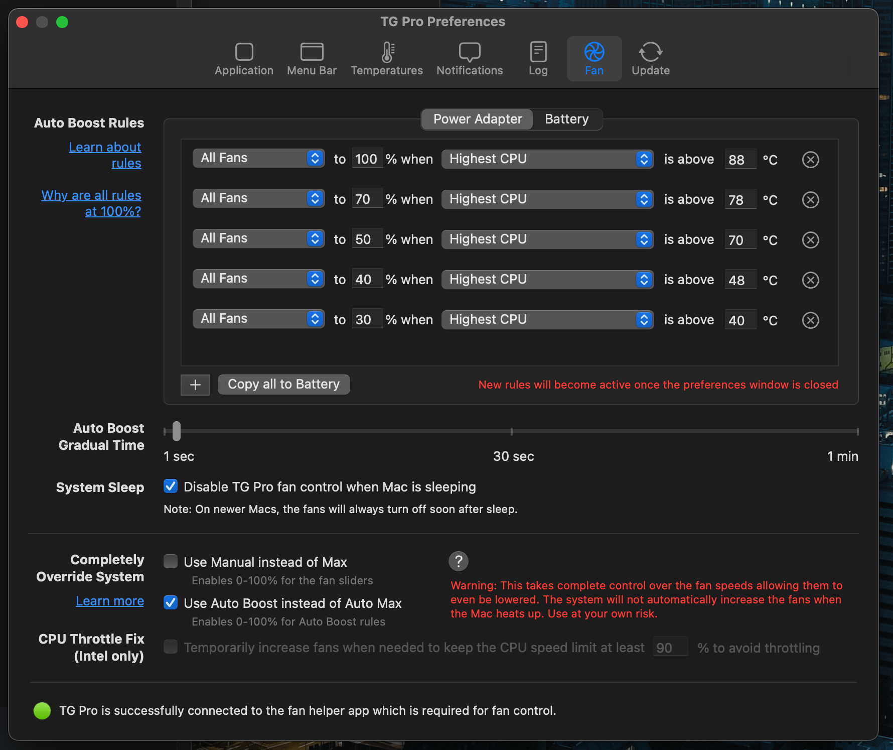

I set the rules like this.
Will see how this behaves and will adjust gradually till it works like I want it to.
**changed 40% to 55C and seems much better.
All normal stuff (few safari tabs, trading window and Spotify) and I'm in the 50-53C

If you want, you can adjust the fan curve in TG Pro by configuring it to use "Auto Boost" and setting a fan % speed at temperature thresholds.

I'm in trial mode of TG Pro 2.61 and I only see 100% fan in auto max at CPU temp; it won't let me set a curve (like 3000 RPM at this cpu temp). I should read the instructions before using this app lol.
You need to check "Use Auto Boost Instead of Auto Max" in order to change the fan percentages. Will run the benchmark and report back with temps.

OK I'll try the "use auto boost" and see if I can mess with the speeds.
