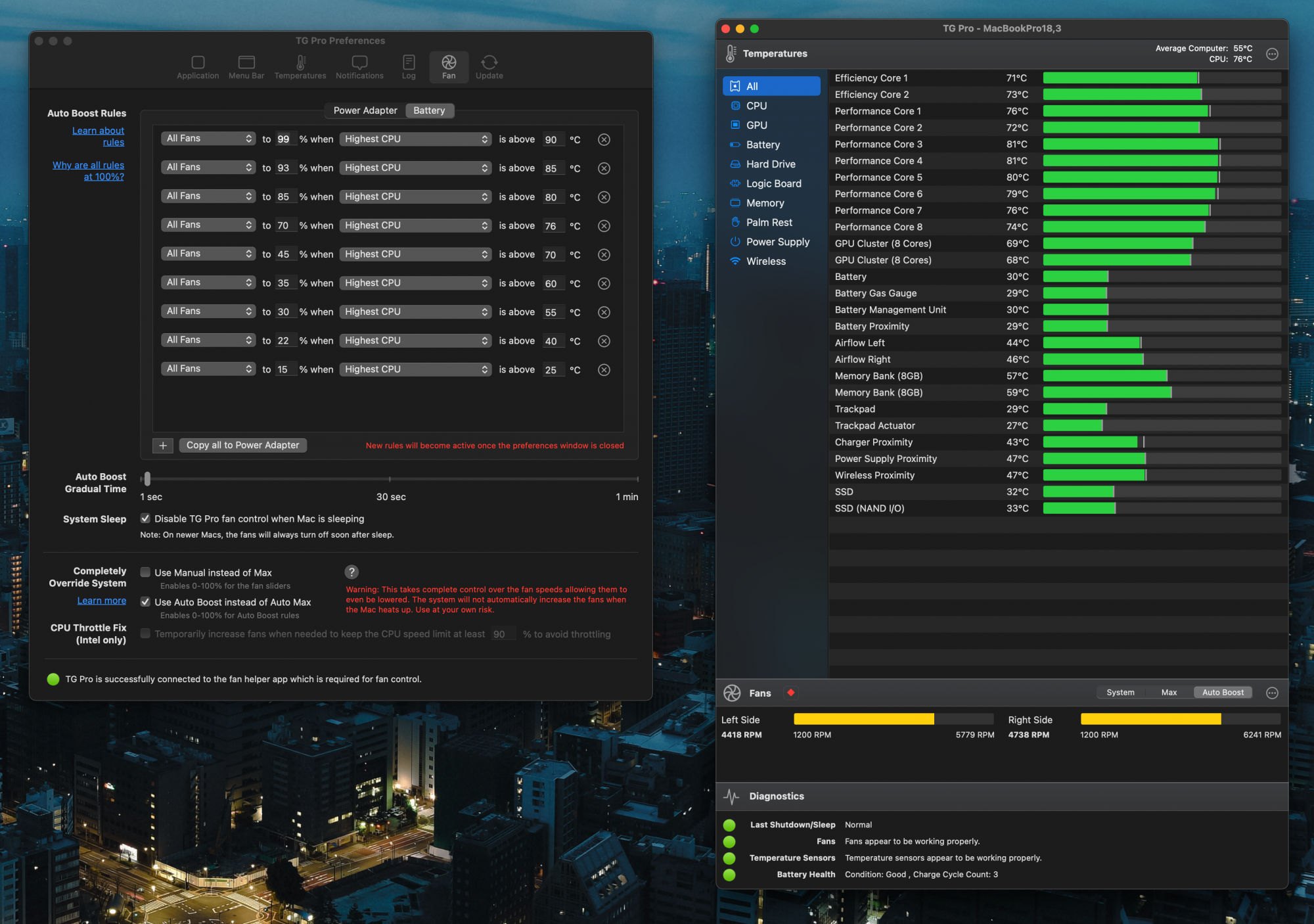

Last test and I'm done cause I'm obsessing about It lol
With this settings max temp was 82C on multicore, connected to power and the fans didn't go past 85%
I'm quite happy about it.

I just showed that by using simple custom fan settings I was able to lover temps by approx 18 degrees C in 100% usage multicore stress test. That's almost 20% drop. Deliding CPUs doesn't even bring that kind of gains.
Without it, default fan settings allow the temperature to reach very high numbers.. Do you know what happens to objects that are exposed to temperatures like this for prolonged periods of time? And it's not just the die. Everything around it as well.
I don't know M1 PRO's throttle limit but i DO KNOW that thx to my solution I'm never going to reach it thus have access to full CPU power whenever I need it. This right here is everything I need to know.
