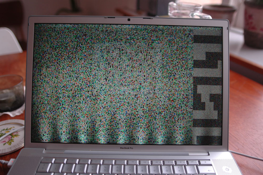

I took a pic of it, but yes, they did try to reproduce the issue, and of course it did not do it for them. I noticed it happened mostly when my battery was running hot. Take a pic of it next time it happens. This problem is more than likely to reoccur again.

Had a weird similar looking problem with my mbp 2,4 penryn. Twice my screen looked kind of messed up after I woke it up from sleepmode. The stripes are there, but the screen is kind of strange. Talked to Apple about it, but there was little help.
