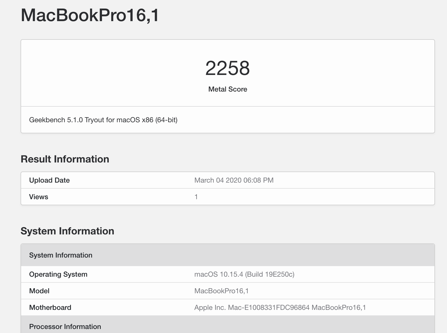

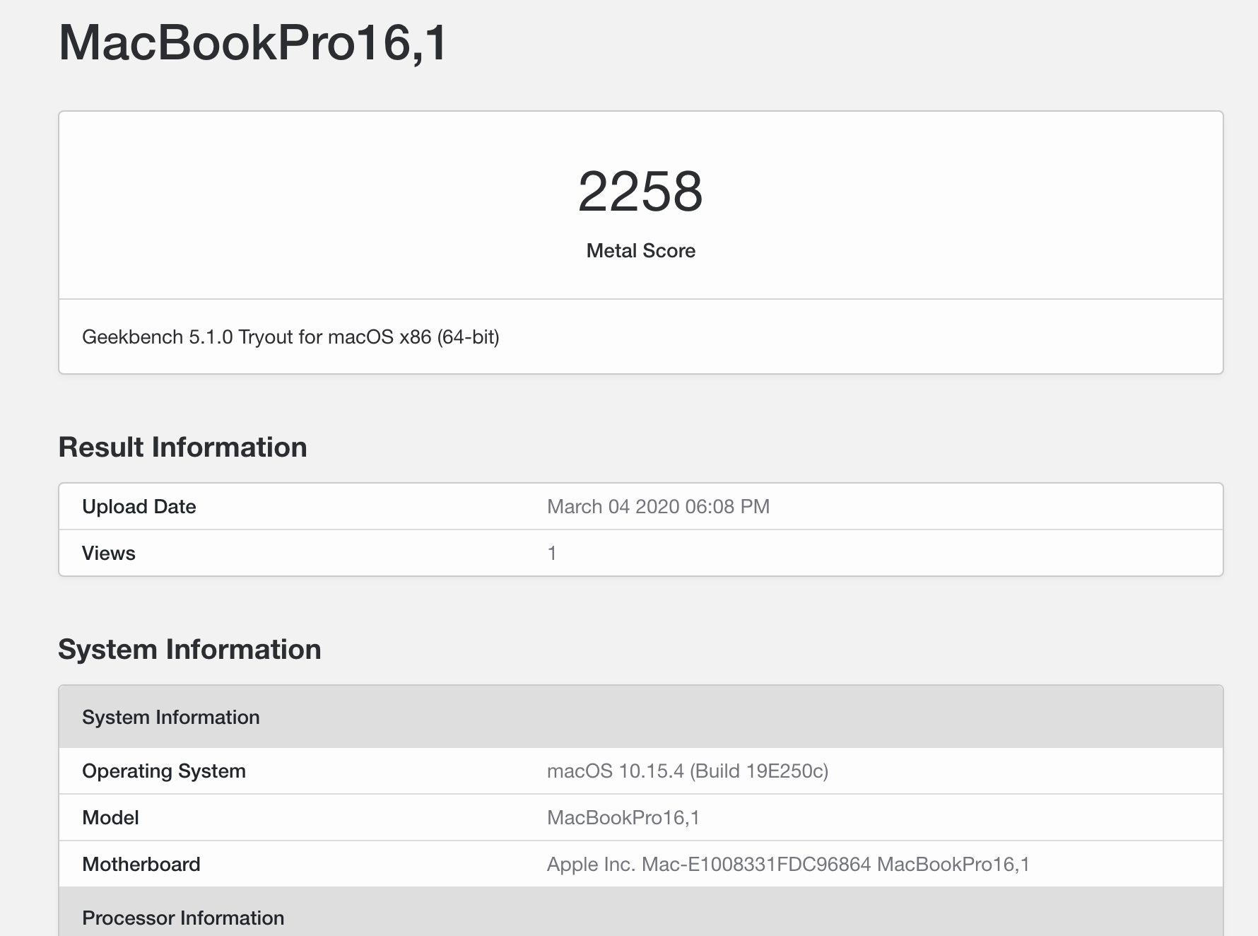

Nice new LB... Geekbench was run. Got the errors that others got under 10.5.3 which is normal and to be expected for that version. NO panic!!! So its good. I have a good running machine at this stage.
If you get the panic, please run your serial number at the website as shown earlier in the thread to check your MFR batch number (year/week). I can attest mine for March has the issue resolved.
This is 'philux' from apple forums. My 3rd machine was a board replacement, bringing me to my 4th. The 4th is exhibiting the same issues with absolutely nothing plugged in and bare minimum software.
My machine also arrived yesterday and has the exact same date and factory info you posted above. The fact you seem to have zero issues is comforting. It came with 10.15.2 installed which I found strange (?) so I've decided to just use it and stop worrying over all these issues. I've also decided I'm not going to bother updating my machine's OS until 10.15.4 is released as 10.15.3 looks to be a pig with the 16" MBP even though in the release notes part of the update was to address some issue with this machine.
I did G5 Metal test using Intel chipset, lots of errors in console but no kernel panic.
Hi philux... welcome to where we can answer you without fear and retribution from Apple moderating comments. 🙂
Are you getting your hardware from Apple or a fixit location? You probably need to go straight to apple. Check your serial number in the website listed earlier and find out the manufacturing date. What you need to do (which has been moderated at Apple) is escalate the issue to the executive team. You do this by emailing Tara Bunch - head of Apple care (tbunch@apple.com) or Tim Cook (tcook@apple.com). Explain to them your issue and how disappointed you are. Those emails get caught by the executive team and then they begin getting things done for you. Be sure you list your case numbers at it helps them with your history. This is how I ended up with a brand new machine.
[automerge]1583332287[/automerge]
You are good to go... no hardware issues and just ned the new Catalina version.

Hi! I put Catalina 10.15.4 beta version 4
Nothing changed
I did not have a panic, but I experience constant freezes
Geekbench5
Also constant errors in the console
virtual void IOAccelEventMachineFast2::checkGPUProgress() - Signaling hardware error on channel 8..
void IOAccelEventMachine2::signalHardwareError(eRestartRequest, int32_t): GPURestartSignaled stampIdx=2 type=2 prevType=0 numStamps=64
void IOAccelFenceMachine::fence_timeout(IOTimerEventSource *): IntelAccelerator prodding blockFenceInterrupt
IntelAccelerator driver returned kIOReturnNotReady for transaction [ID=8900, IOSurfaceID=5]
IntelAccelerator previous NotReady transaction [ID=8900, IOSurfaceID=5] sent. kr=0x0

That is not true, i have a base build i9, 16GB 1TB, 5500M 4GB with freezes, kernel panics. And with the geekbench test i got the same errors with Intel GPU. Also low geekbench score. I have 3 days left to return....
Yep you're right turns out my Macbook was a base model as well. We have a similar model - mine has 32gb ram.

@visualinventor Is there any chance this is a Geekbench 5 bug?
Have you ran Geekbench 4 and got the same errors?
I ran GB5 on my 2017 Macbook pro and there wasn't the same issues and the GeekBench score was 4000+. I don't believe it's Geekbench but I will test more in depth tonight when I get my machine back. You can refer back to that post on the apple forums. It could be Catalina since my 2017 was on Mojave (but I kind of doubt it).
Nothing changed
Geekbench5
