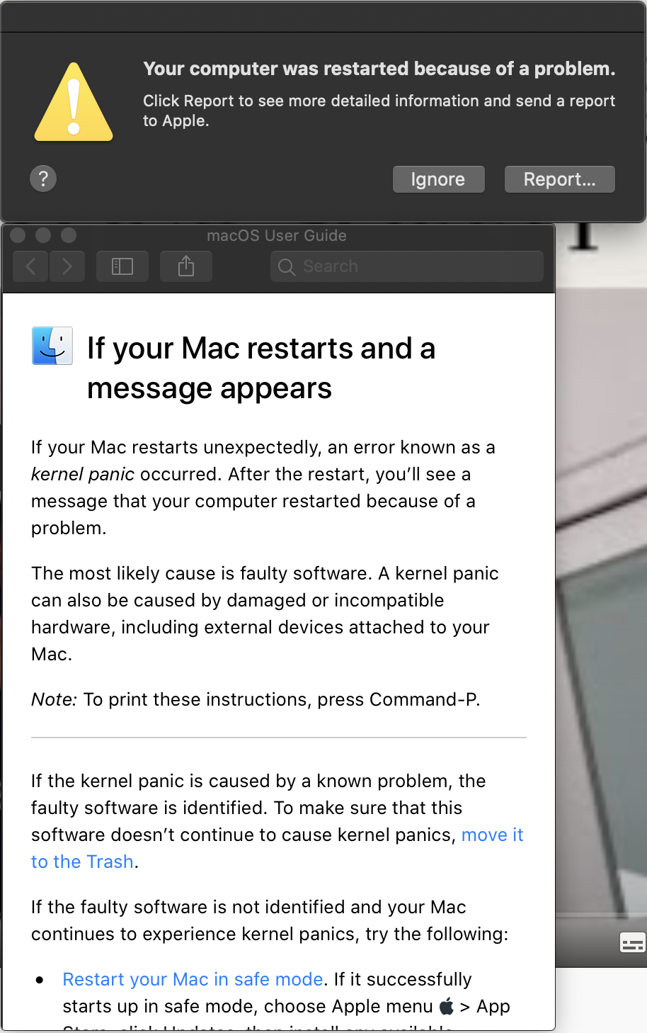

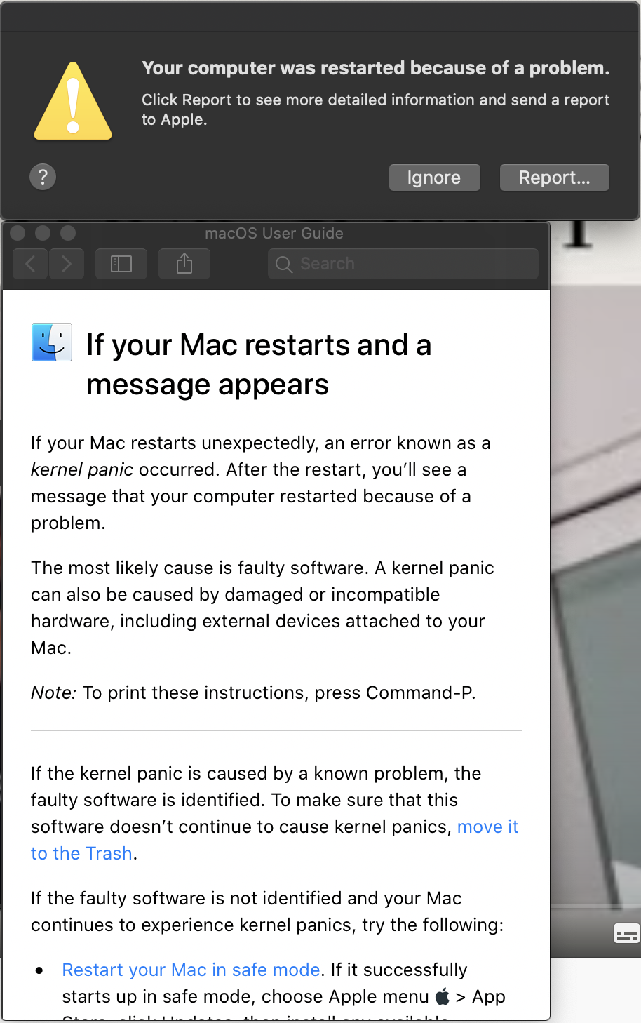

This has happened to my MBP16 several times over the last few weeks but with increasing frequency. Until today I only ever saw the problem when returning to the MBP in the morning to start work. Overnight (while sleeping) it had restarted. So I had to reset all my apps / windows before getting to work. A right pain in the ***. Today it happened when I went to make a call. MBP went to sleep. Came back, mouse pointer moving around OK but no apps responding. Main menu not responding. Nothing. A minute later the mouse pointer disappeared followed by a considerable "whoosh" noise from the fan and the MBP restarted. Error report on re-start duly sent to Apple. For the 4th time this week.
Does this sounds like what others are experiencing? Reading the thread I think so. Also worth noting that I never experienced this problem before I connected my MBP16 to a new Philips 346B ultra widescreen monitor that is USB-C, so I power the MBP via the monitor using USB-C. I also read on this thread that some think connecting via USB-C monitors / docks may be causing the issue.
My MBP16 - 2.3GHz i9 ; 32GB RAM ; 1TB SSD ; AMD Radeon Pro 5500M 4GB.

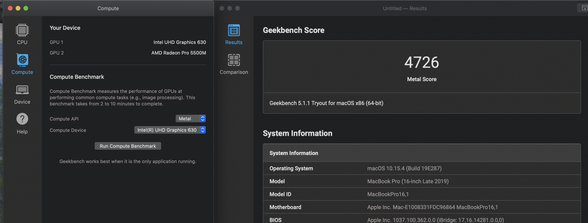

So today I had my first "Powerplay failed to resume" error. Out of curiosity I ran the intel test earlier today on GB5 and did not trigger the cpu panic. So I think we can rule that out as a means of reliably triggering the test or at least it did not in my case. Besides a couple bad magic crashes which occurred when plugging in peripherals, I haven't had any GPU related issues with this computer I bought in December. Im really hoping this is a driver issue or something related to 10.15.4 since it seems like its a different issue from the one OP discussed. Piece of **** update and they will never fix the audio issues either. When it finally comes time to buy a new computer Im' going Windows.
dang it - same problem here. Just ran GB metal on IGPu. MacBook restarted.
panic(cpu 0 caller 0xffffff7f983594c2): "Graphics firmware encountered an exception (eip: 0xddf5, fault #: 0xd)\n"@skl/sched3/IGGuC.cpp:865

Edit: with fans at 100% it went ok with GB 5 test
Edit2: test with default fans also went well. I've run it now multiple times, no probs at all - I mean it slows down to the point where it is not usable but it does recover after a 45sec or so.
5500m 4GB worka ok on both GB 4 and 5. Not sure what to do next. whether I should return it or keep it...dang it 😖

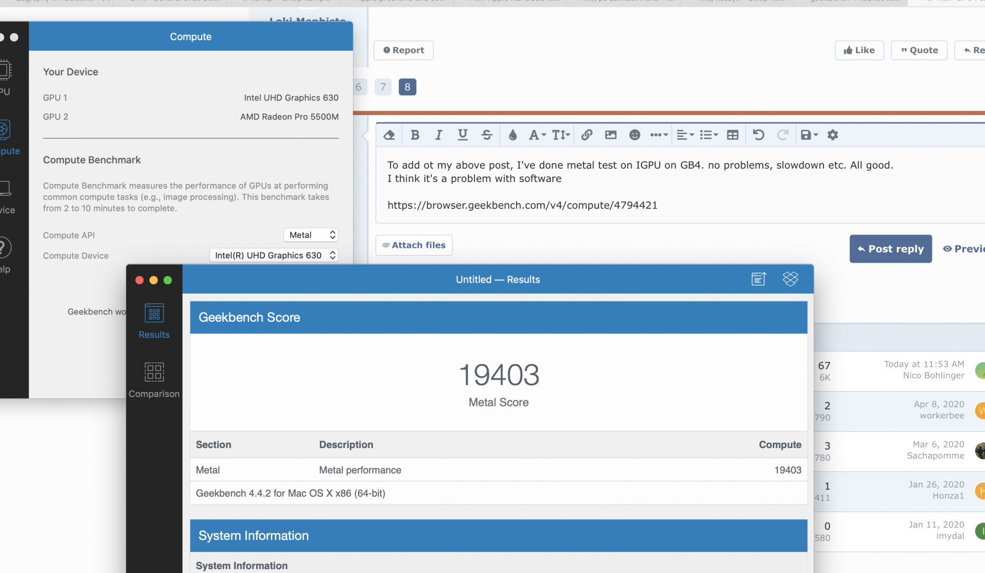

Does any of you knows if this is a bug with OS/GB or a hardware issue? Error suggest a bug in the igpu FW
To add ot my above post, I've done metal test on IGPU on GB4. no problems, slowdown etc. All good.
I think it's a problem with software
