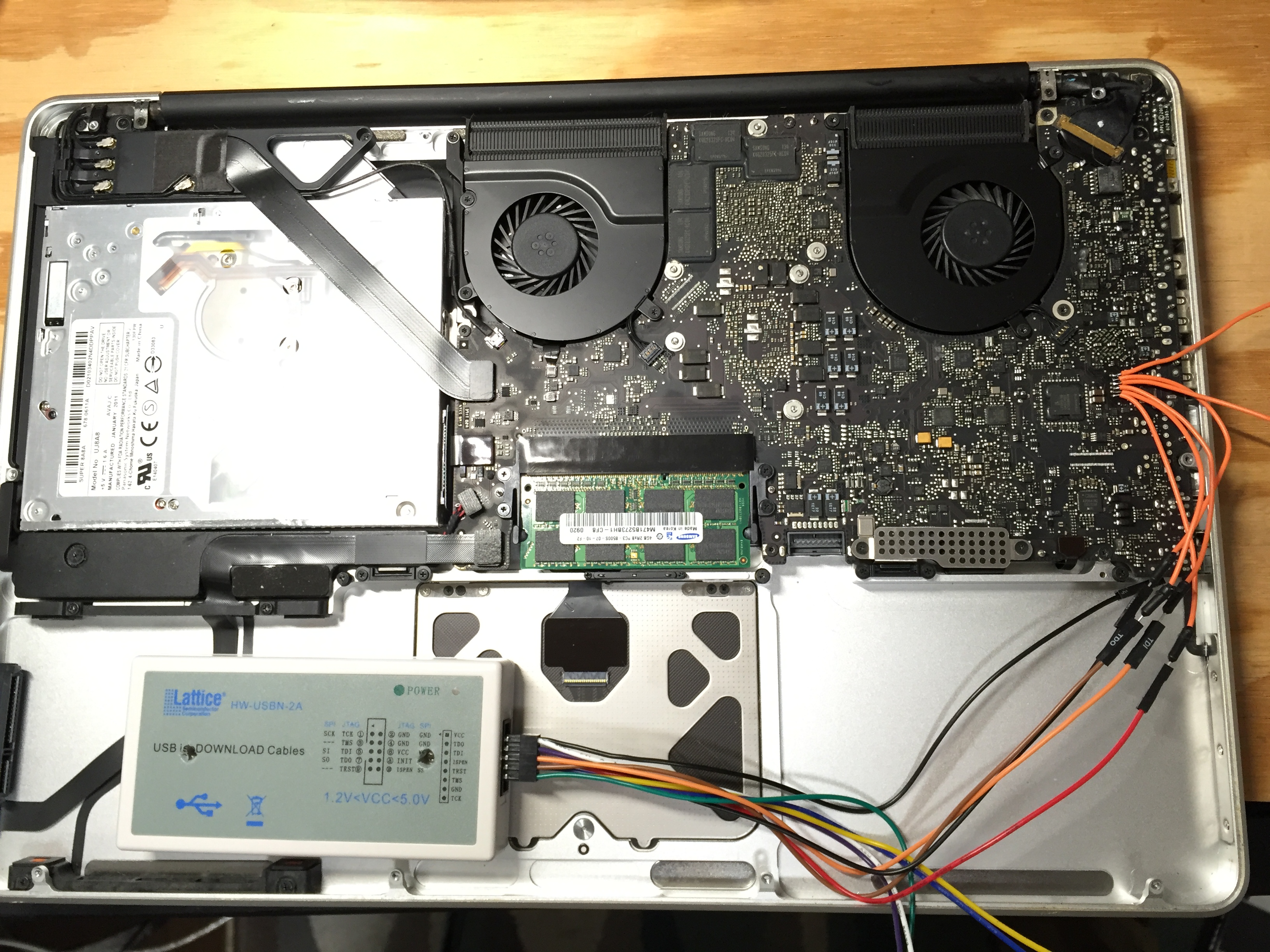

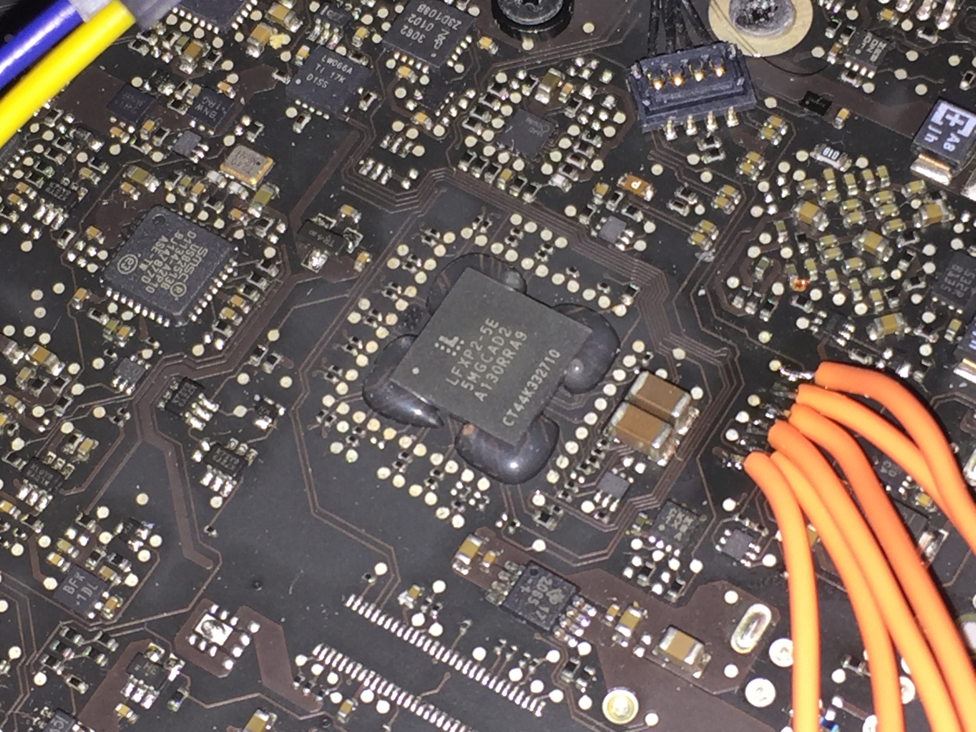

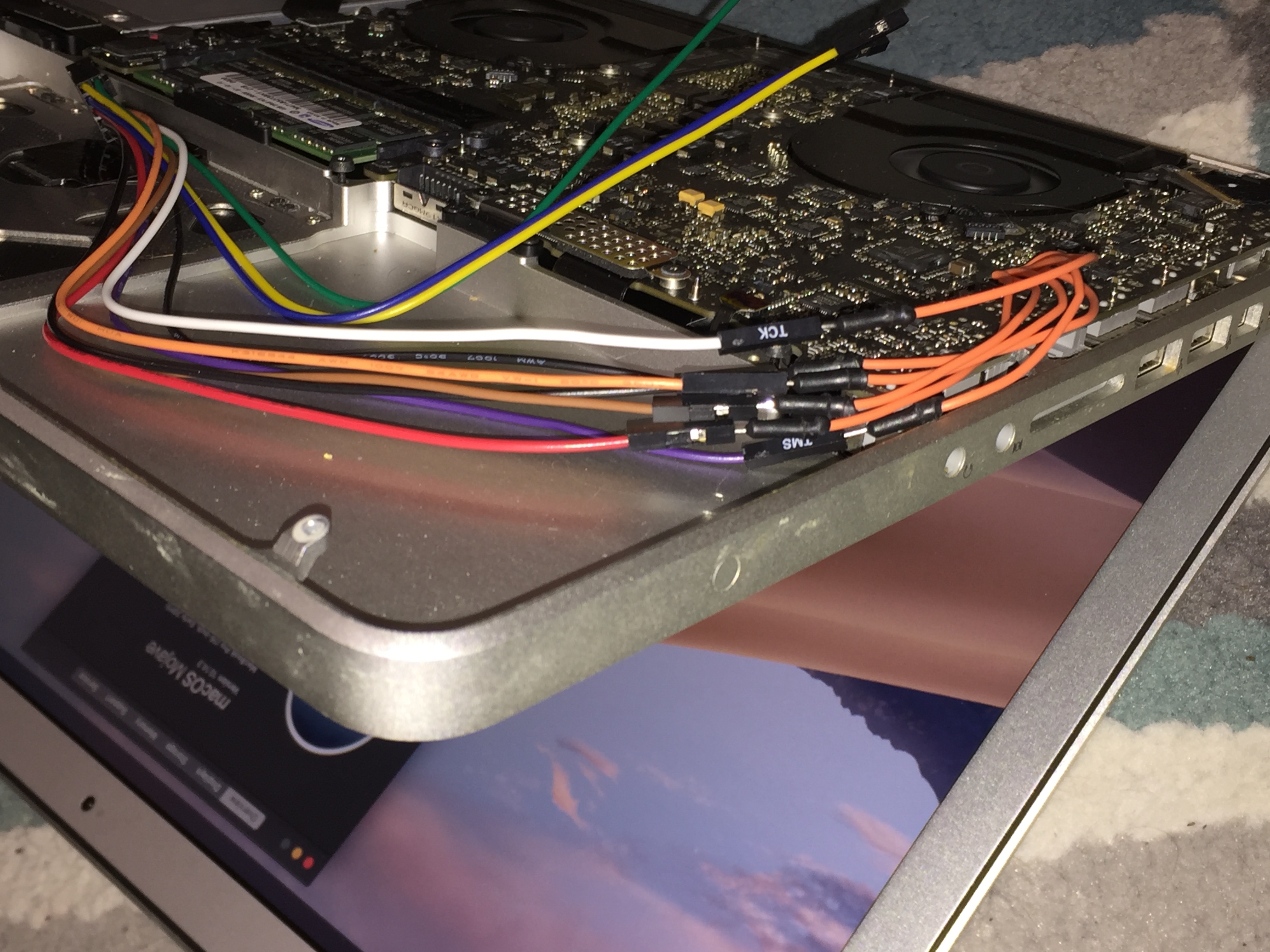

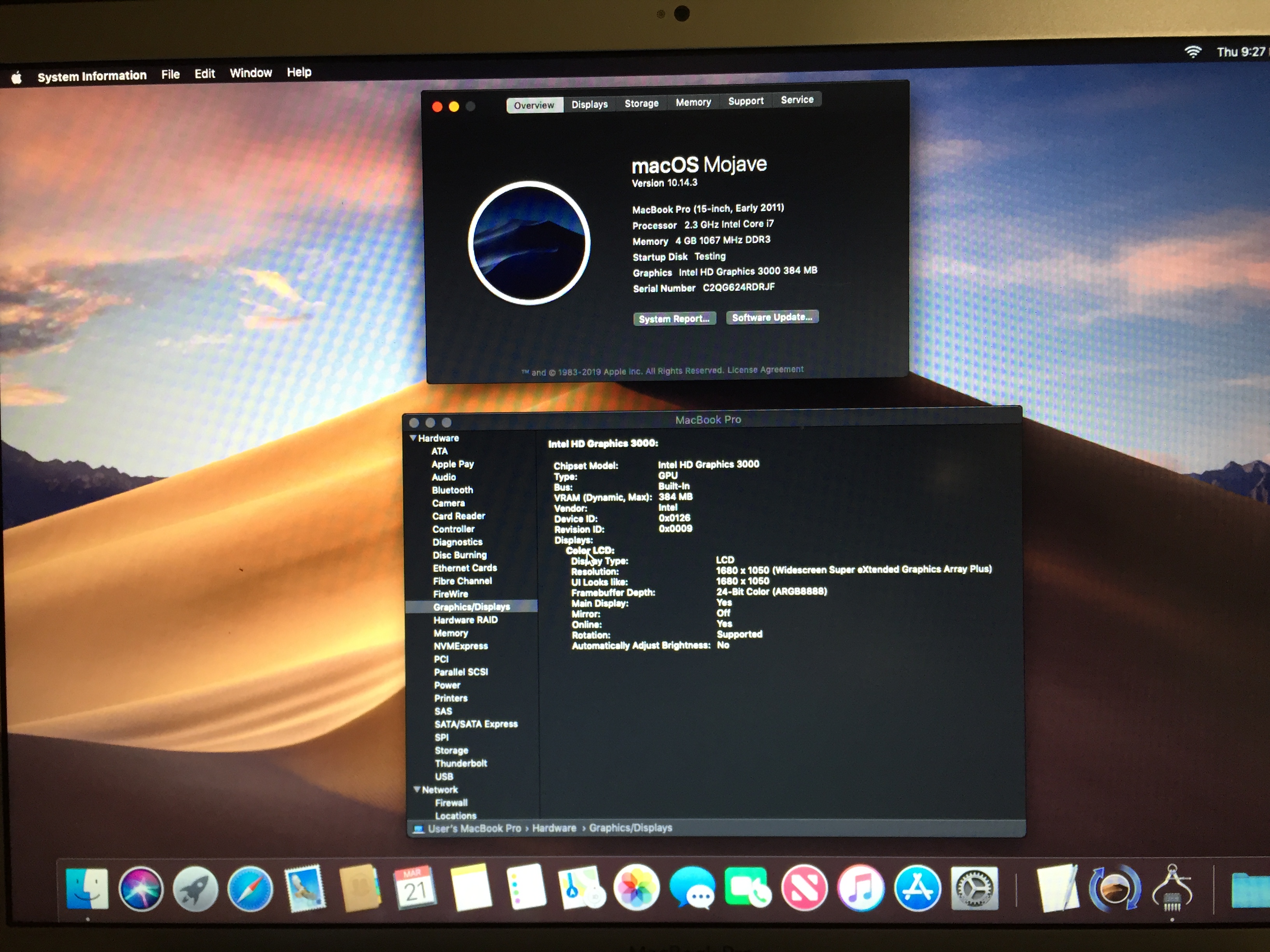

Actually, I'm working on a new, EVEN BETTER solution that requires no board modifications at all... Reprogramming the gMux IC. Already made decent progress, but haven't gotten it quite working just yet.
And, after a ton of work and research, we have success!! No backlight brightness control implemented yet, but everything else works perfectly! The system runs great with NO hardware modifications, NO special NVRAM/EFI variables set, NO OS modifications, and the dedicated GPU PERMANENTLY disabled!
View attachment 827631 View attachment 827632 View attachment 827633

"NO hardware modifications", doe that mean no need to have a hot air station to install a MuxHat ?
