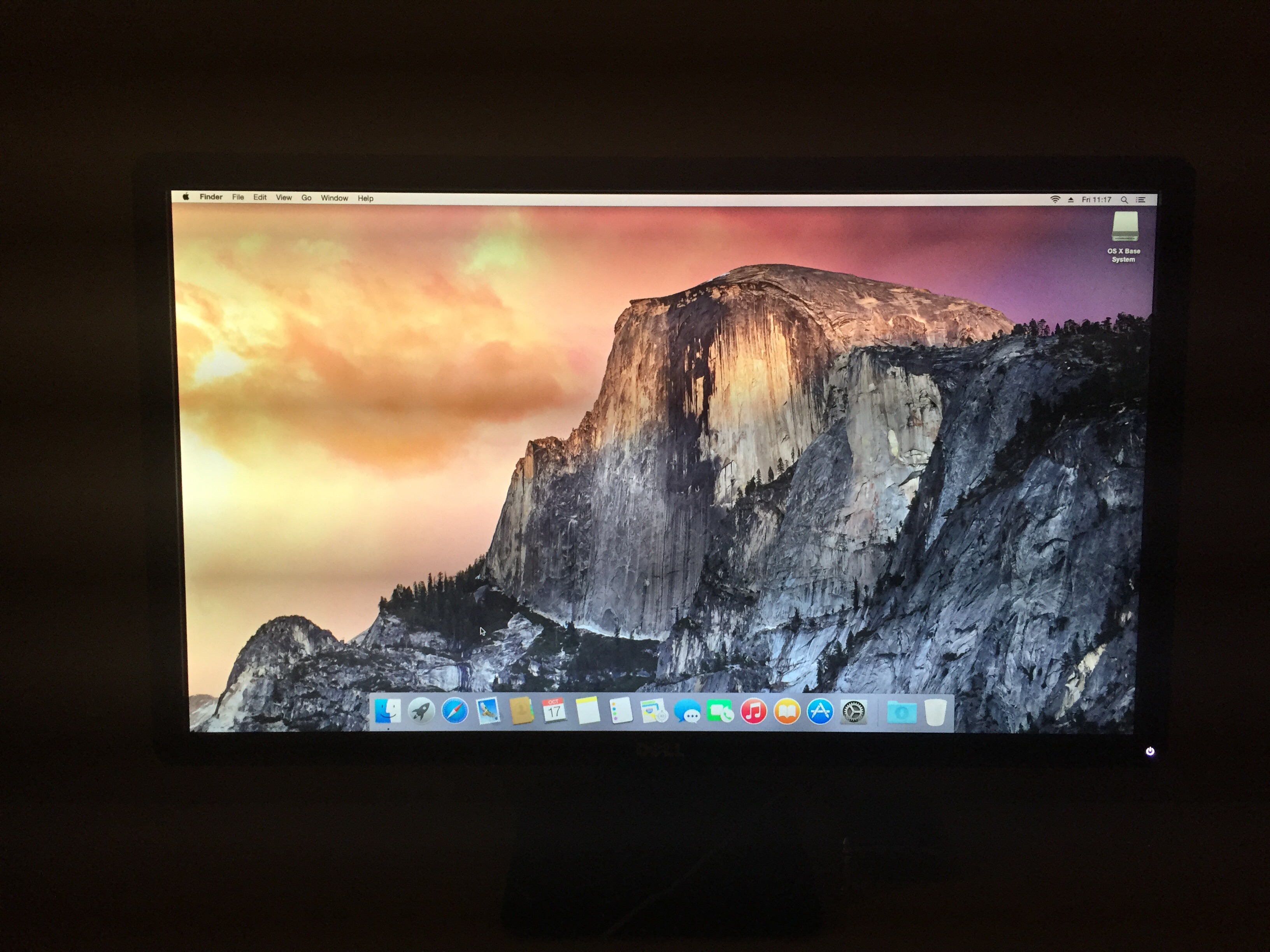

We've got a couple of Mac pros in the house: one is a 1,1 and one is a 2,1.
Interestingly, the USB installer I built using the guide in this thread worked just great with the black boot.efi file and our Mac Pro 2,1 with HD 5770.
Our older mac -- which we use as the server -- didn't want to boot at all with the black boot.efi file. It has a GT 640, so I never expected any boot logo to show but I did expect it to blind boot to the installer window. (That's what it does with mavericks)
However, it wouldn't boot until I replaced the black boot.efi file for the grey one. And Voila! Nicely done.
Thanks to everyone who has worked so hard on this. My 2006 Mac Pro 1,1 lives again -- complete with its scarily large RAID 0 array ;)
Nikki.

You should do the firmware flash to fix the unknown processor in About this Mac.
