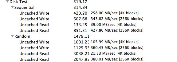

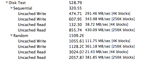

I have two C300's in a RAID 0 in my late 2008 MBP. The speeds seem okay, but the boot time is almost a minute. I've set the startup disk, reset PRAM and SMC. I'm not sure what's going on, but I don't reboot that often, so I can live with it for now.

100 MBytes           340.478 MB/Sec     119.417 MB/Sec
Extended Ave         339.754 MB/Sec     119.817 MB/Sec
