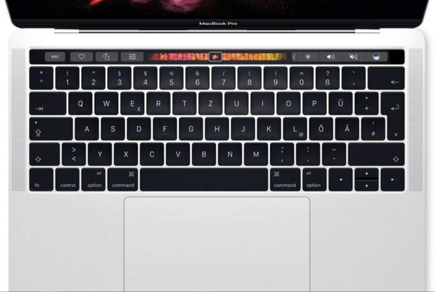

i found this strange as well, but my machine had a couple of issues, see https://forums.macrumors.com/thread...litch-freeze-can-someone-please-test.2129323/ ... had the german layout, looks like this. the keys did react alright in the week i had the mbp. the up and down keys just made (compared to all other keys) a very unpleasant, high pitched click which i found very odd..
