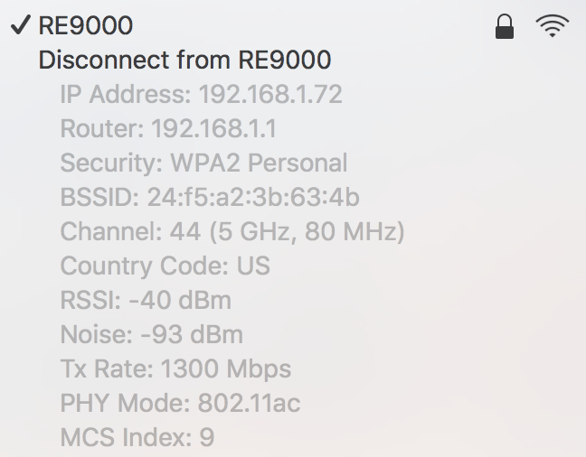

Today I picked up a WiFi extender, which I set up as a wired access point in my office (I was thinking of doing that anyway, to take advantage of the MBP's 3x3 WiFi, as the Velop is only 2x2). I specifically sought one out that, in addition to having 3x3 or 4x4, was NOT based on Qualcomm, and ended up with a Linksys RE9000 (4x4, Mediatek-based). Blazing-fast connection at the moment:
Let's see if the speed lasts!
Good call. Best of luck! It’ll be interesting to see how this works out. Please keep us posted.
Over 24 hours, and the connection to the new access point continues to be rock solid. At this point, I think it's fairly safe to say it has to be an incompatibility between the USI WiFi chip in the MBP (and iMP) and the Velop's Qualcomm chip. Netgear's Orbi also uses Qualcomm... I'd be interested to hear if any of those users are having these kinds of problems.

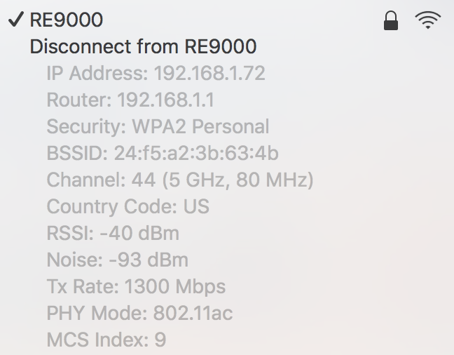

Thanks for the update. It would be interesting to see if Mojave had any impact too.
