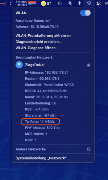

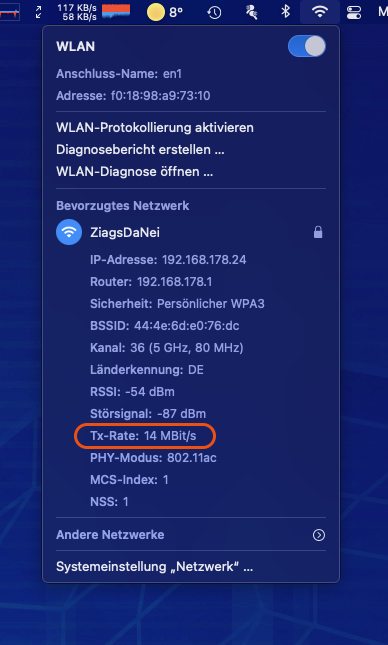

Yes, I've tested it, but unfortunately the bug remains. 🙁
I'm still using Sleepwatcher to restart my Wifi on Wakeup and an additional Launchd service to restart it every 30 minutes, which works pretty well. Disabling Unlock with Apple Watch did _not_ work for me, neither on my 2018 Mac mini nor my 2018 13" MacBook Pro.
