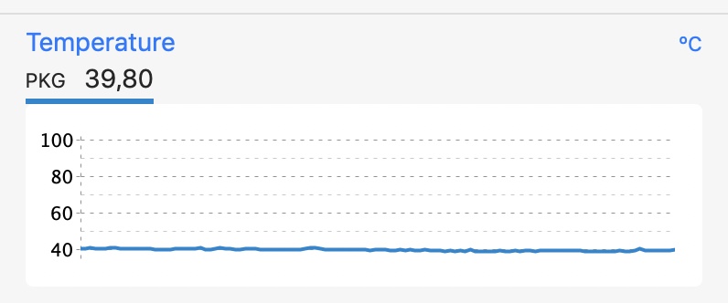

Temp idle stock:

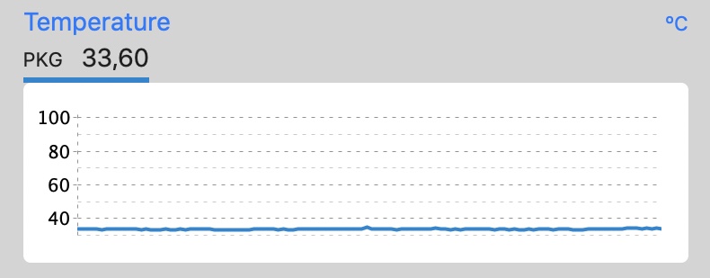

Temp idle Mod:

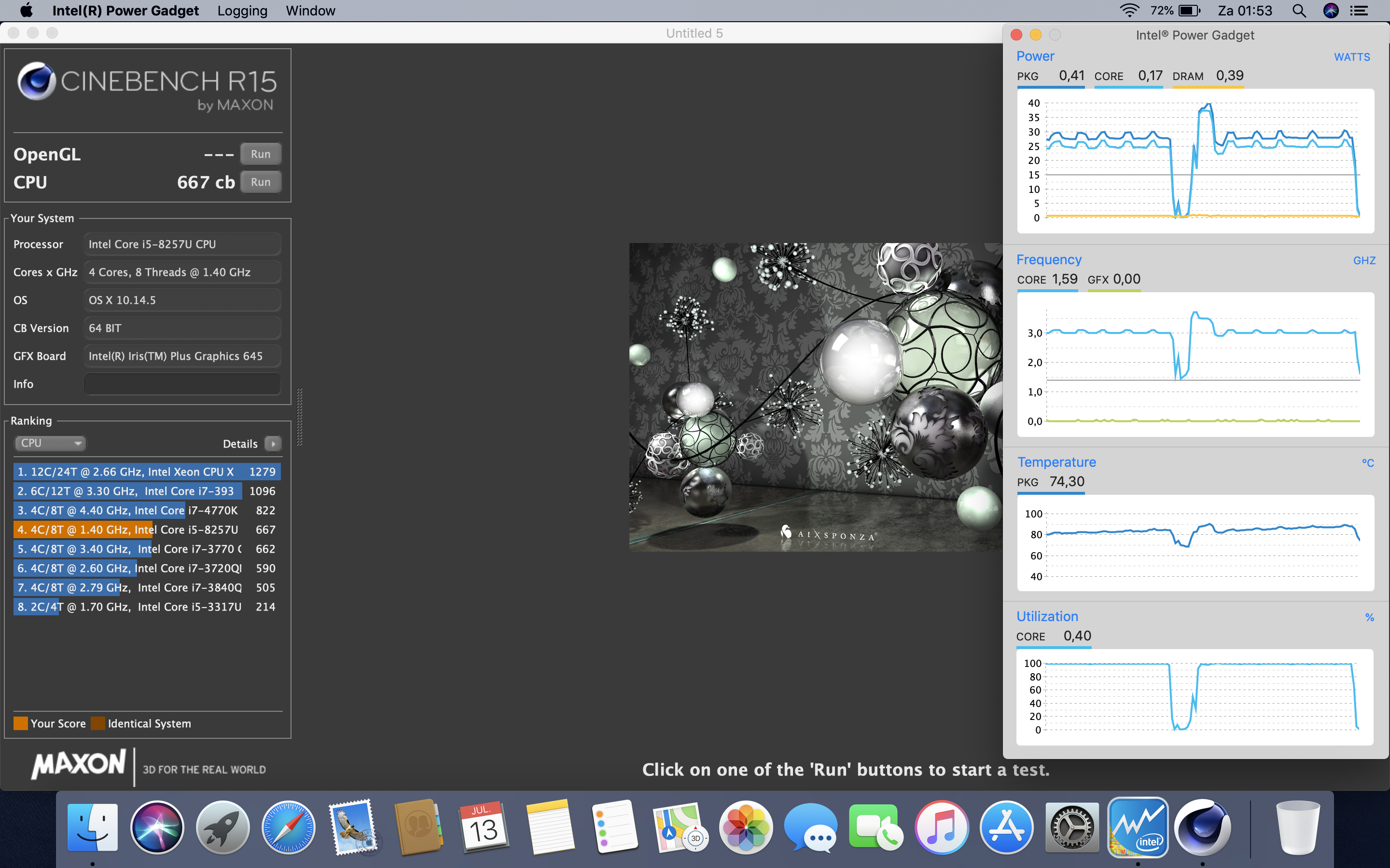

Cinebench R15
Run1 stock:
Run1 Mod:
Look at the temperature difference when compared to stock! As a result, higher peak performance.

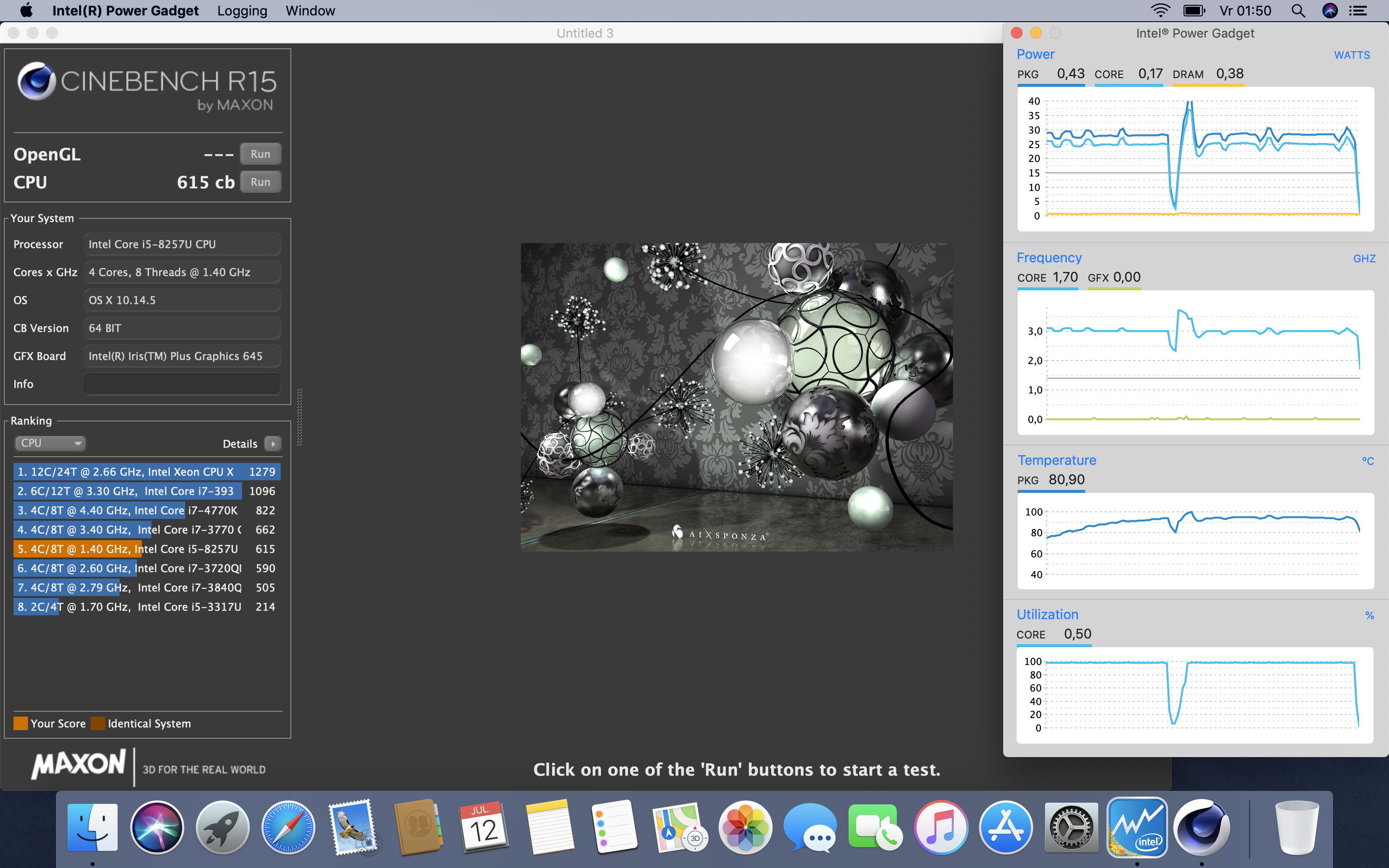

Run2 stock:
Chip got very hot and fan was not spinning. Score dropped significantly (to 615).

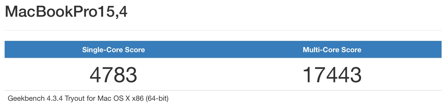

Geekbench Stock:

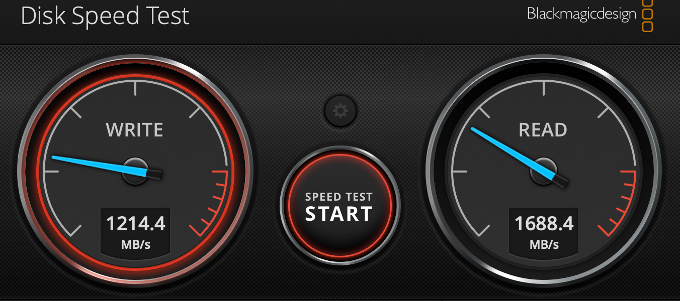

Reviews of the mid 2018 MacBook Pro with the 256gb SSD show read speeds up to 2500mb/sec and write at 1200mb/sec

Yes, there is probably less physical memory chips in 128GB model but still if I compare iFixit teardowns between Air 2018 128GB and new entry level Pro 128GB it shows that they both have 2 chips, so they use the same density NAND but obviously Air 2018 is faster (I have one and I have tested it even myself and I easily get over 1800 read speeds). Only difference based on iFixit teardown is the brand of the chips, Air is Sandisk and Pro is Toshiba.

That is much better in write speed (you used 5GB test size?) but still read speed under Air 2018 128GB. But still pretty poor compared to similar drives sold separately.
But still results for 256GB are rather poor if you compare it to any currently separately sold ssd pcie drives. They are easily 2x faster or more.
