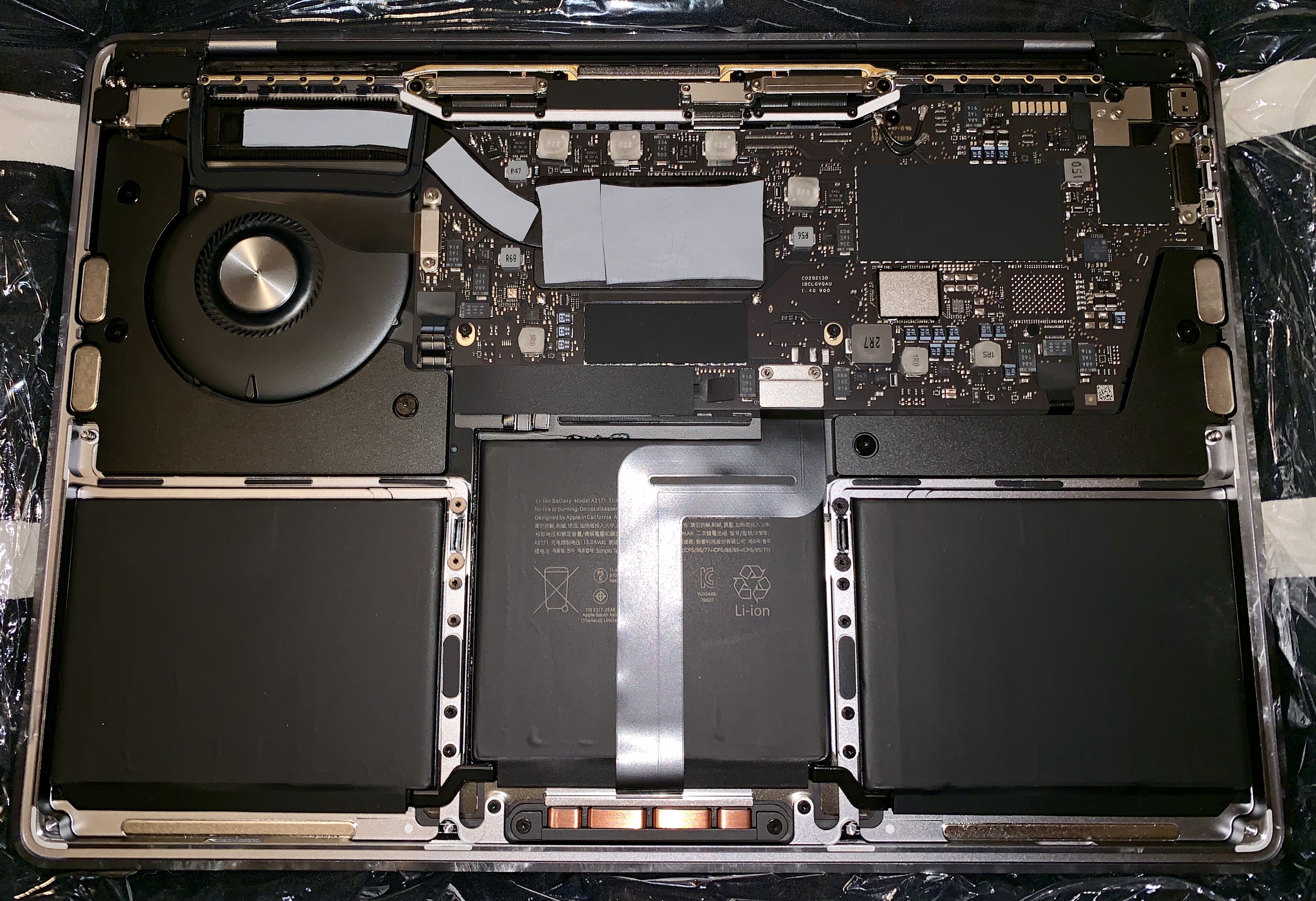

When are you going to post up some info and pics of this thermal mod?
thanks
Some pics for you sir. (The Mod doesn’t screw up your warranty, because you can always remove the thermals pads).
The bottom aluminum can get hot after running 20min Cinebench R15 (unrealistic torture), but will not burn you or anything.

Doesn’t that also transfer more heat to battery due to bottom plate getting hot after mod?
Not really, because the heat is only on the CPU and fan area.
Realistically speaking, I think the hot air inside the MacBook is more harmful to the batteries when compared to transferring the heat to the bottom aluminum.
Not really, because heat is only on the CPU and fan area.
So bottom plate is not getting any hotter in battery area after mod? Hot air is usually blown outside the case by the fan using heatpipe to transfer hot air to fan exhaust vent.
Battery heat is pretty easy to verify by using CoconutBattery where it shows the battery temp. If you compare battery heat before and after using the same test method should give some advice.

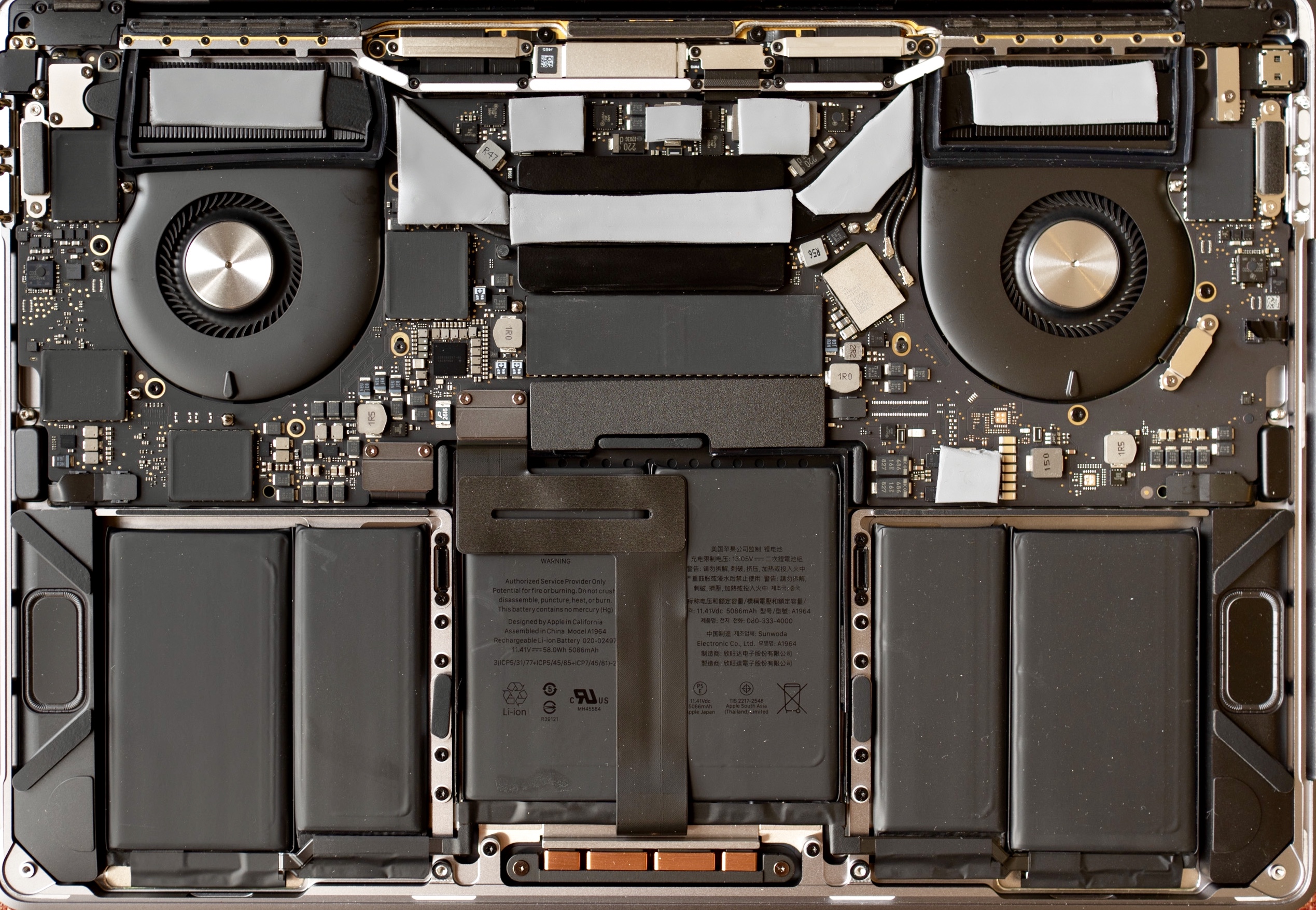

1. the speakers are the same
2. 2018 tb model have 2 fans , 2019 base model only have 1 fan so 2018 tb model wins.

It’s even more shocking that the 1.4 chip with single fan runs cooler than the 2.3 with dual fans.

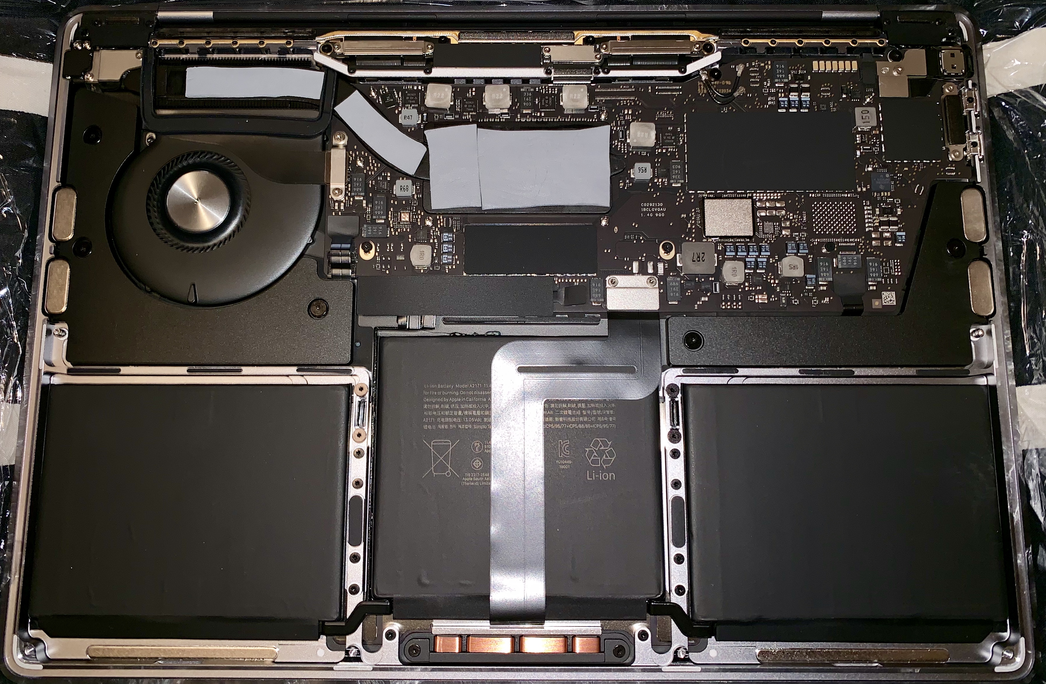

You can actually increase performance by doing this Mod (1-2mm thermal pads on the heatsink - will NOT void warranty):
Or like this....:

I actually think that the 1.4-3.9Ghz (i5 8257U) chip is a highly binned version of the 2.3-3.8Ghz (i5 8259U) chip running at extremely low voltages.

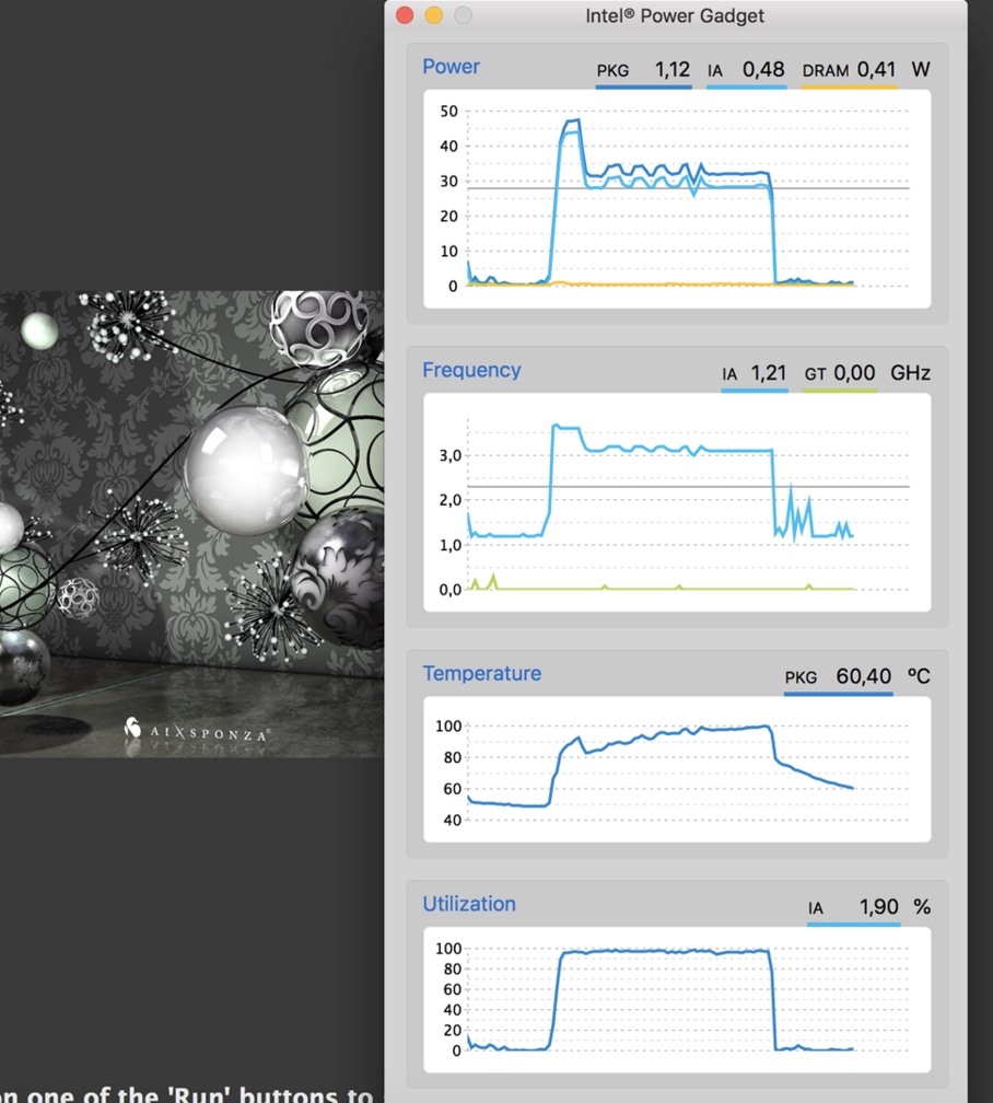

I own both 1.4 and 2.3 😀
1.4:
Max temp 1 run R15 result in 97C, but takes time to get there. Idle = 43C
2.3:
Temps instantly fly to 96C and top out at 100C. Idle = 50C
Running R15 for 15 mins on both machines result in 94C for the 1.4Ghz and 98-100C on the 2.3.
