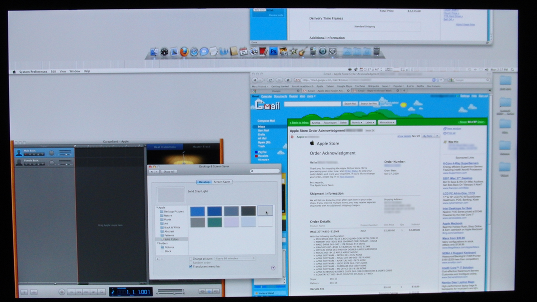

Hi guys, purchased my Imac 27" last tuesday, I am in the military so I do not have time to go to apple each day and complain, it's my first replacement due to a yellow screen and dead pixels in the isight, I have noticed that this new replacement once you let the computer on around 1 to 2 hours you start noticing the warm colors on the bottom half of the screen.
I just open Google's home page and start moving the window up and down and I can tell the difference, my question to everybody here on the forum is, if we are having this issues with this product, should we wait until the new iMacs arrive or what should I do because I do not have time and patience due to my work, because if I go to the store they will replace it but, I'll probably have the same issue again, and the apple "genius" told me I have 14 days to return or exchange the iMac after the day I purchased.
HELP anyone?

I have just today received my replacement iMac 27" i7 because the first one had the yellow tint issue. I am sorry to report that my new machine also has the issue although it isn't as bad as on my first machine, in fact it isn't very noticeable at all, all the same it still exists.
The first machine was a week 48 and this one is a week 51. I am disappointed that I still have what I consider to be a faulty machine but am unsure what to do about it now? Should I put up with it until the issue has been recognised and addressed and then contact Apple support again to organise a replacement?

Just got my replacement
Just received my replacement (wk 51, Shanghai, China), and this one is worse! It has even more pronounce yellow than my current display. I don't see how anyone couldn't notice it.
Looks like I'll be calling Apple fore either another one, or if they will allow a later replacement when it's all taken care of. Let's hope this issue is seriously addressed.
Just received my replacement, and this one is worse! It has even more pronounce yellow than my current display. I don't see how anyone couldn't notice it.

Week 47, 27" Core 2 Duo, slight yellow tinge at the bottom, although almost invisible when doing regular work on the Mac.
It doesn't really bother me that much to be honest. You're not comparing two grey bars all day normally are you? However, if it does become worse I will send it in for a repair, or if something ever goes wrong on this Mac, and it needs a repair, I'll tell the guys at the store to fix the tinge too (I hope they do come up with a fix soon though).
If they come up with a fix before the end of the holidays I might send it back in, but I don't want a replacement, seeing I've already migrated everything from my PC and don't wanna go through all that again.
I can miss my computer for a few days anyway. All I need is my iPhone and one of the laptops I have lying around here for work.
Now that I start looking at it, the tinge really goes halfway across the screen. Might wanna send it in a little sooner then.
But I'm really wondering if there is no way to calibrate this tinge or something. Must be possible (but I'm not a developer or anything, so I don't really know...)
