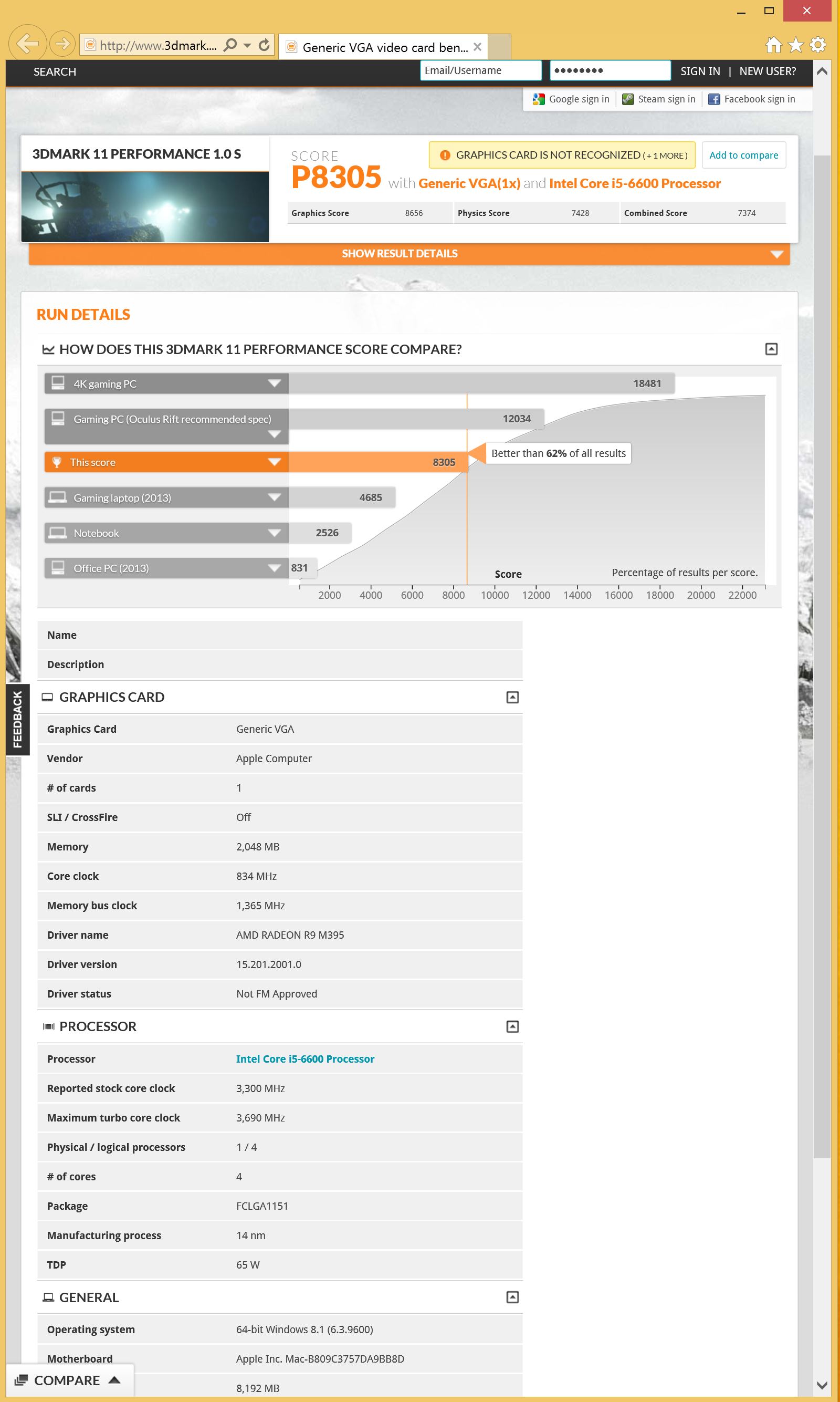

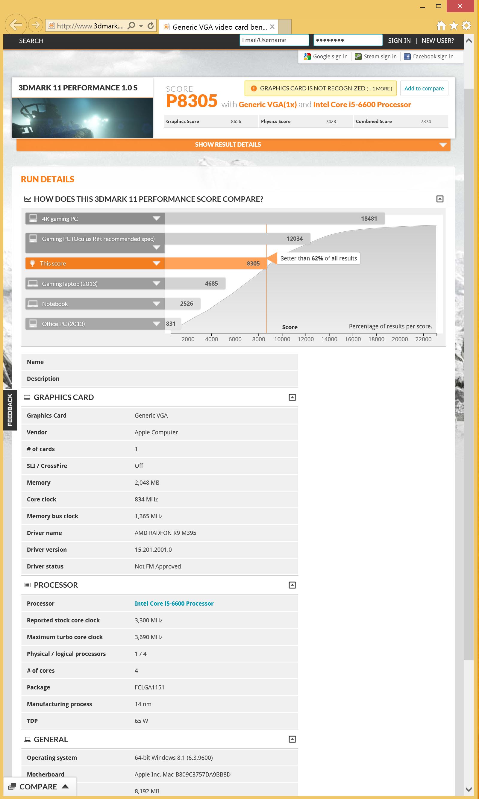

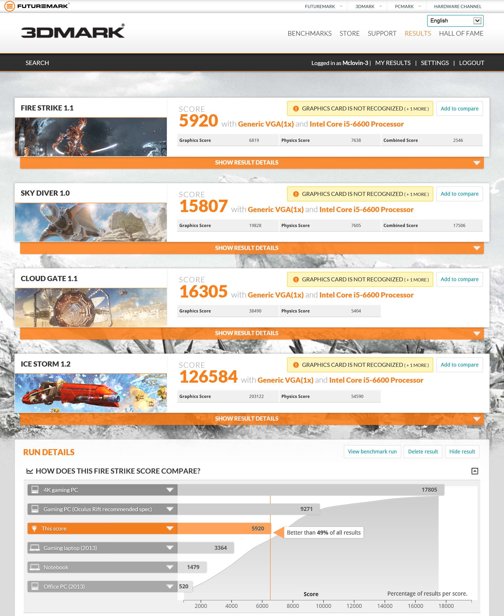

3dmark11 default run scored: 8305 which is a bit lower than I was expecting. It was only pulling 140-150 from the wall and there was no fan noise so I am hoping there is plenty of overclocking headroom 3dmark11.JPG

can be differences in the result between same dGPU but with i5 and i7 versions?
also i notice that is a difference of 3 fps between windowed and full screen

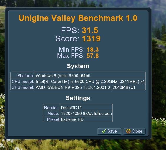

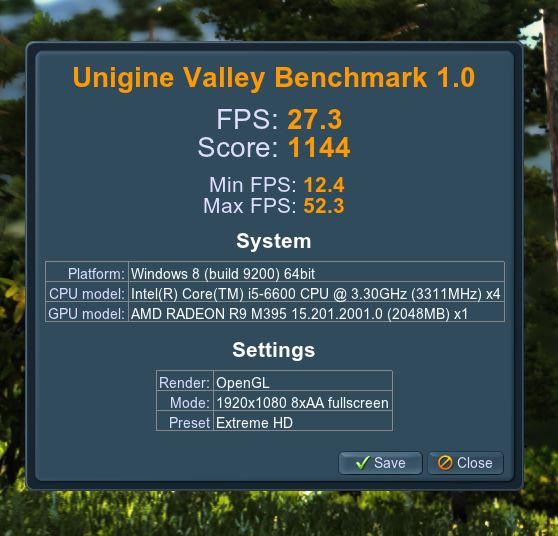

Thank you. It would be interesting to have a direct comparison for TopGunn's Unigine benchmark of:
Render: BOTH openGL and Direct3D11
Mode: 1920x1080 8xAA fullscreen
Preset: Extreme HD
Preset: Extreme HD
Yep, will run that shortly. Then I will do a few steam game benchmarks and if I get time I will play with drivers and overclocking

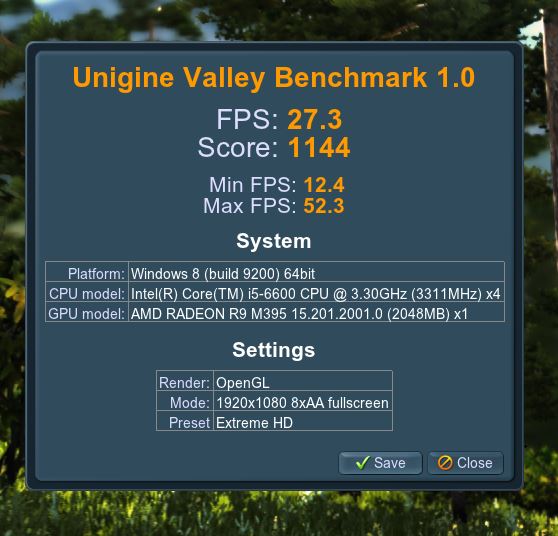

Your OpenGL score in Windows is comparable to my results in Mac OS with the difference likely due to driver maturity. Its a shame. The M395 is behaving like the M295X.
