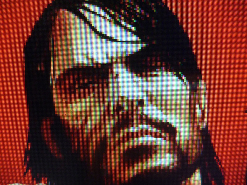

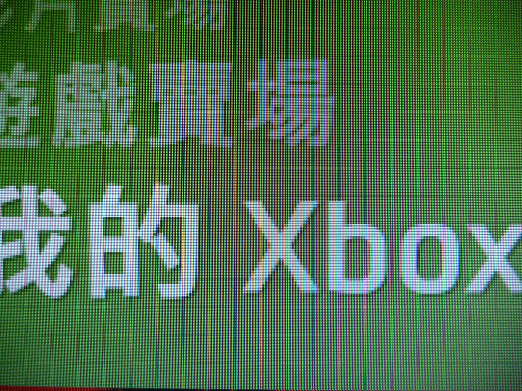

Basically here's what I understand from all the reading and googling pictures. Hope it will help people to decide in which to purchase. But, please correct me if I am wrong. 🙂
Belkin / Dr. Bott / Kanex= Simply HDCP pass-through interface for HDCP devices to work on external monitors. Therefore, since iMac, as a monitor, only takes 720P or 2560x1440, so unless these interfaces support up to 2560x1440 and your source is also 2560x1440 (which is unlikely), it will only show 720P on the iMac screen. This results in pixels when one look up close at the iMac screen.
Pros: simple connection, audio get sent to iMac (stereo), space saving, cheaper
Cons: will see pixels when up close since it's 720P on a 2560x1440 display
Close-up actual pictures from the type of devices above:
