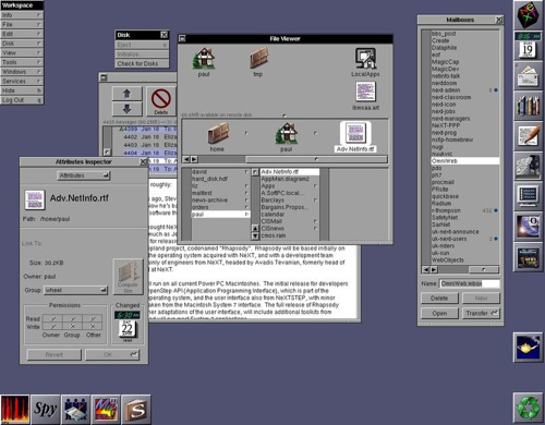

NextStep, from which Apple developed OS X, had the menu bars attached the main window of each app, as it should be. This was carried over in the early betas of OS X, but the Mac fanboys screamed bloody murder and Apple went back to global menus. 🙁 😕 😡
No, this was never true. NeXTSTEP (and OPENSTEP for Mach) always had a global menu bar - it was just normally vertically oriented in the upper left corner:

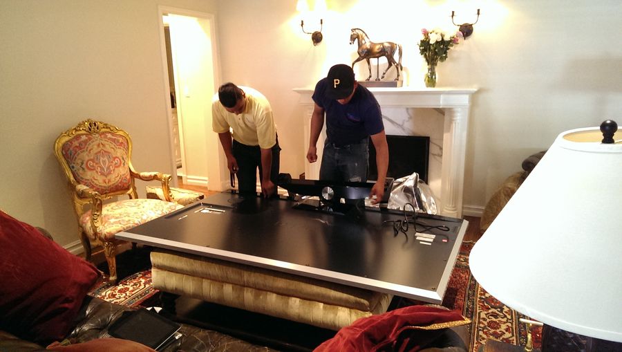

Bought the LG 84 inch 4K TV today.
Will be going through this thread slowly to get my 4K display to output video!

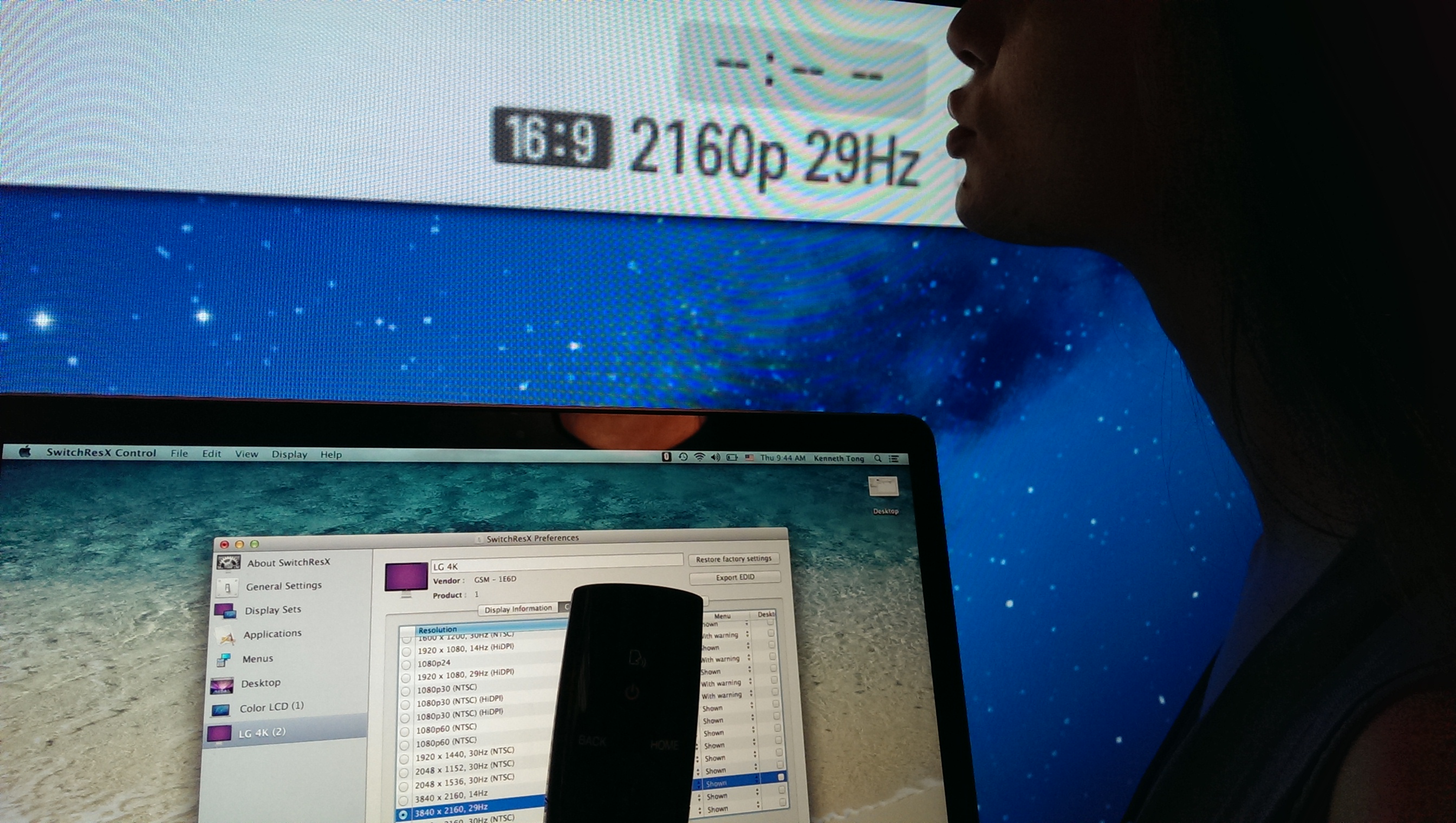

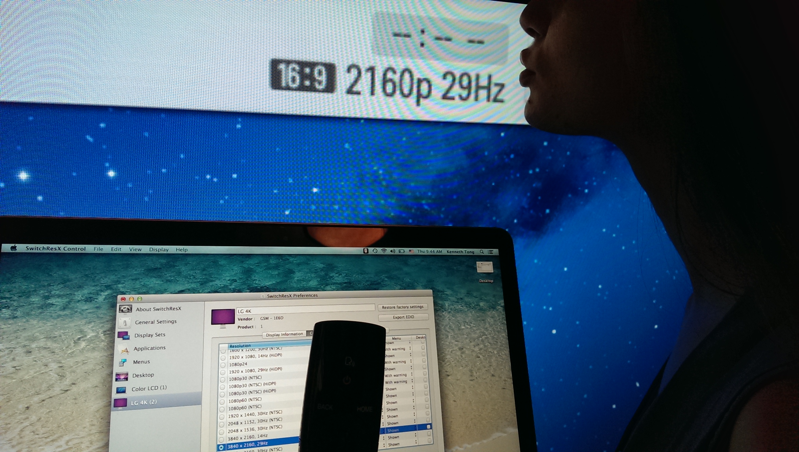

😀 We have a guinea pig! My friend works at Best Buy so I'm trying to get my rMBP in for some fun and briefly played with the Sony 4K display (the $5999~ model) but they wouldn't let me hook it up without my buddy there. When you test it out be sure to test out different resolutions, refresh rates, etc. and if you could post pictures that'd be a great contribution to the thread 😀 😀 I think the Sony comes with a proprietary media player that only works with Sony's but aside from YouTube and the RED Ray player anyone know where to get movies in 4K? I have a ton of 4K and 5K samples from RED Epic's and such but no full length movies (other than my own stuff which isn't exactly action packed).

Ordered the adapter as mentioned, hopefully it is all just plug and play, I hate looking at SwitchResX.
Nice! Saw the picture too. That's gonna be beautiful. And yeah SwitchResX is sort of a pain but its useful. I just wish OS X offered advanced resolution options, I mean Jesus I can't even select a refresh rate for my TV without SwitchResX! When I first got checked the resolution settings on my rMBP I was sort of upset to not see regular resolution settings but got used to that being dumbed down, I just hope in the future I won't need SwitchResX, its a great little program though.
