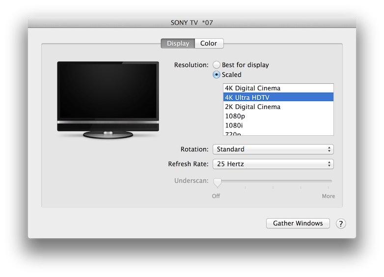

4K support under Mavericks on my 2012 rMBP:
Oh now those options (ableit capped at 30Hz for Ultra HD and 24Hz for 4K DCI) are making me excited! Honestly I don't expect to need 4K at over 24Hz anytime soon as since movies are 24fps, I can see wanting 48fps+ for general use and gaming though. Still hesitating to jump on Mavericks but this is convincing!

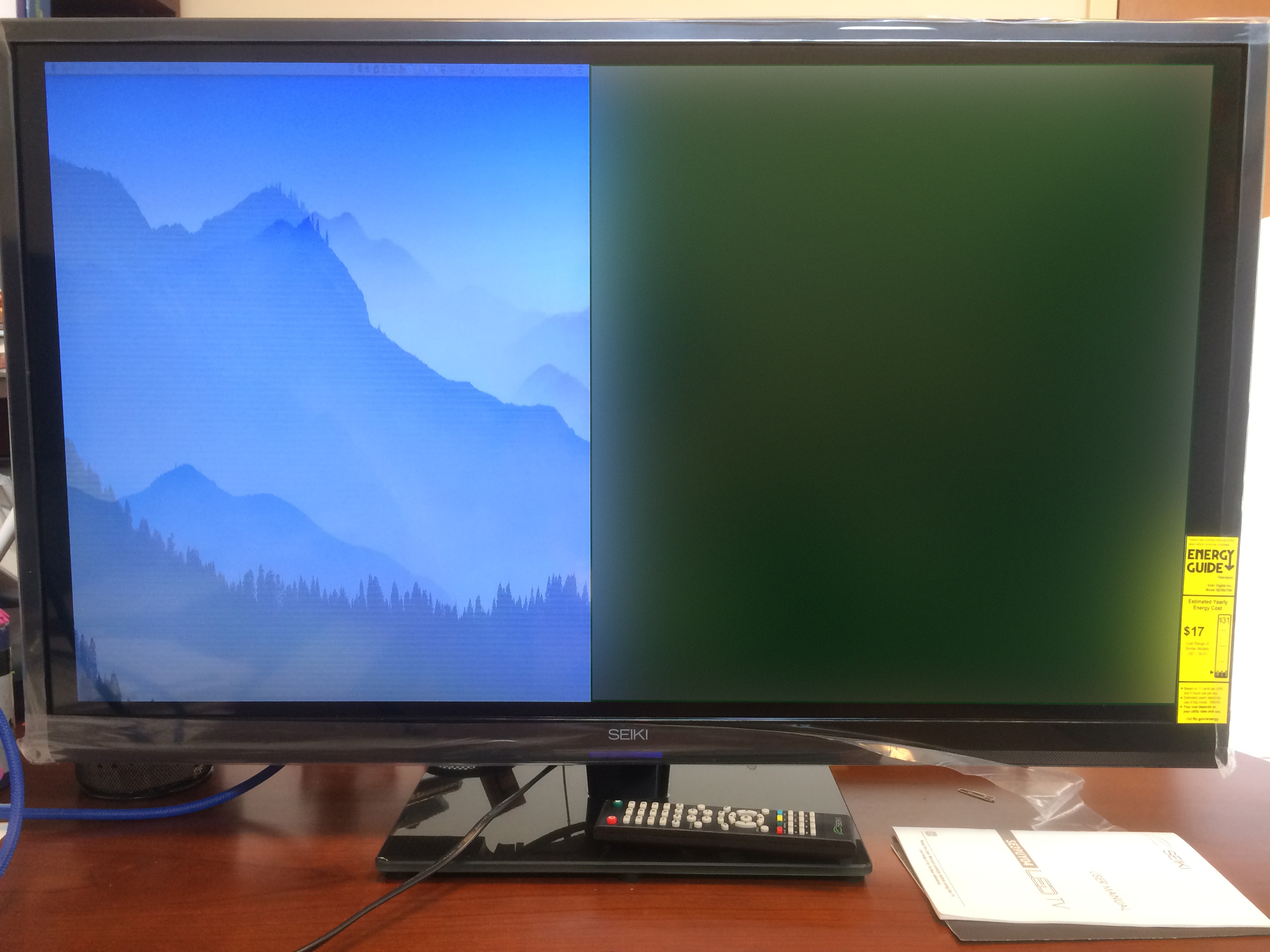

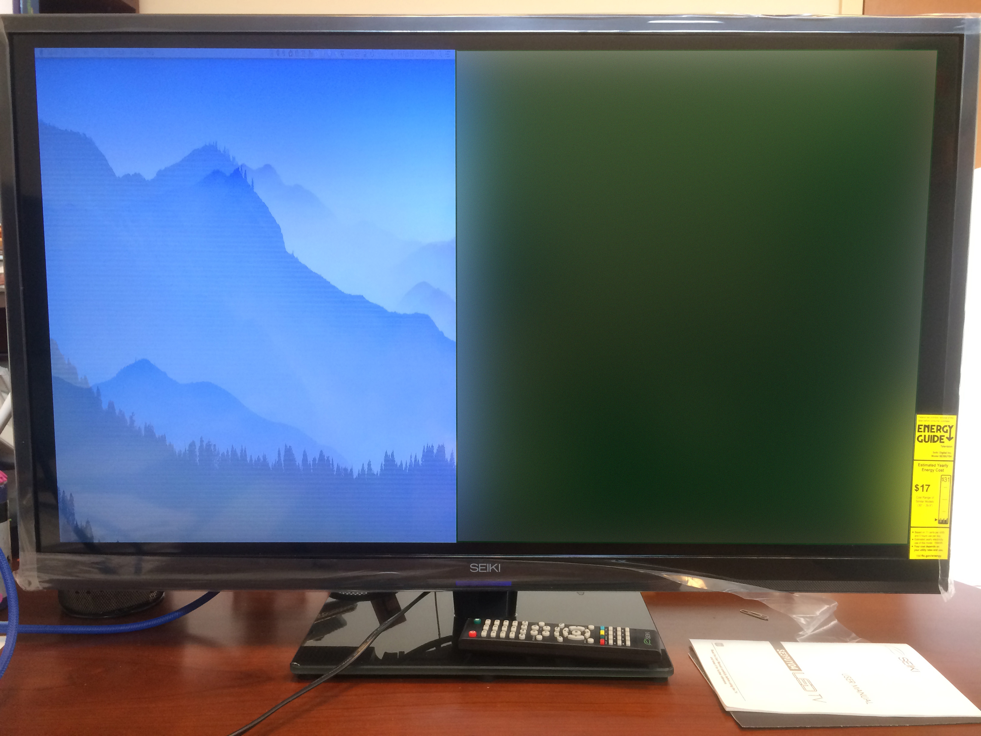

Results with rMBP 13 Late 2012
I have had no luck with the following configuration:
MacBook Pro Retina 13 inch, Late 2012
2.9 GHz Intel Core i7
8 GB 1600 MHz DDR3
Intel HD Graphics 4000 1024 MB
OSX 10.9.2 (Mavericks)
SwitchResX 4.3.6
Seiki 4K 39" UHDTV (Flashed with firmware for 50" SE50UY04_20130528)
Accell UltraAV Mini DisplayPort 1.1 to HDMI Active Adapter (compliant to HDMI 1.4b)
Notes:
1. Trying to drive display at 3840x2160 @30 Hz, but cannot even get it at much lower refresh rates (e.g. 16 Hz)
2. Initially tried it with OSX 10.8.5, SwitchResX, and overclocking patch (https://code.google.com/p/mac-pixel-clock-patch/wiki/Documentation) -- no luck with or without the patch
3. Then uninstalled SwitchResX and overclocking patch and upgraded to OSX 10.9.2 -- no luck. Maximum resolution that shows up under standard Display control panel is 1080p. Reinstalled SwitchResX -- no luck.
4. The same results are produced regardless of using the HDMI port vs. the Thunderbolt port with the MiniDP to HDMI adapter
5. With SwitchResX, the maximum resolution I can get to display correctly is 2048x1536 @16 Hz (upscaled -- the monitor thinks it is seeing 3840x2160 @16 Hz)
6. Interestingly, occasionally my FileVault unlock screen will appear at full resolution (3840x2160) correctly on the Seiki, but once logged in, it fails. It is hit or miss. The unlock screen also will appear at 1080p sometimes.
7. Here is what the display looks like when trying to drive at 3840x2160 @16 Hz (attached). The image fills up only less than half of the screen on the left side with a strange banding/wraparound pattern. However if I screen capture using Grab, it saves a normal looking 3840x2160 full screen, so that is what it thinks it is outputting. Attempting to drive at faster refresh rates gives nothing at all ("invalid").
8. This machine has no trouble driving a 27" iMac as an external display at 2560x1440 @120Hz (using a MiniDP cable), so the graphics output is much more capable than what is being produced when using the Seiki.
9. A friend with a late 2012 rMBP 15" running Mavericks plugged the HDMI cable into his HDMI port and it worked immediately at 3840x2160 @30Hz, no problem. Very frustrating!
I have run out of ideas of things to try. If anyone can help, it would be greatly appreciated.
UPDATE: The solution to fixing this particular half-screen corruption problem is to uninstall the pixel overclocking patch and SwitchResX, going to the Display Pref Pane, and turning OFF underscanning. Then reinstall the overclocking patch.
