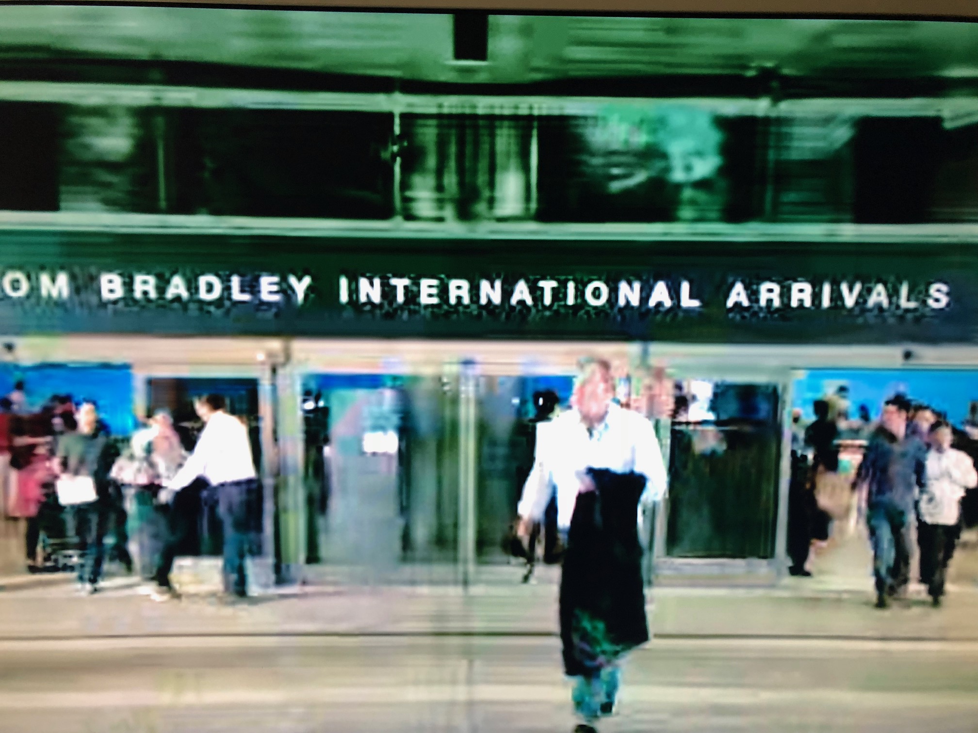

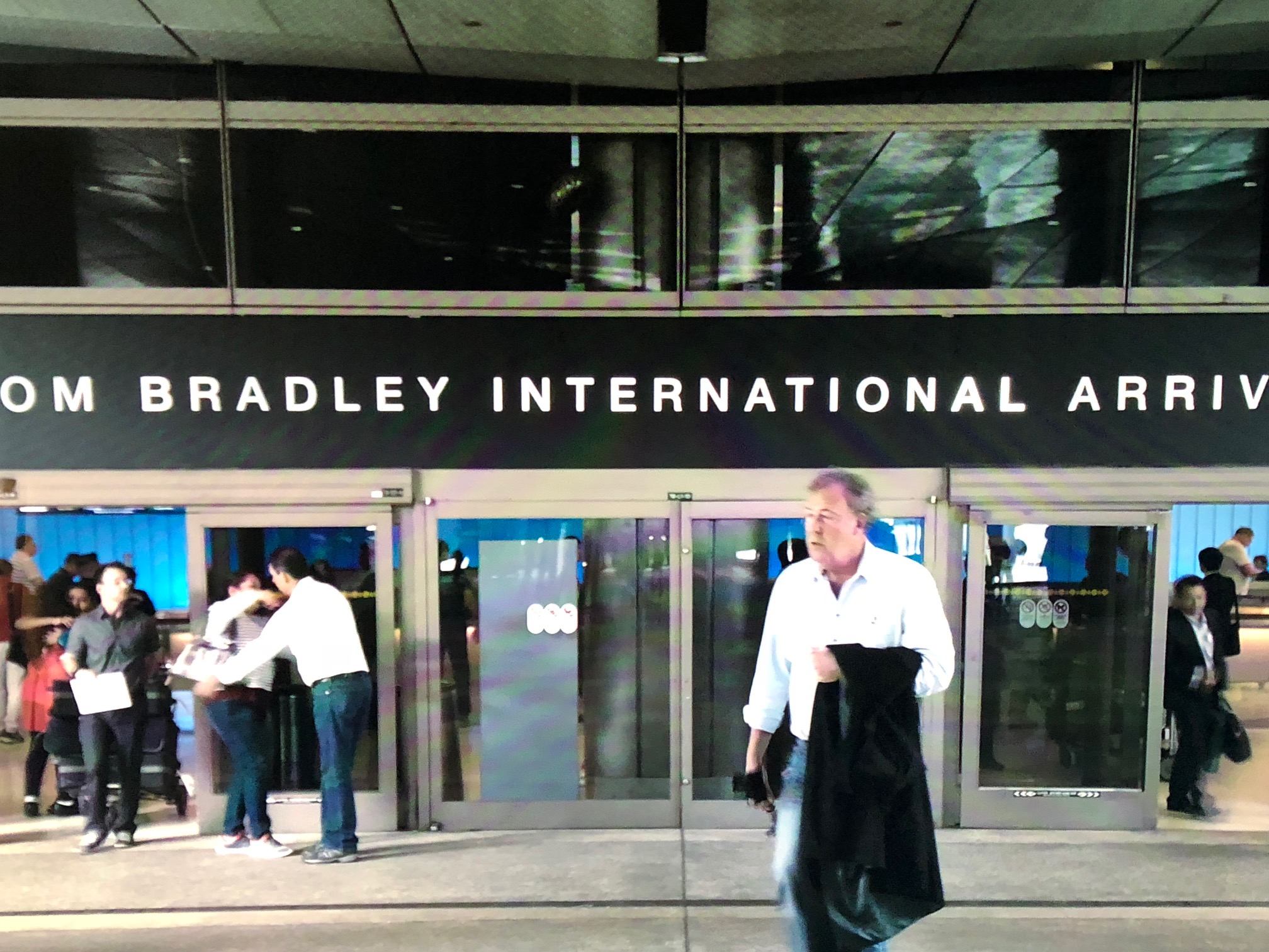

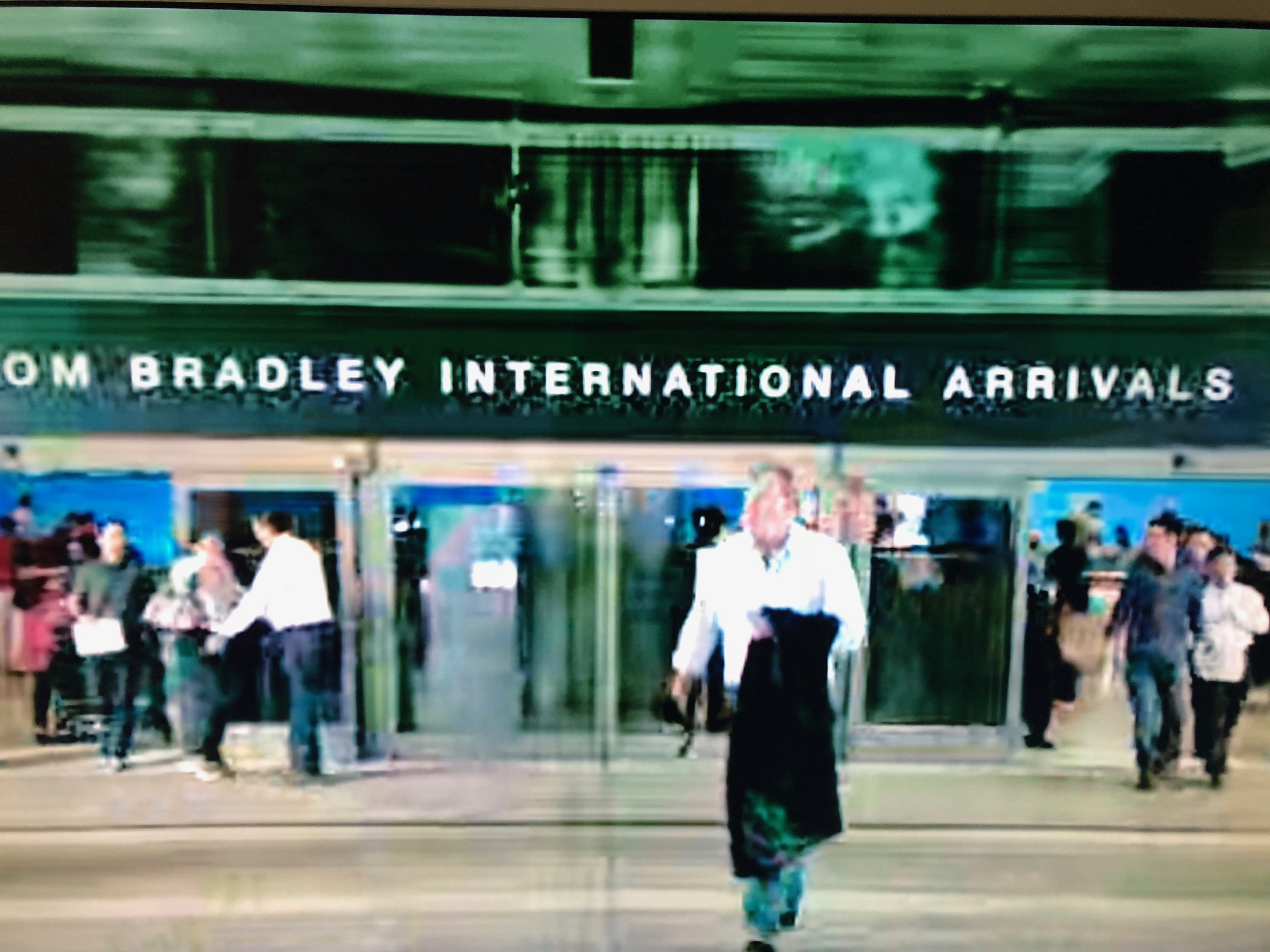

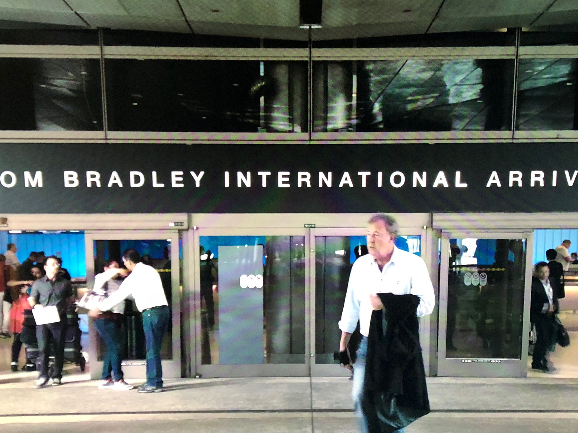

To show how awful the ATV streaming has been, the first photo is the ATV 4K streaming Amazon. It's incredibly blurry and pixelated, probably 240p on a 65 inch TV. Seconds later, I play the same scene on my Samsung Amazon app [see photo], the streaming got to 4k in just a few seconds. Speedtest.net at the moment showed 30/download.
This is beyond frustrating...View attachment 742327 View attachment 742328
