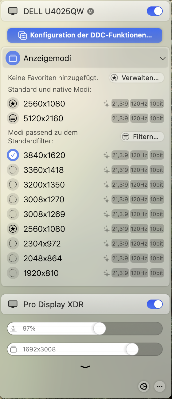

I have an M3 Ultra Mac Studio and the Dell U4025QW. I can run the display with a 3840x1620 HiDPI resolution at 120Hz without any problems. My notebook - a MacBook Pro M3 Max - can do it as well.

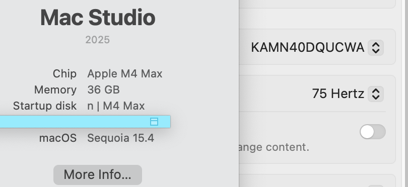

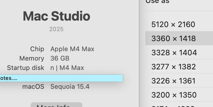

G'day. And, sorry: no.
FYI, 75 Hz panel:

The 27" iMacs were always 2560x1440, either native or in "default" HiDPI mode. So, being a "stretched" 27" 4K display the "ideal" HiDPI res for the LG 5k2k 34" is 3600x1440. The M4 pro can do 3360x1418, which is not quite there but *very* close. I like more room, so I'm not happy, but I find my LG 34" 5K2K usable even without resorting to BetterDisplay.
