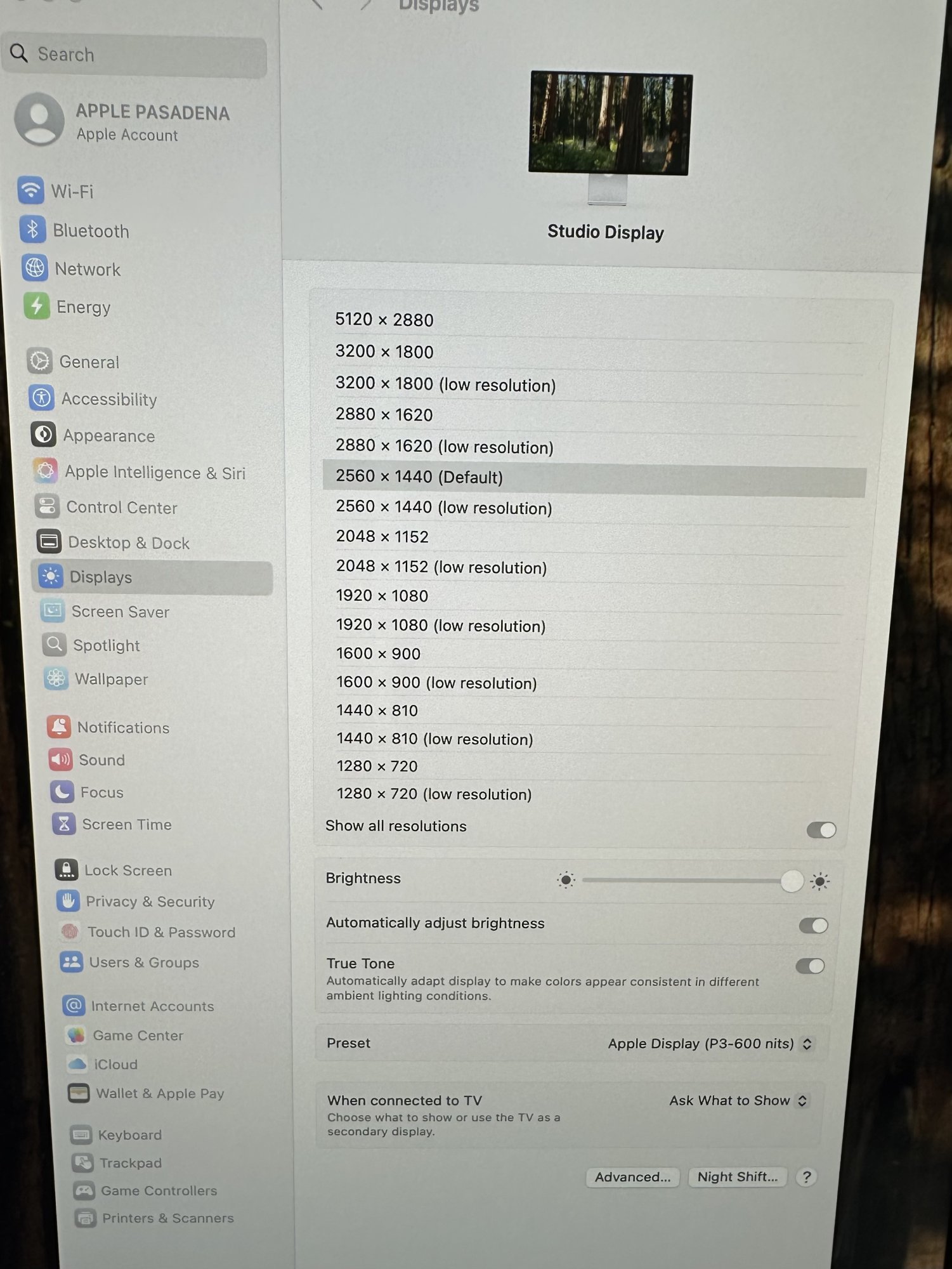

Can someone explain this to me?
I went to my local Apple Store and they had an M3 Ultra(!) Mac Studio connected to a Studio Display.
Obviously the Studio Display does full 5120x2880 5K. The default (scaled) resolution on the M3 Ultra was 2560x1440, HiDPI, which is 1:2 - half of the full resolution in each dimension. (See attachment.)
On our 5120x2160 5K2K Ultrawide 21:9 monitors the default (if it exists!) is 3840x1620, which is 3:4 - not 1:2 (2560x1080).
I’m curious why the Studio Display (which presumably does not suffer from the unsupported-on-M4 3840x1620 HiDPI issue - although that resolution doesn’t show up either) uses 1:2 as the default, not 3:4 (which would be 3840x2160 - UHD/“4K”).
Is this purely a function of full 5K vs. 5K2K? Are there any other monitors out there that do full 5120x2880 5K, which also default to 2560x1440 HiDPI when connected to a Mac?

I don't know. The EDID contains measurements for the display in millimeters or centimeters. Apple could use that in a DPI calculation.
The Studio Display maybe has a higher DPI so it uses 1:2 as the default.
The Ultrawide maybe has a lower DPI so it uses 3:4 as the default.
Alternative, Apple could decide that 1080 (half of 2160) is too low and choose the next higher number of vertical pixels.
I would check for any display override files and see if they have any preferences specified.
/System/Library/Displays/Contents/Resources/Overrides
I think all 16:9 5K displays default to 2560x1440 HiDPI (LG UltraFine 5K, Dell UP2715K, etc.)

@Riot Nrrrd "Are there any other monitors out there that do full 5120x2880 5K, which also default to 2560x1440 HiDPI when connected to a Mac?"
Since up to now all available 5K 16:9 monitors are 27", all 5K 16:9 monitors follow Apple's iMac 27" standardisation of a default HiDPI screen resolution of 2560x1440.
Since Apple standardises it's external monitor panels on 218dpi, I would guess @joevt's suggestion that if a monitor's dpi is lower, then a different default scaling will be chosen?
Especially since 5K 21:9 monitors are essentially one-and-a-half 4K panels joined side-by-side, so lower pixel density.
This is likely defined somewhere in Apple's internal code.
You can use BetterDisplay to define the default scaled resolution for any display.
The Apple displays might have special handling in their code too which is why they tend to work seamlessly. But even they are subject to the same 8K framebuffer limitations for scaled resolutions. Both the 5K and 6K displays just skirt under these limitations with the scaled resolutions they offer.
The 3840x1620 HiDPI resolution = 7680x3240 render resolution going missing on specific displays is some weird bug in Apple's code. I fully expect behind the scenes it has a bunch of weird hacks going on for its display support.
