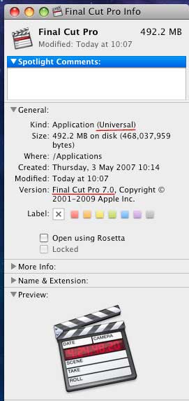

But having just purchased FCS3 for my Intel machine, I discovered according to the 'Get Info' tab, Final Cut 7 and all the other FCS3 apps are 'Universal'.
Screenshot here:

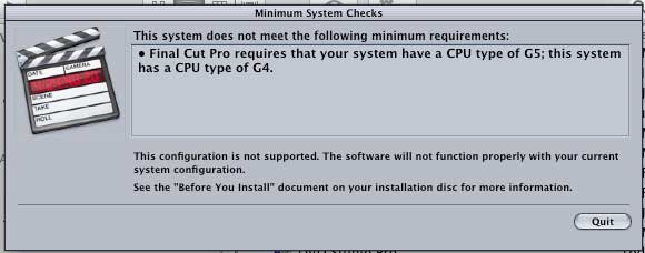

I loaded up FCP using 'Rosetta' and it said that FCP7 requires a G5 processor, and you have a G4. Don't know why it said that, but it seems to suggest FCP7 will work on a G5.
Again screenshot here:
