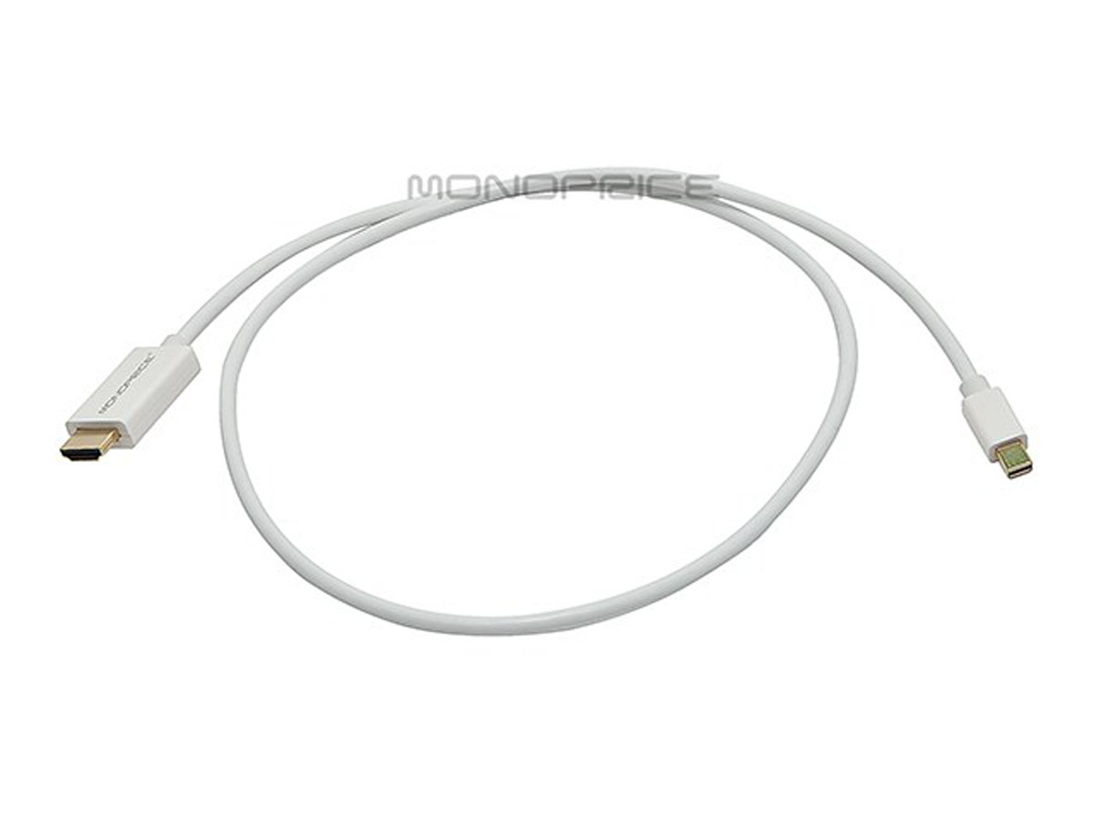

Also, has anyone tried these cables yet?
(clickable)
MonoPrice does not have a disclaimer saying it won't work with audio, like they do with the adapter linked by OP.
(clickable)
I have tried this and it does not work. When I emailed customer support, I was told, "I apologize for the inconvenience, but our cables are 1.1 VESA compliant and do not support audio. You need a 1.2 VESA compliant cable in order to pass audio. We currently do not carry any 1.2 VESA compliant cables. Thank you."
