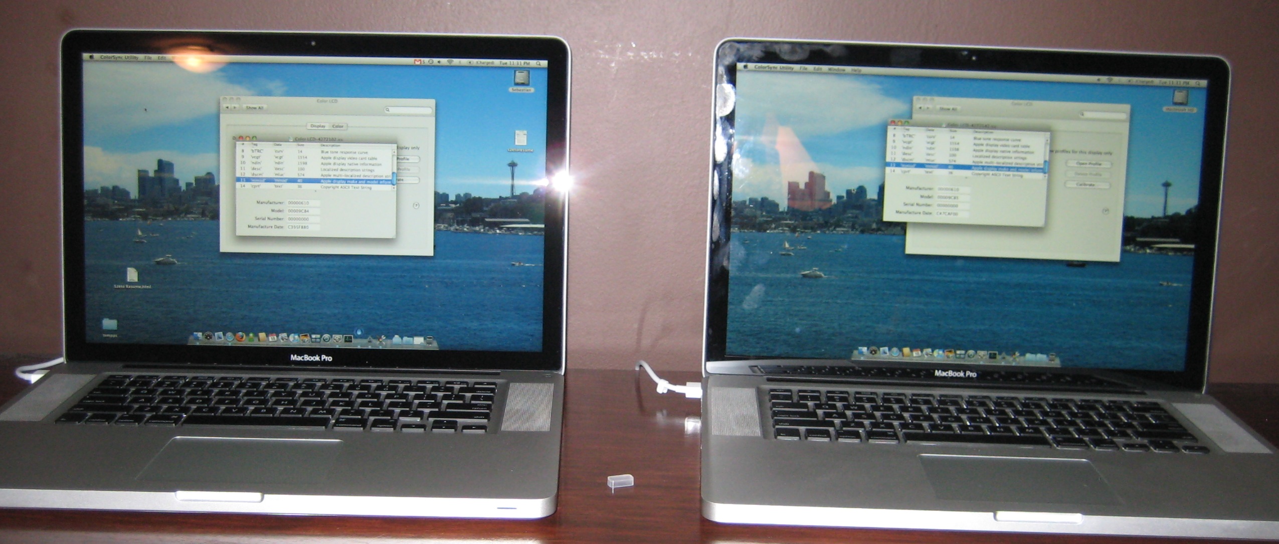

My first MBP was one with a 9C85 display. For unrelated issues, I got a replacement, which happened to have the 9C84 panel. I calibrated both screens to the same, and brightness levels were also set to the same (3 notches down from max). In person, there was a huge difference. The 9C85 had a yellowish tint that I didn't realize existed until I had the 9C84 right next to it. The white is much whiter on the 9C84. BUUUUUT, I would have been happy with the 9C85 because it already appeared to be so vivid in colour.
I snapped a photo of both side-by-side (9C84 on left, 9C85 on right)... sorry for my smudge marks on the one on the right... they were just around the left edge as I grab on to the side to adjust the angle every so often.
I snapped a photo of both side-by-side... sorry for my smudge marks on the one on the right... they were just around the left edge as I grab on to the side to adjust the angle every so often.
so which one is which on that pic? and i cant tell a big difference from that pic.
left 9c84, right 9c85 - if he described it correctly. There is a fairly significant difference looking at that picture.

I concur... the 85 I had on its own was brilliant, UNTIL the 84 was next to it, then the 84 was less bright (even on highest bright setting) and a bit more yellow (see enlarged photo I attached above).
