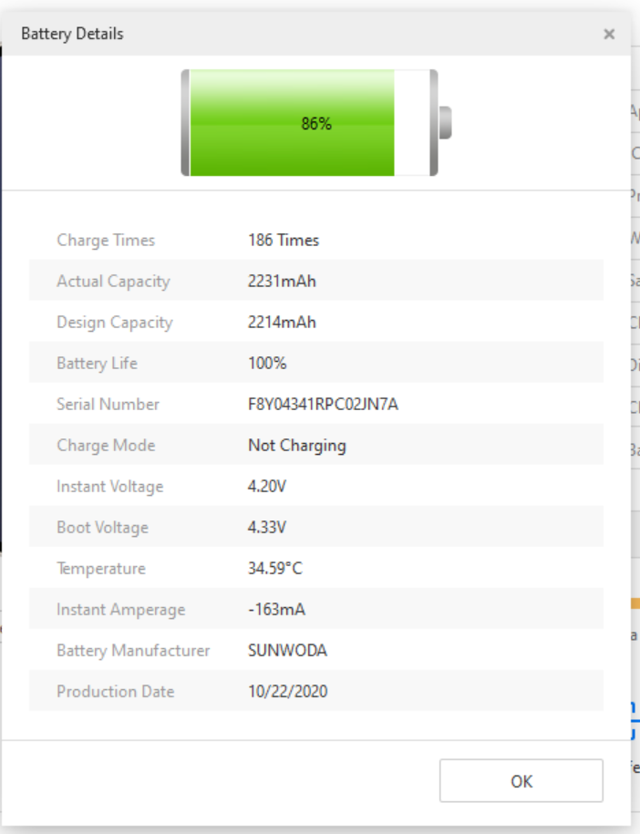

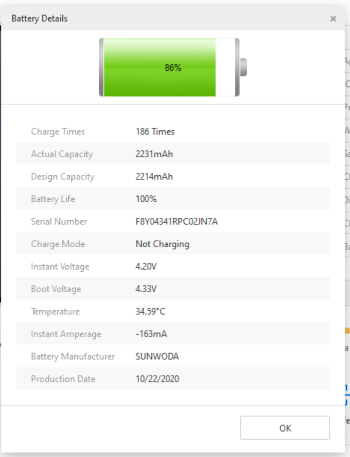

I have a 12 mini from launch day. Out of curiosity, I plugged it into 3uTools. Interesting...

I have a 12 mini from launch day. Out of curiosity, I plugged it into 3uTools. Interesting... View attachment 1774720

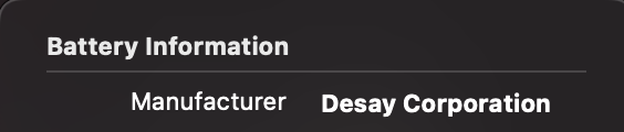

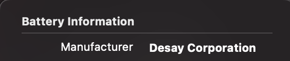

I noticed that Apple uses either Sunwoda or Desay Corporation (I have the 12 Pro Max and Apple uses both) and I've noticed that from my experience, Sunwoda tends to not that great, battery tends to degrade. However the 12 PM that I have has the battery manufactured from Desay Corporation and it still standing strong since launch day and still over 100%. I can't speak of others but that's just what I noticed on mine.
how do you know what manufacturer your battery is from?

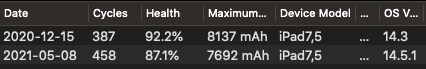

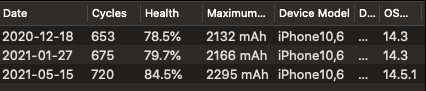

(To everyone). Do you want to know/see how accurate/helpful these battery utility numbers are?
Using the latest version of coconutBattery:
I’m certain the most recent was when the iPhone battery meter said 100% — so 95%+. I don’t recall at what charge level the other two were checked at.

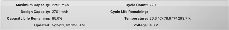

With the latest version of TechTool Pro:
Interestingly, iOS concludes the battery health at 85%.
More info about the iPhone:
• Launch day iPhone X - received Nov. 4, 2017 - manufactured Oct. 23, 2017
