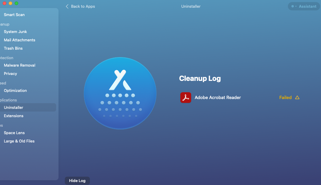

Thanks for helping. I downloaded CMM and got the free trial. However:
This is getting weirder 🙁
